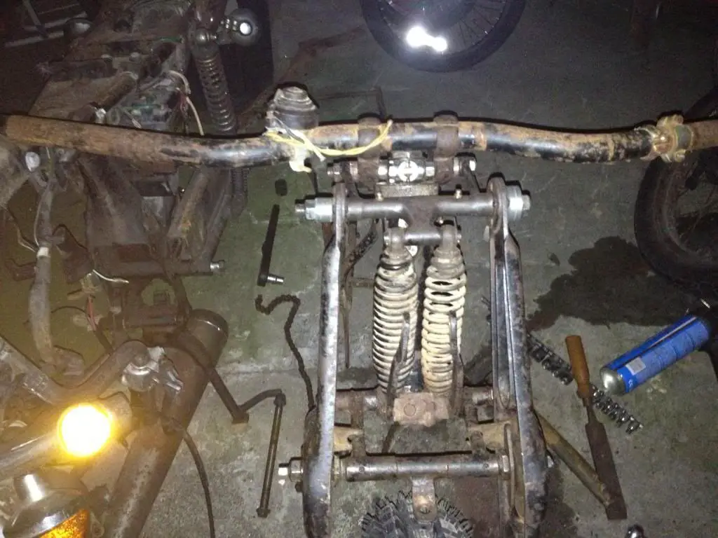

This girder front end is driving me bonkers !

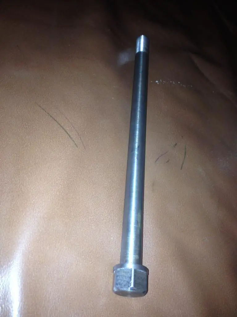

To cut a long explanation short- its worn out, Its not beyond repair though but I have got to alter it a bit by drilling out the original linc threads, the linkage bolts have huge wear points on them and try as i might I could not get them to re-screw into the fork sides on the top linkage so I've had to completely drill it out and by good luck the CG spindle is also the same size and fits perfectly I just have to cut and re-thread the end and machine some grease points into it and the jobs a goodun, I'll have to do the same to the bottom one before it goes on the road and where it bolts onto the headstock also needs machining and thinwall bush's inserting.

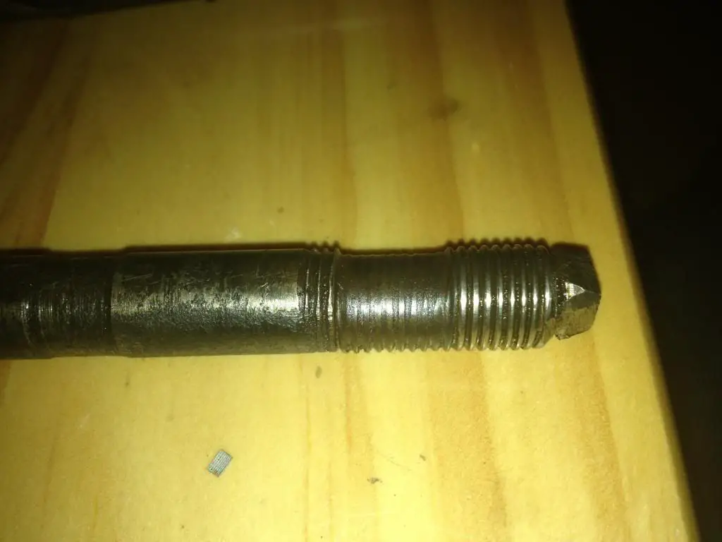

Heres a pic of the worn top bolt.

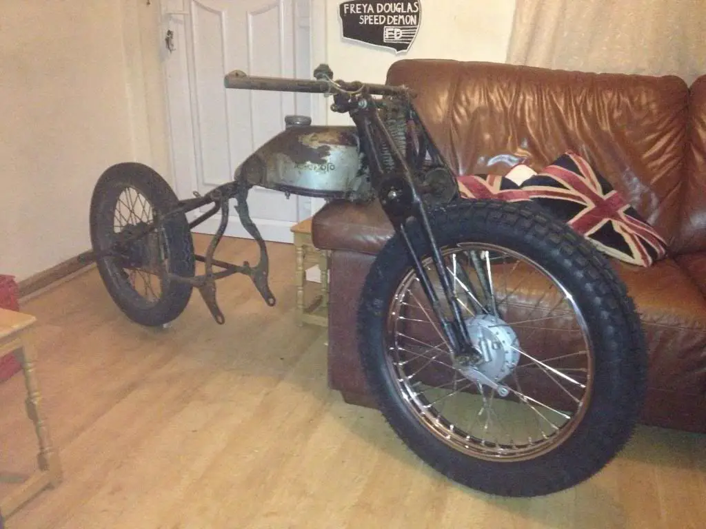

I couldnt resist chucking it together a bit to see what it looks like :)

I've orded a 12mm x 1.25 pitch die to make the top yoke spindle fit as its a bit long, but to make it work for now I've machined up some spaces to see if it all works..and it does so the next job is to find some more alloy for the rear wheel spaces, then I can get the rear wheel centred.

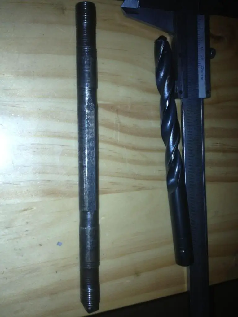

I bought some more supplies to get me moving again this week, a big lump of alloy for the rear wheel spaces which are now done, a 12 mm 1.25 pitch die an die holder for shortening the thread on the girder forks top spinndle, a cheapo drill stand and vice an a load of big drill bits.
I ran down to Manworld to drill out the 12mm front wheel spindle but its a 30 mile round trip so for the poxy little jobs the drill stand will come in handy, I'm not used to setting it up yet though because the first two spindles were...a bit wonky, there ok though, he's a vid of me drilling out genuine off center holes. It'll be good having it on wheels proper for a change, It'll certanly make it easier for the Mrs to move it into the yard when shes cleaning up

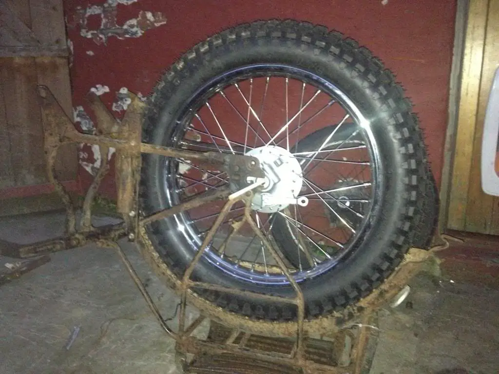

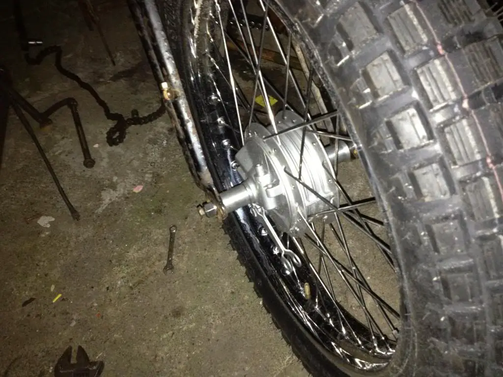

I went off to the wheel builder again today and ordered the back rim, I'm going for the stainless set up again from Hagons cos they where really quick last time, I sprayed up the hub an brake plate with Halfords silver wheel trim paint an gave it a coat of matt lacquer, I'll cut the rust of the mudguard an bolt it up proper next.

I've had the rear wheel rebuilt like the front with a stainless rim an spokes, but the rear wheel crush spacer was missing, it was cheap enough at £3 so I didnt try an make one for that but by the time it got here ages have gone by an the vat an carrage took it to £7.... I hate momentum stopping moments like that though !
