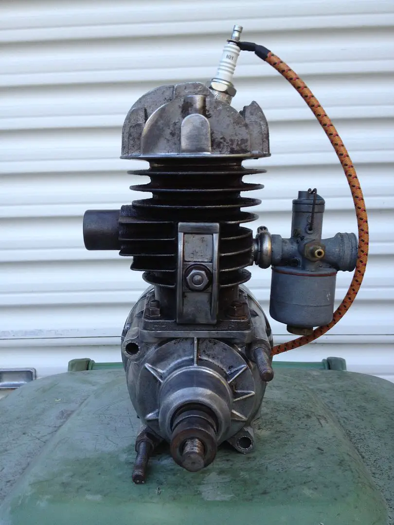

Ive been walking past a number of even older Victa engines ive bought in lawnmowers, today i had to just pull one out to play with it. I have 2 newer 160cc engines and four older ones all a little different. They come in 125cc and 160cc versions. Not sure which one this is. Im going to rebuild this engine but couldnt help bolting it back together to see what it looks like once i made a few modifications. I really like it, and it owes me next to nothing.

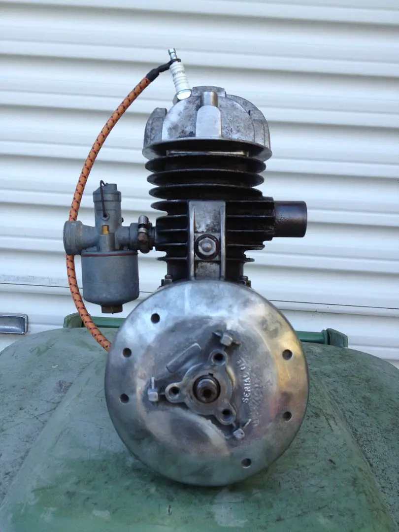

I cleaned up the engine, i still wish to either polish or sodablast the bottom casings. I cut off the mowerplate to make it look a lot more like a motorcycle engine.

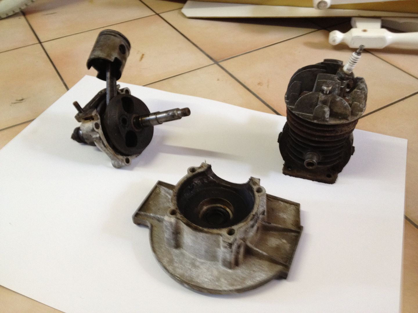

Heres the motor apart and notice the large plate section i removed.

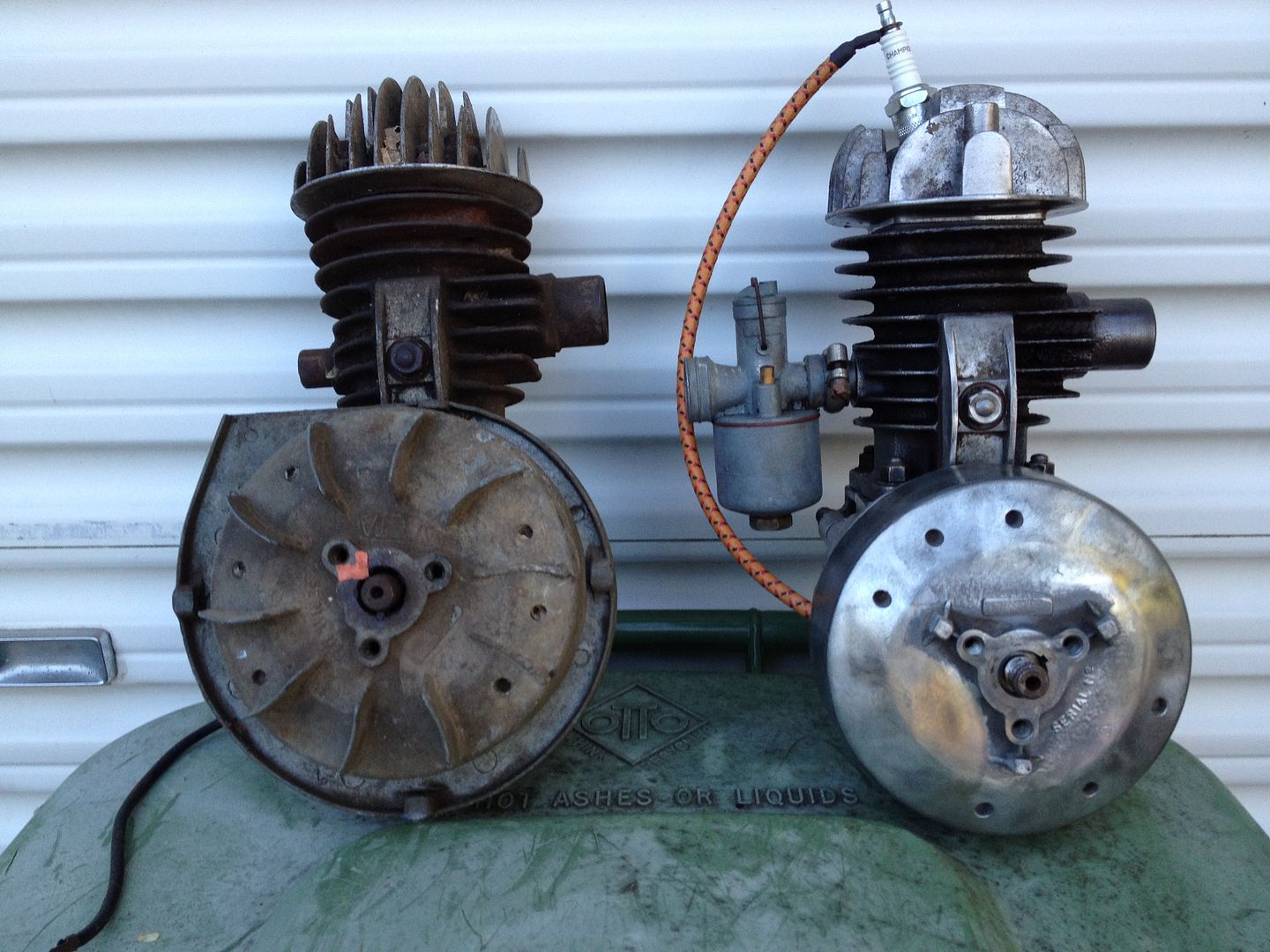

Heres the motor parlty cleaned, still need to blast or polish alloy casings and repaint the barrell. I removed the fins on the flywheel, modified lower casings, turned head 90 degrees, replaced ignition lead with cloth covered one.
I forgot to take before pics but its almost identical to this other engine i have.

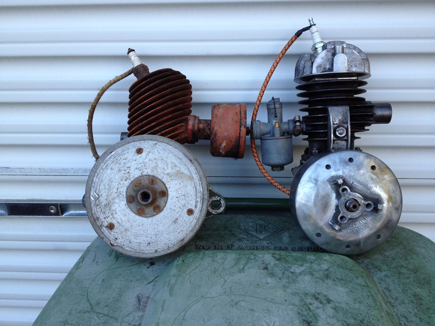

Heres a size comparison to a 98cc Villiers.

Ive also got other motors, and an electronic ignition for it, so im going to to cut down the crank and do away with the flywheel for a much slimmer motor.

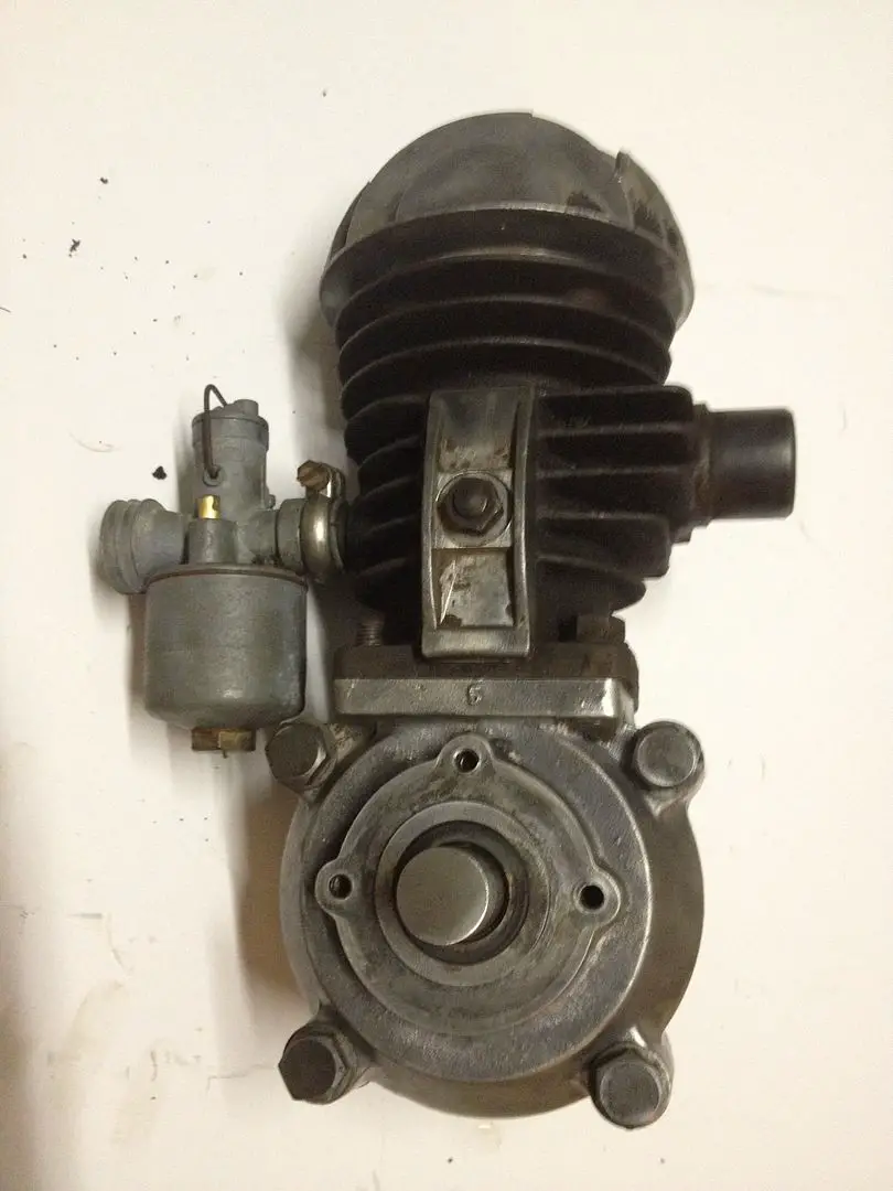

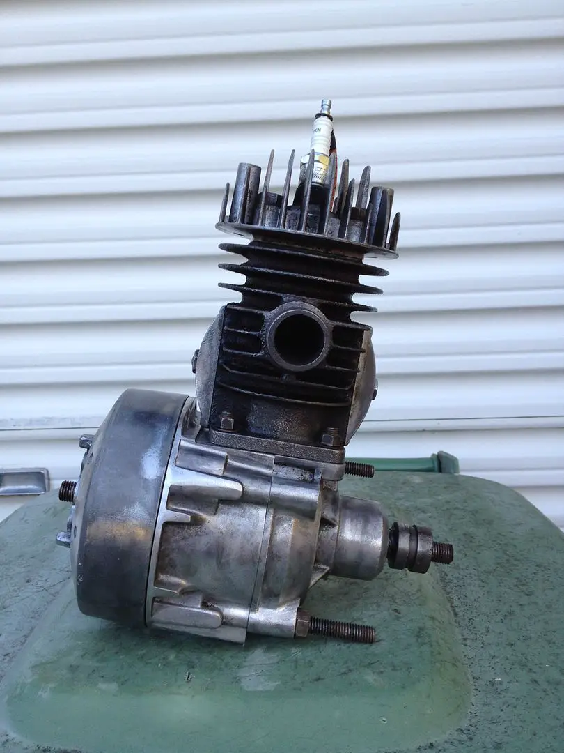

I played around with the other motor today in the hope of making a thinner engine. The motor owes me nothing so if this doesnt work out no harm done. Im no mechanic so if anyone sees anything ive done wrong feel free to let me know, may save me valuable time.

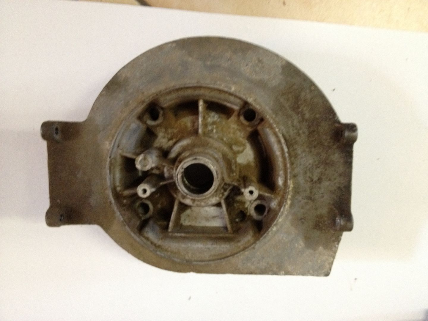

On this motor the flywheel plate unbolts, i removed the flywheel as i have electronic ignition for this engine, so ill be able to cut the crank down even further. I would need to make a small faux ignition cover.

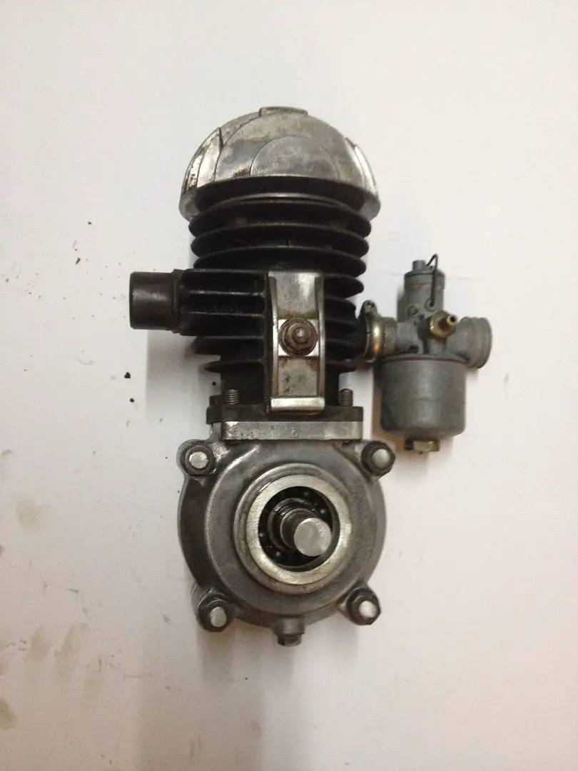

On the drive side of the engine i cut down the casing making it thinner. I will just need to get a keyway milled in the crank for a sprocket or pulley.

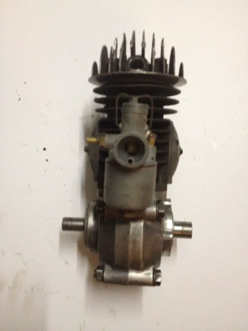

Flywheel removed, need to install electronic ignition, cut down crank to suit and make faux magneto cover.
Drive side with casing cut down. Need to find a seal to suit and fit. Keyway needs to be milled to this side.

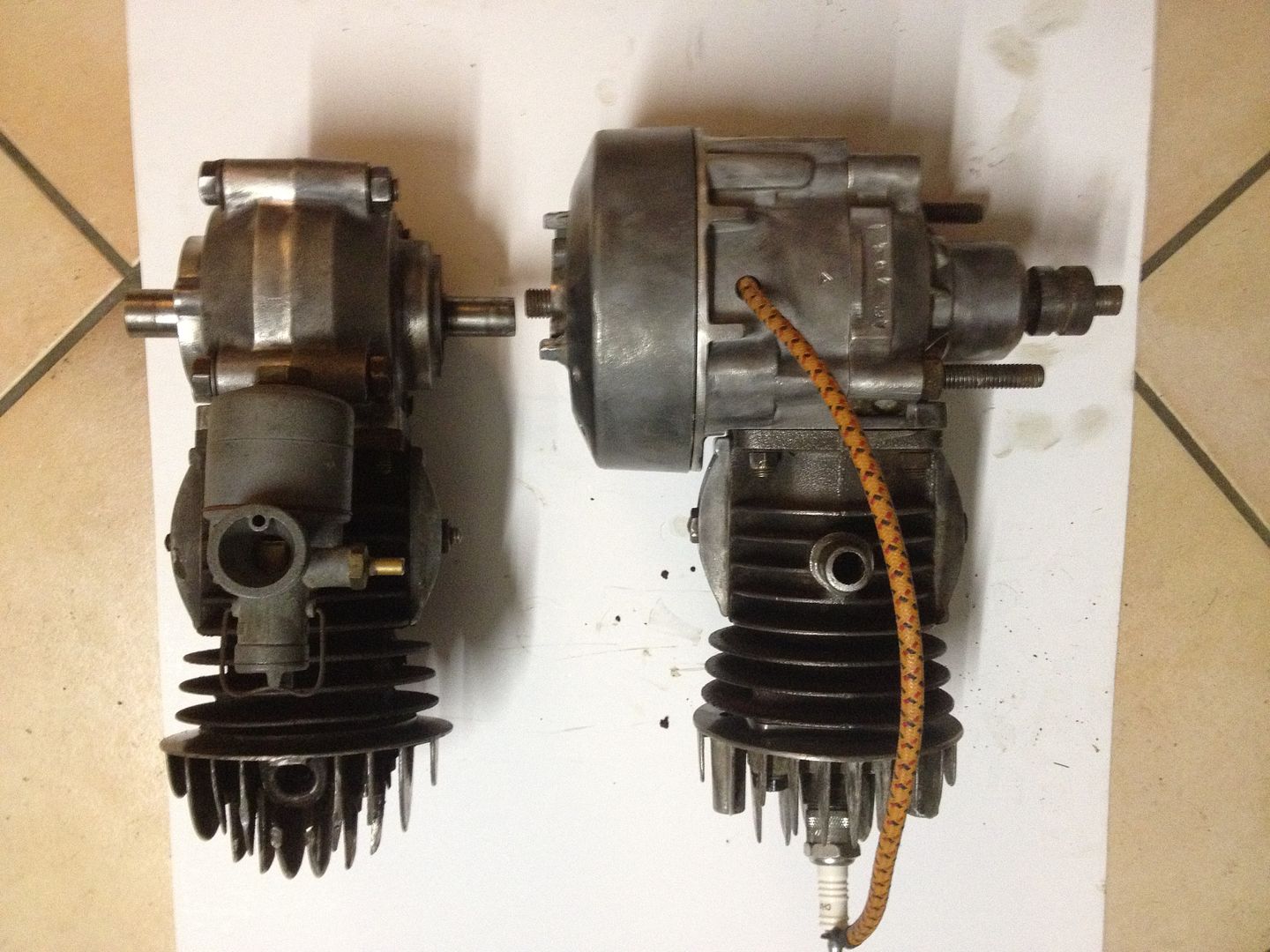

Much slimmer profile, around the same width as a chinagirl.
Compared to the other engine
The flywheel doesn't it have magnetic pickup to fire the electronic ignition? That is a Victa? what year and cc is this one? .............Curt
I thought so too Curt. I also would think that the flywheel weight would be required to make the engine run correctly. But i have seen a Victa like this one without a flywheel and electronic ignition fitted. In saying that i only saw a picture and have no idea how it ran, or if it did even run at all. Im no mechanic but learning along the way, which IMO is the best way. On this motor the flywheel shaft was damaged on the end so if it doesnt work out, no harm done.
