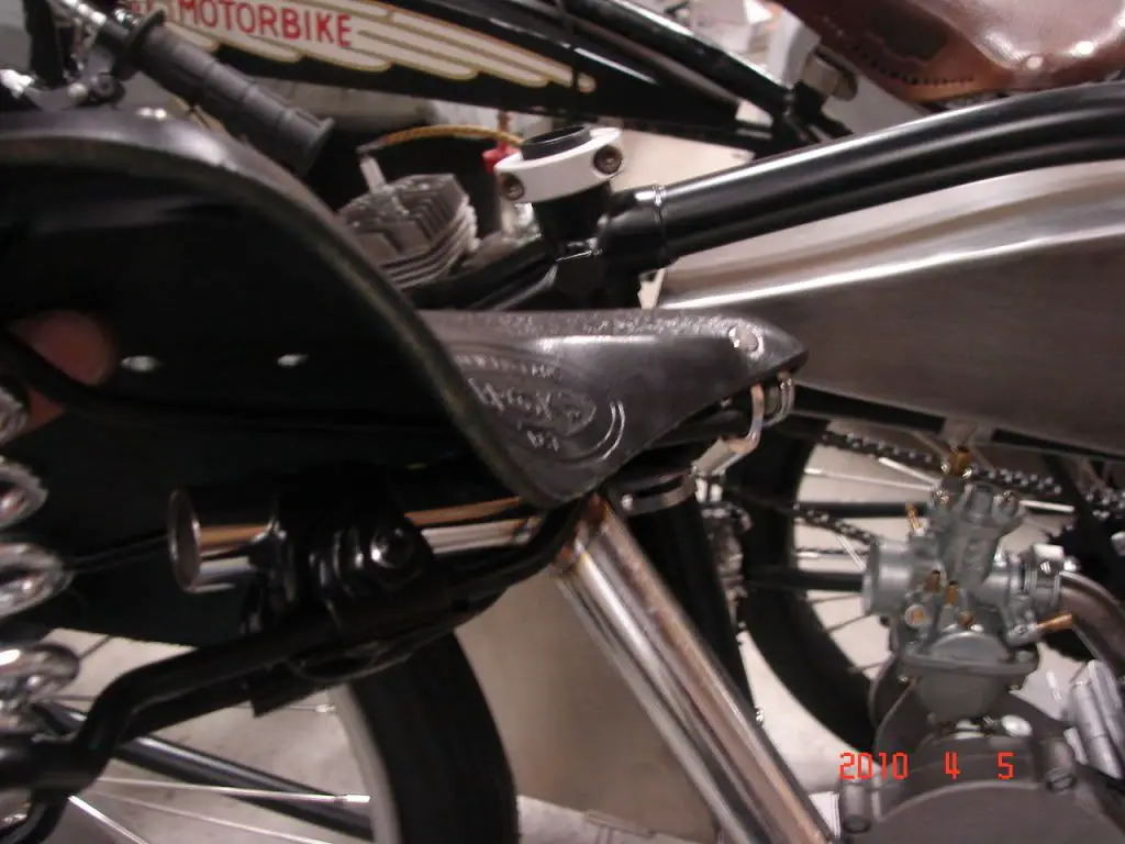

Hey Pat super nice build. Do you have any pictures of that seat tube on your bike?
Thanks,
Jeff
Jeff,
This seat post is just a straight one angle cut, rotated and tig welded back together at a 70 degree angle. By doing this then the seat rides on a horizontal section and you can slide the seat back as far as you want. Pretty stable, too. Saddle is a Brooks B67. Saddle in the backround is a Brooks Flyer in aged leather. Let me know if you need a seat post.

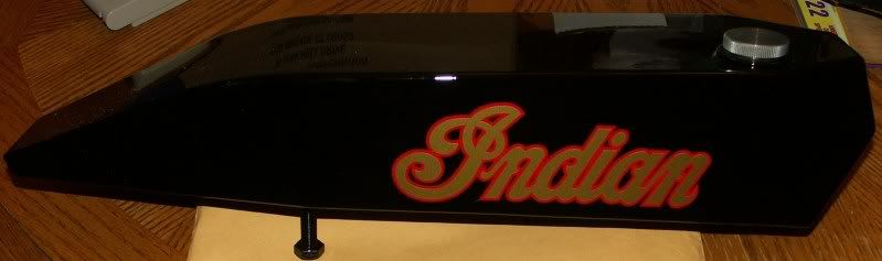

Pat heres your tank painted up for my worksman project
My bike will be all black including the motor and rims but tires will be white with white coke bottle grips.
What handel bars would be the best for the boardtrack look?

72TX340,
Very nice job on the tank, very nice. Wait till you get an oil tank, they came out really nice and will look sweet on your build. Thanks for sharing the picture. All I have done on the engine is stack two mounts on the rear of the engine and then run the front mount as is. Simple as that. I like the Grubee as it has 1" mounts to match the Works 1" frame tubes. Some engines like the PK-80 have 1 1/2" mounts that will need to be adapted down to 1". Oil tanks will be available next week for sure. I have built three prototypes so the production version will be perfect. I also have gas tank mounting straps coming out in a couple weeks that will match the ones on the oil tanks. Stay tuned!
