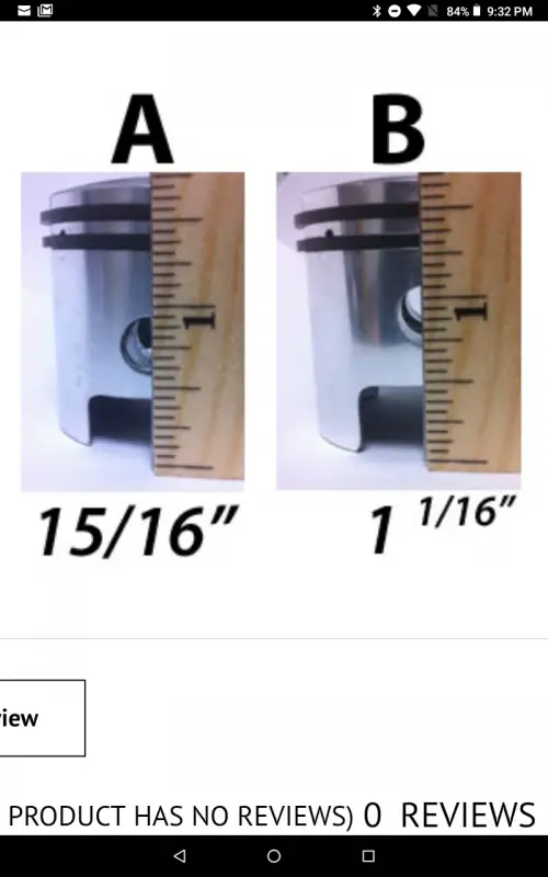

When you were assembling it did you check to see if the piston reached the top of the cylinder? There are two different pistons, type A and B, if you know the piston travels to the deck of the cylinder you have a leak as Norm said. Try to true the head and Don't overtighten it, low grade aluminum warps easy, always use a torque wrench. 12 foot pounds is all it needs.

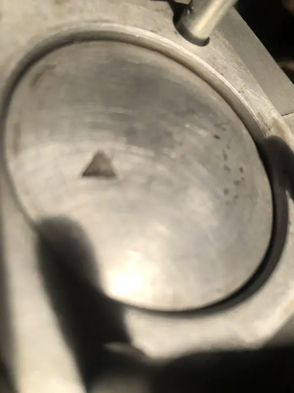

No sorry I ment before I sanded down the head I did that after sanding it down and torquing the head to 12 foot pounds the compression is still the same
The piston has a good amount of room to travel and isn’t touching the deck of the cylinder so I still don’t understand as to why I have almost no compression
The difference in the two piston’s is a little over 3mm, if you can measure from the deck of the cylinder to the piston at TDC you may find the problem
Looks like you have the wrong piston, compare the old piston to the new one. That looks like a type B piston, you need a type A. The only way to know is to compare the two.
I ordered a new piston around 3 days ago should be arriving today unsure if I ordered the correct one or not I believe I may have gotten type B and type A mixed up i’ll order a type A now

When you pull the cyl. look and see what the makings on the side of the connecting rod say, if its marked ZAE50 then you have what is called a "half breed" geometry engine, these engines are 38mm stroke but use the Type A piston with what we call a "low hole" piston.
The piston in these particular engines that I've had myself and seen lack around .060" reaching top of cyl. when at TDC.
When everything is right, good rings, good cyl. with no gouges in wall, etc.... they will still run "OK" not great power, but OK...
Judging from what I see in the pic you posted here, Im guessing you have an engine with a rod marked ZAE50 but I could be wrong... its for sure if I am, its not the first time...LOL

Hey Mapbike look at the picture above, if that is top dead center it shouldn’t have much compression. I hope its ok I used the picture of your engine to show what it should look like
