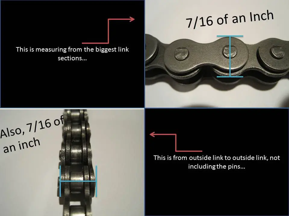

    Here is a graphic i made, just for u :D
    [​IMG]
  4. The Busted Nut
    The Busted Nut New Member
    Joined:
    Aug 2, 2011
    Messages:
    96
    Likes Received:
    PS: those are the measurements of the 415...
