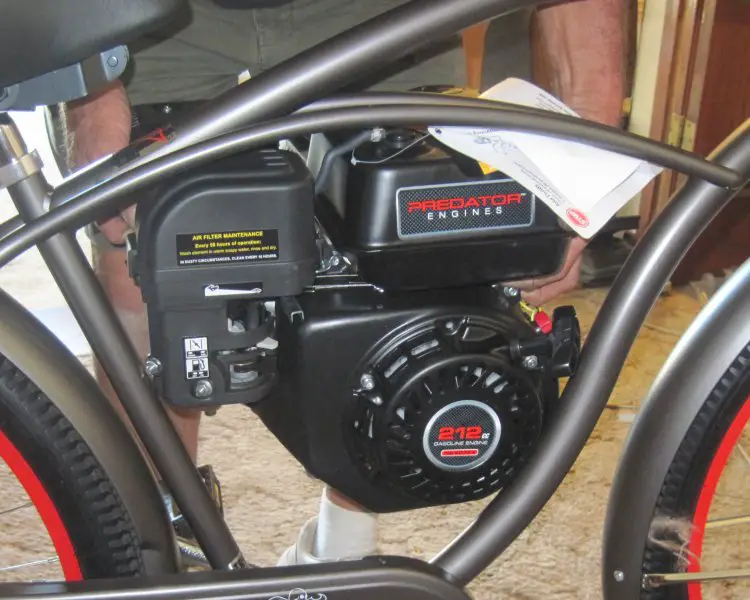

Here is a pic I found from a thread on KC's cruisers site.
So my engine will certainly fit without the stock tank, air cleaner or exhaust. I may need a vertical mount, however. We'll see
