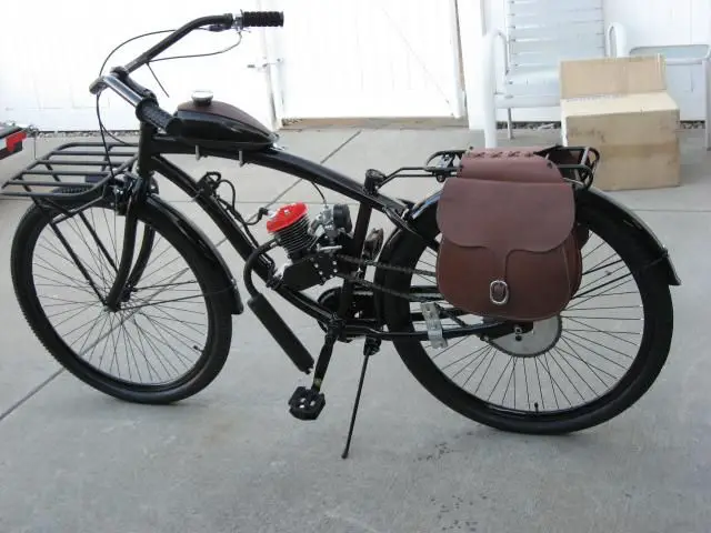

All I will say Tom is that I am heading away from the traditional look, I'm making it more of a Motorized Scout Bike. The seat post was just glare from the camera, I'm waiting on the new seat post to arrive so I can install the seat, it's all looking as planned so far but there is more to do! Stay tuned for the final outcome! drn2

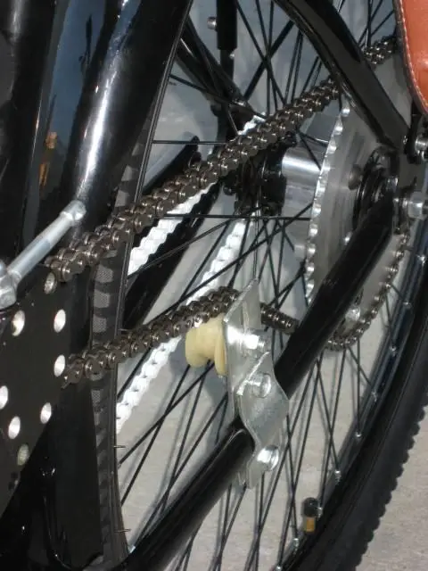

Today was a good day and a bad day, The hub adaptor and 48 tooth sprocket came from Manic Mechanic and also the 1 inch throttle assembly. I started with the Hub adaptor and sprocket, a lot of people say the stock 44 tooth sprocket works well on the 26" bikes but since mine was a 29er I bumped the sprocket size up to a 48 tooth, it was a pretty easy install other than getting the chain around the primary sprocket. That was kind of a pain, but it all worked out and it is all hooked up.

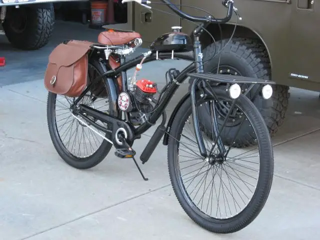

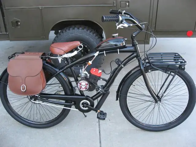

Got the seat post in and the seat on finally, also installed the front LED lights but still need to figure out a way to mount a battery. Bought 1" bar levers from a Norton but had to make sleeves for the cable ends as they were to sloppy, used a piece of metal brake line in the cable adjuster as a reducer and it worked perfectly, then cut a short piece of the same line, flared one end and cut a slice down the whole thing for the cable to fit thru, had to spread it apart to get the lead cable end to slide into it but it all worked perfectly.

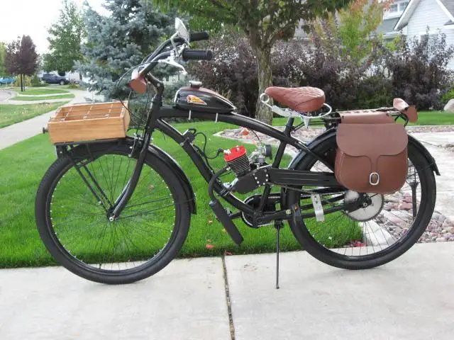

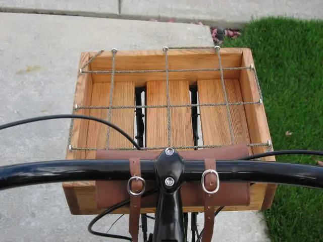

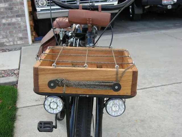

Just a little more work done, I added Indian motorcycle decals to the tank and changed out the side cover decal to an Indian motorcycles decal as well, I built a hardwood box for the front rack that turned out pretty nice. I installed with eyelets to feed paracord thru for tie down points. Bought a battery that fits perfectly in the leather pouch on the handle bars, it's for the LED lighting system I'm working on. Installed the chain guard and the front rack mount broke from vibration so I built a heavy duty one out of 1/8th inch steel. Put another leather tool pouch on the back rack. it's lookin good!
