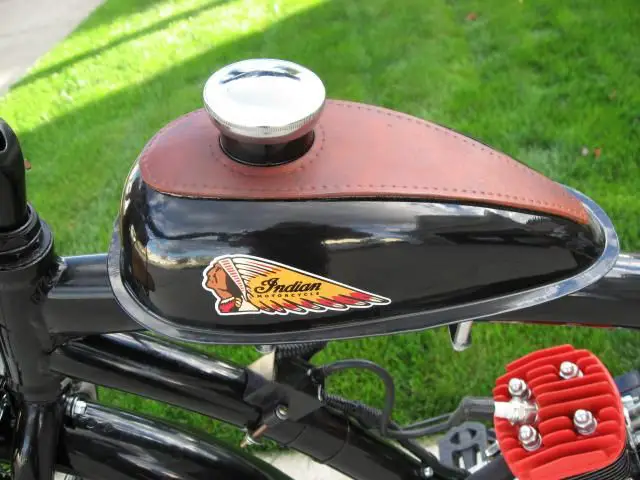

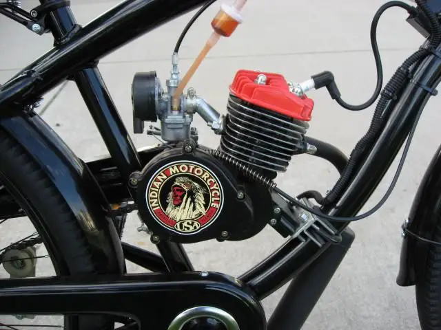

Oh Yeah.... I been riding it all over, it runs good and handles GREAT! The speed with the larger 48 tooth sprocket on the 29 inch bike is about the same as a stock 44 tooth on a 26 inch bike. I almost wish I had gone with even a larger sprocket as I am looking for pulling power and not so much top end speed. I want to pull hills! I'm going to do some performance mods once the engine is broke in.
