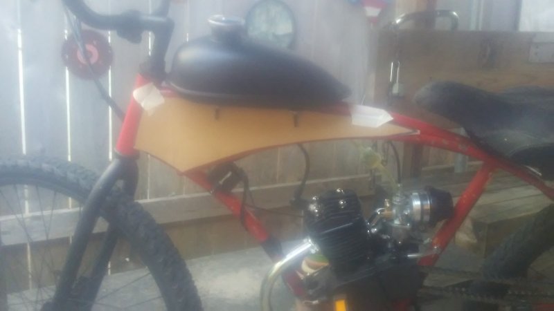

well, red ryder fired up!!! i'm stoked

check out this idea...this just template...i gonna get thin sheet metal from work and cut a plate and hide all electronics/wires
