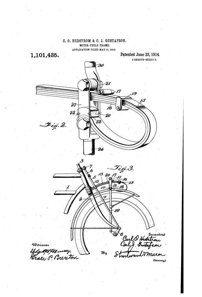

I also am looking forward to the Forks What a Great addition and Period Correct look that they will add to the bike.
More then likely you already have a copy of this.
But thought I'd send it just for general purposes. I wanted to make a leaf fork on my current build but ended up going in a different direction, So it will have to wait for the next one. No doubt I'll be picking your brain when I get there.
Oh and by the way looks out-freak'n-standing.
Heretic thanks for that close up shot,seen it but not that close up. I do have a forum made to bend a spring as i plan on doing something like the old Indian with the front and rear springs.
Been fallowing your builds and love them, the make do with what you have.
Thanks! Heretic
That Indian fork actually works like two springs the loop under is for light frequent road bumps and the main spring is for heavier bumps and combines the action of the loop spring with it, Indian had a lot of mind in their bikes and components, the spring's design was actually taken from a DR.'s Horse Drawn Buggy as they would often transport a patient and needed a smoother ride.
