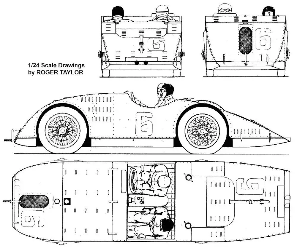

I wonder if the Bugatti Tank racer was a conscious influence on the streamlining designs in some of those old French vehicles.
I'm sure it was Allen. An awful lot of French light vehicles seem to copy that shape so I guess it must've been the hot trend of the day.

The body is a perfect airfoil. At what speed do you suppose
it becomes airborn?
it becomes airborn?
Actually, if you carefully follow the prescribed steps in starting this Bugatti, and you crank with your thumb on alongside your other fingers, it's really not that dangerous. I have a book that outlines it here someplace.
Not too much need for suspension if the track you're racing on is really flat, but I bet they felt the bumps nonetheless.
I imagine the aerodynamics might have affected traction somewhat adversely but I'm not sure how much.

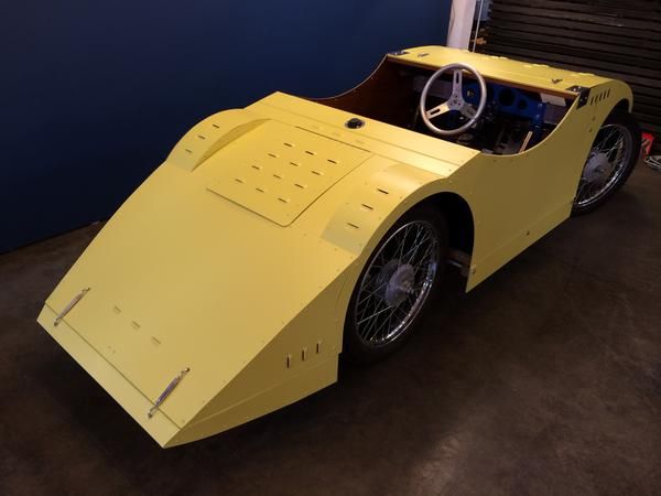

Cyclekart tribute to the Type 32b

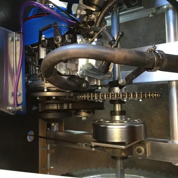

Engine and transmission.
Interesting drive, it looks as if they've used a torque
converter in place of a differential. That could work
I guess??
Oh, I see; that's a drum brake. Sudden stops are
probably out.
I guess??
probably out.
There's no diff, the drive is transmitted on one wheel only that's keyed to the axle. The other wheel is free to rotate on the axle shaft.
This is a handy alternative to a diff. It's first world championship was won on a Rolf Biland sidecar outfit (in 1974 I think).
http://en.wikipedia.org/wiki/Viscous_coupling_unit
Interesting. I wonder how much one of those costs?
They're not too costly, but I don't think it would
be easy to adapt for an axle. Yeah that's definitely
a brake in the pic, but it does look very like a torque
converter at first glance. It's been a while, but I've
seen torque converters for around $40.
Ludwig,
Just spotted the link you were referring to; That unit
is quite different than the converters I'm familiar with
which are meant for small engines. It does appear to
be an alternative to a diff.
