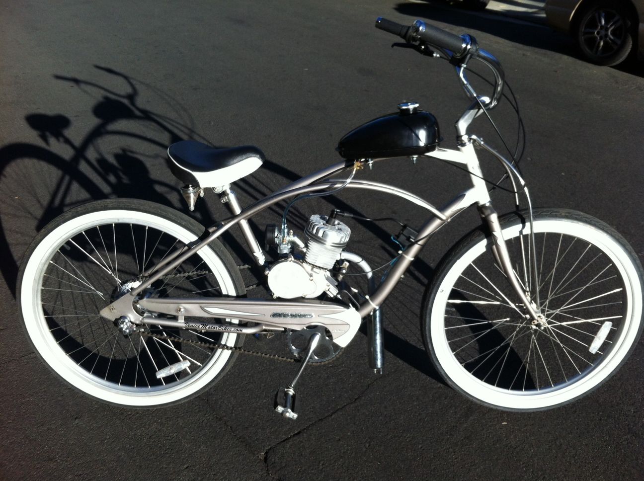

We had a extremely busy day in the shop yesterday!!

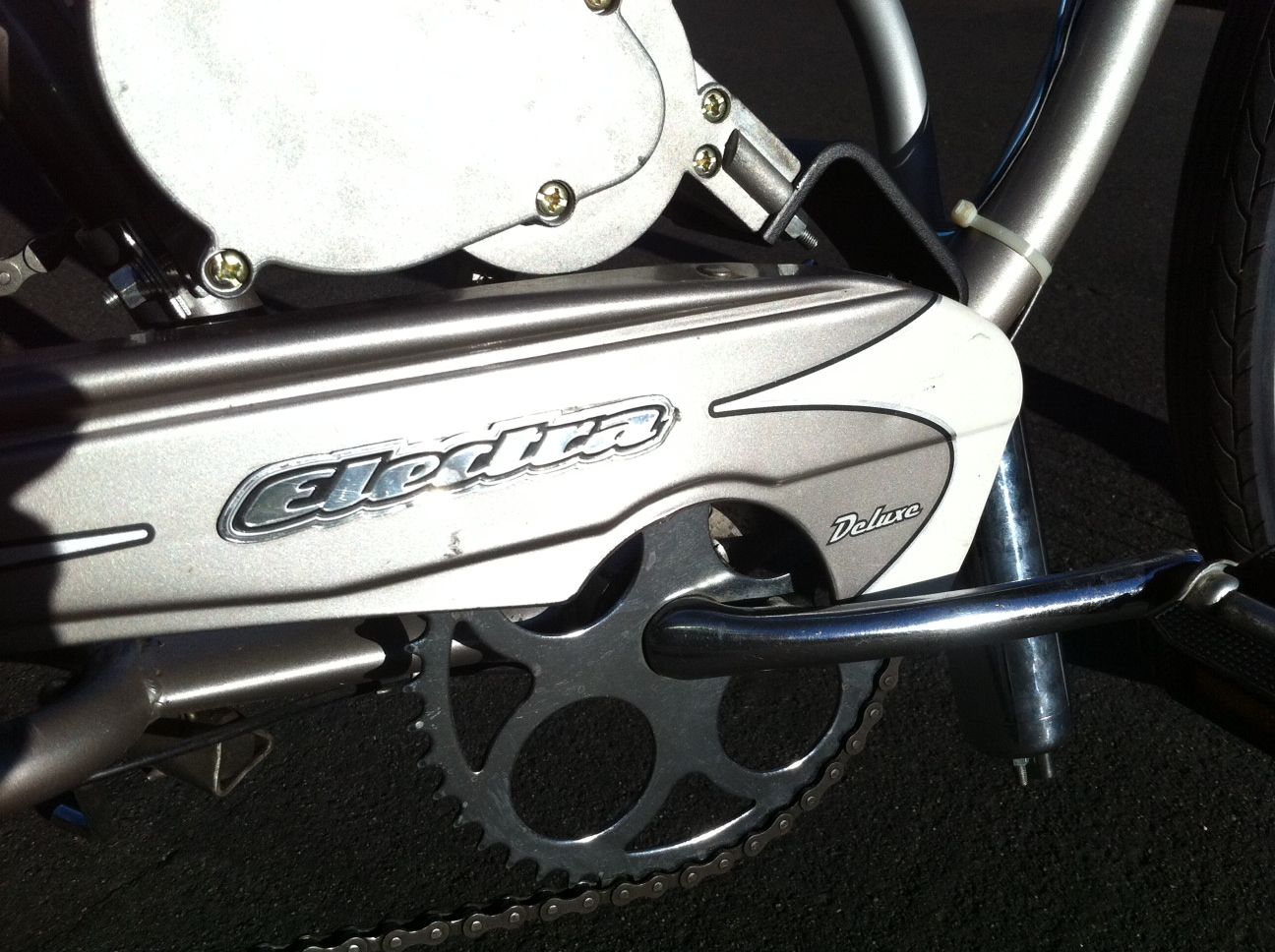

In the middle of it all, we managed to build this Electra 'Deluxe' cruiser in only 2.5 hours for my friend Ronny!!

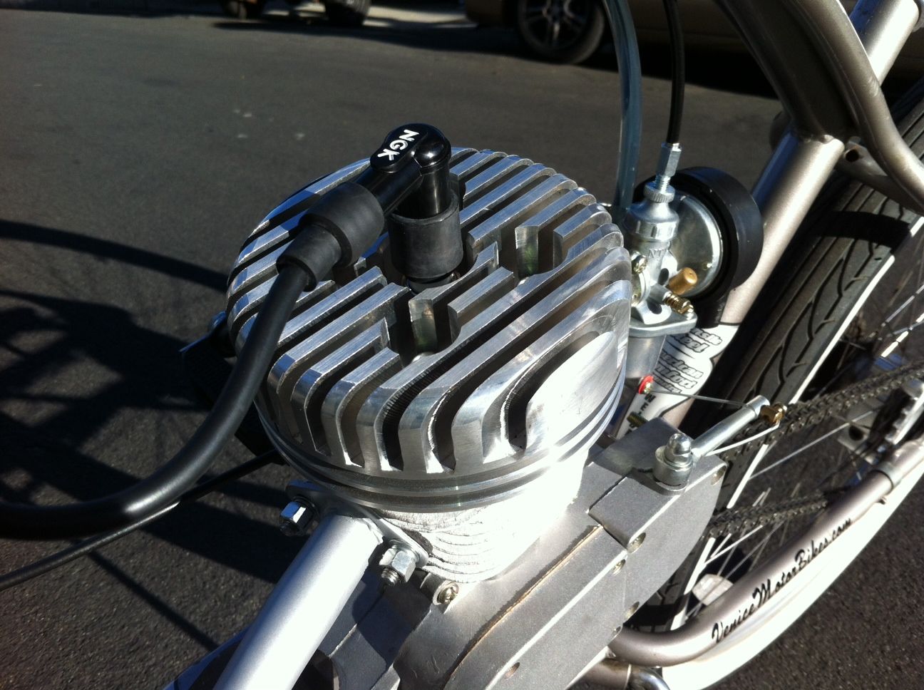

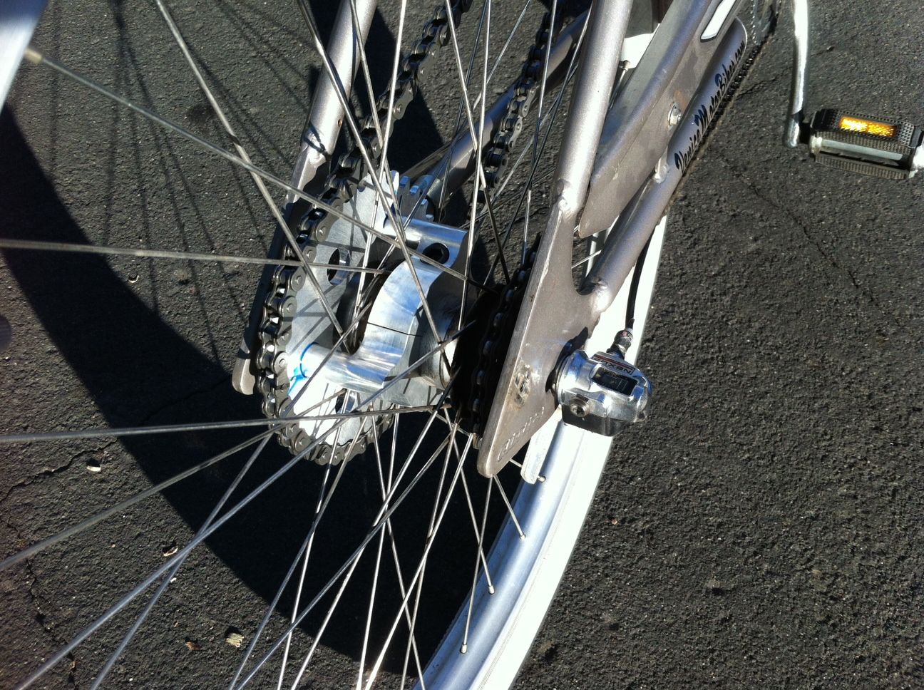

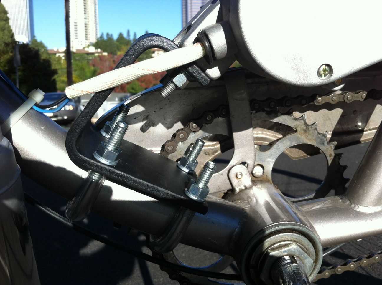

We made a custom front mount from 1/4" steel, installed a custom Sportsman hub adapter that was machined to fit a Nexus 3-speed, & we also installed a CR Machine head that I had laying around.
I think this one came out very nice.
I asked Pat to custom machine me a batch of hub adapters (to VMB specs) for the Nexus hubs... I paid a lot for them, but it's totally worth it to be able to keep the 3-speed! (^)
how much does one of those heads set me back?
thats the look im goin for on my rebuild...to be finished through the winter.
Nice quick build Norm! Sounds like pretty soon people will be able to pedal in, go grab a quick sandwich for lunch, then pick up the bike and motor on back to work!
nice bike it should be a great bike
Thanks, This bike rides real nice; & I've never been happier with the quality of the engines I'm getting these days! :D
CR Machine has a listing for them here & on ebay... I'm not sure of the price these days.
