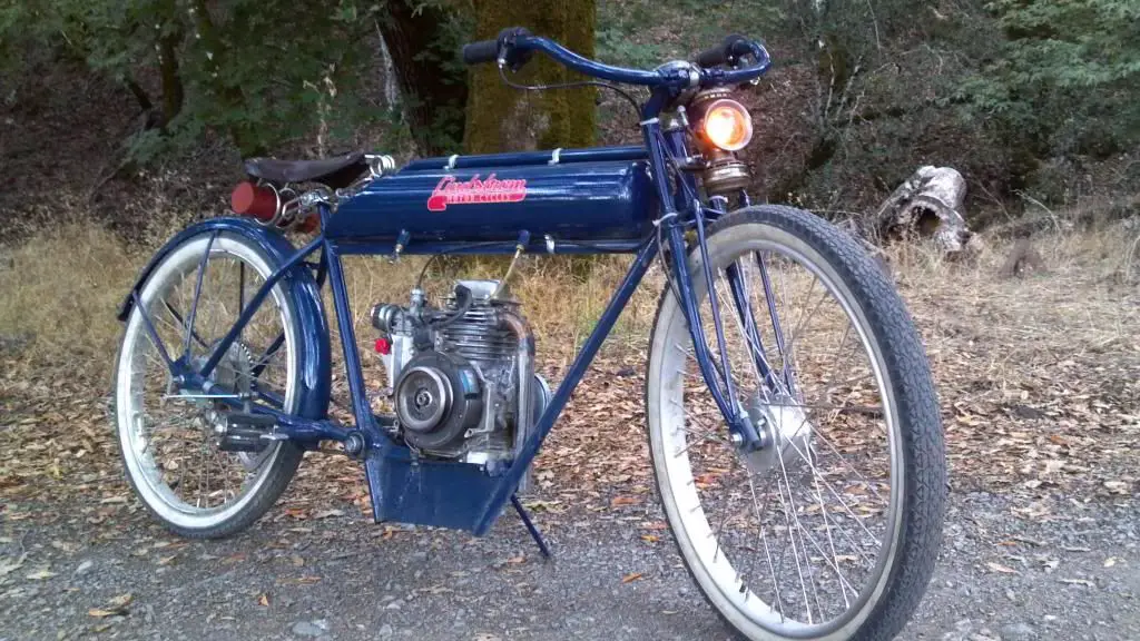

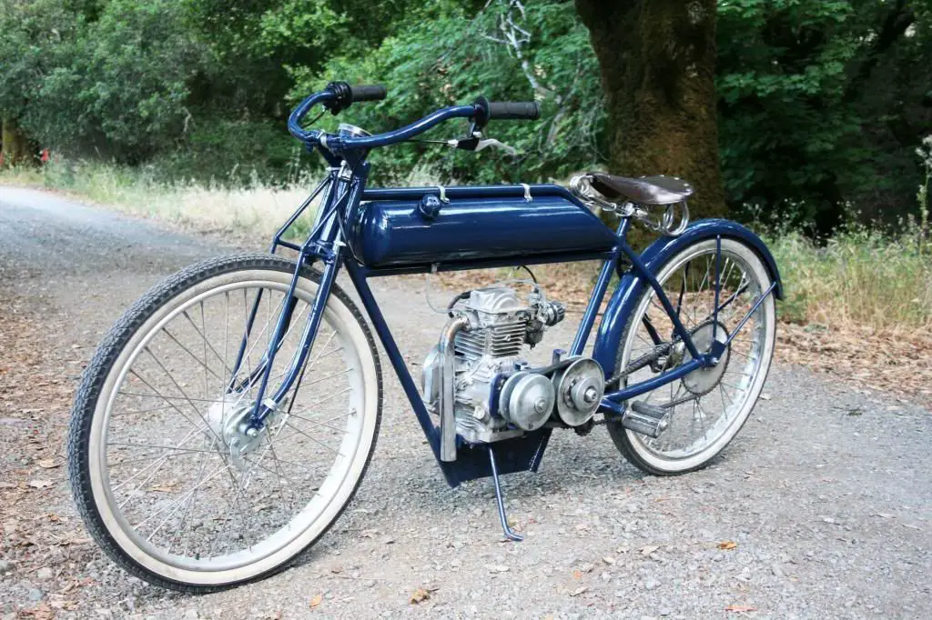

Hey everyone, I've been lurking on this site for a good couple years now. I've been slowly putting together a bike inspired by builds from cobrafreak, sportscarpat, lurker, dmar836 and others. My bike is nearing completion, and while there are a thousand things I would do differently if I were to start again, I am satisfied with it as a first project. There are definitely a few additions I'm planning on making, but I thought it was time to post something. Also, the pedals aren't functional, just footpegs essentially, so if it's determined it doesn't belong on this motorized BICYCLE site I understand. Anyways, have a look (more pictures to come later).
I prefer the more upright riding position, although i admit the board track style is far better looking. Soon I'll throw some simplex tires on there. Someday I might try to make some functional pedals, but mounting a sprocket on either side of the worksman hub doesn't seem possible. A pedal system like lurker's first build might be in the future. I'd like to someday make a longer, more heavy duty fork with slightly more rake, so i could fit a front fender. Also, maybe some plates to go below the engine like dmar836's bike. Some sort of logo will go on the tank. A centerstand would be cooler than my kickstand. Like I said, if I were to start over, there would be a thousand things I'd do differently.

That's a good looking bike, Kyle. I'm sure all would like to know more of the details of your build. Do you have any ideas of what you will call the bike? Not "old blue," I hope!
maniac57
Oct 8, 2011
4,484
22
memphis Tn
I say it's a bike even if the pedals don't function. Never seen a motorcycle with pedals. (at least not lately...;o)
Nice build! I foresee some beautiful stuff from you in the future...
truckd
Oct 19, 2010
2,837
134
palmdale calif
Very Nice! looks like a Honda GC160 how do you like it? there is always something you'd like to change, modify, upgrade Exc,Exc,Exc LOL!
sportscarpat
Jun 25, 2009
1,844
485
83
california
Hi Kyle,
Absolutely beautiful build! Nothing wrong with building it as a cruiser as we all know the comfort level is greatly improved. It's also easier to convert a cruiser into a boardie than a boardie into a cruiser. Niice build.
Pat
Tinsmith
May 15, 2009
1,056
259
83
Maryland
Kyle, Nicely done! Very clean look and like you, I prefer to sit more upright. Enjoy riding that wonderful creation.

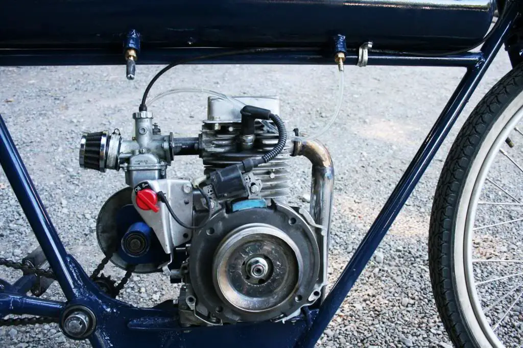

The engine is a GC190 (it was slightly cheaper than the 160). I'm really happy with it, plenty of low end torque. It doesn't have the racing after market parts like the GX200, but it's plenty fast for me. Took it down on the road and it made 50mph (granted I was using a cheap bicycle speedometer), which is way more power than I'd use on a regular basis. I'm using a Mikuni 22mm carb.

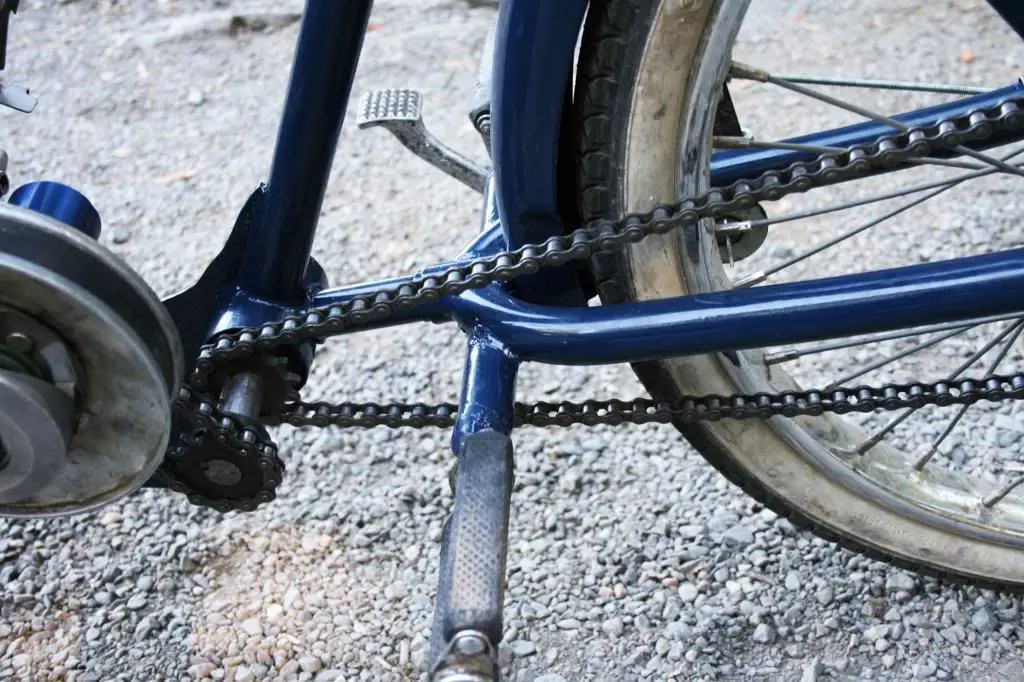

I've got a jackshaft to move the chainline over from the CVT to the sprocket.

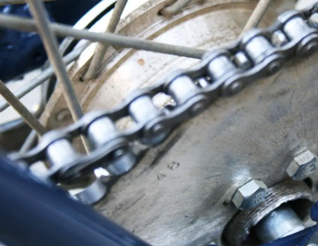

The sprocket is simply bolted on to the worksman hub. I've seen this done a few times, and so far it's held up fine. I could see this being a potential weak link in the future, but we'll see.

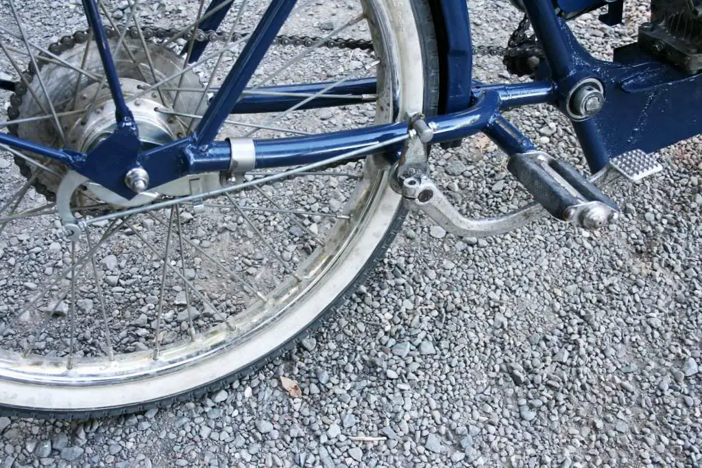

The wheels are both Worksman with drum brake hubs. The front brake is operated with a hand lever, and the rear with a foot pedal. They were originally both hand levers, but I switched to a foot pedal after I was getting a lot of movement in the cable housing, causing the rear brake to be a little squishy. It's much more effective now.

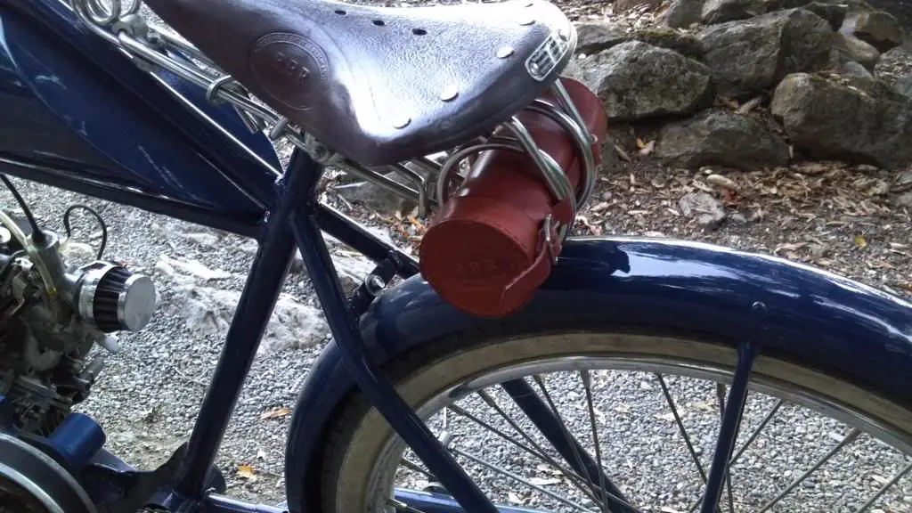

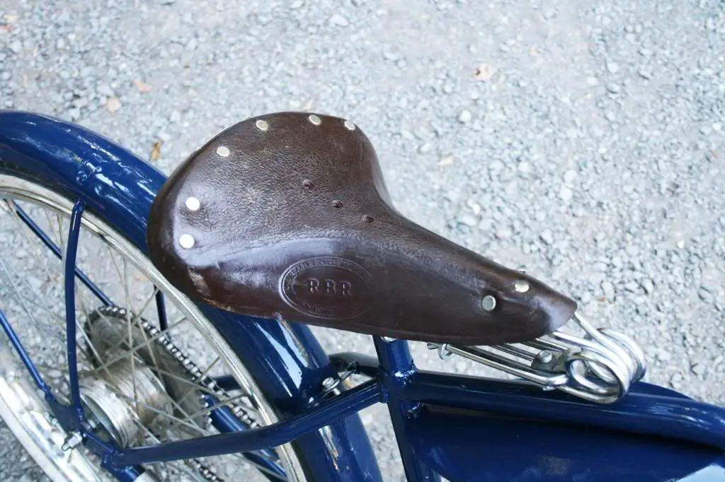

The saddle is one I bought off www.hiwheel.com for the very reasonable price of $29.95.

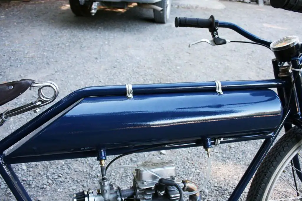

The tank is two fire extinguishers welded together. I'm going to use the rear one as a reserve tank. I left the dividing wall and drilled a hole at the top of it, so when the front tank is full, it will fill the rear. Then when the front tank is empty, I can switch to the rear with a Y valve (that I have yet to purchase. Right now the rear fuel line is just plugged). I thought it was a cool idea, even though this gas tank is way bigger than it needs to be, and I'll probably never run out of gas.

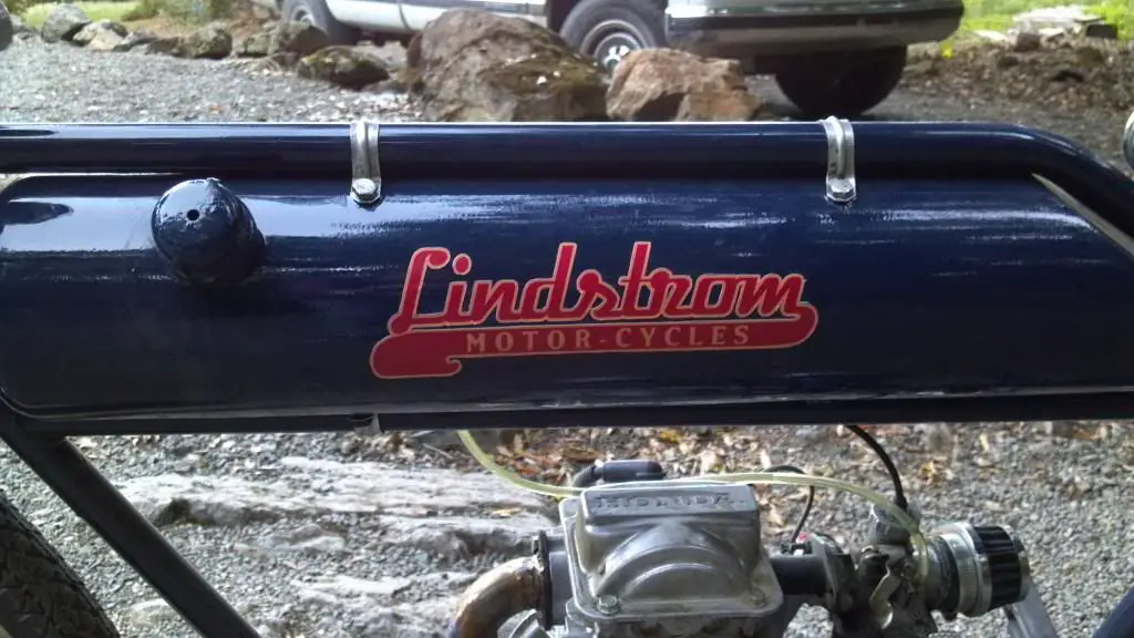

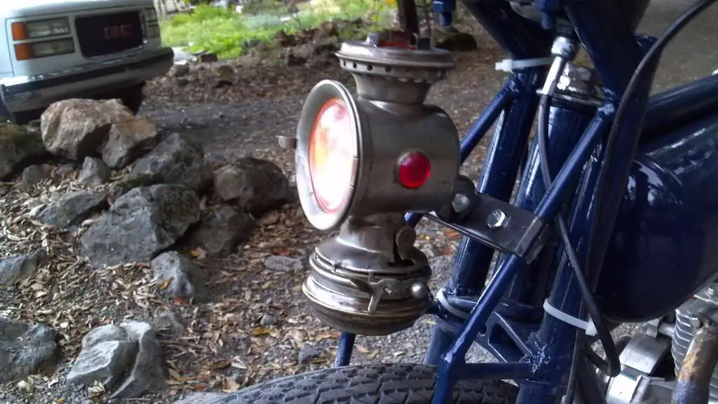

Added an antique headlamp, a tool bag, and a logo.
