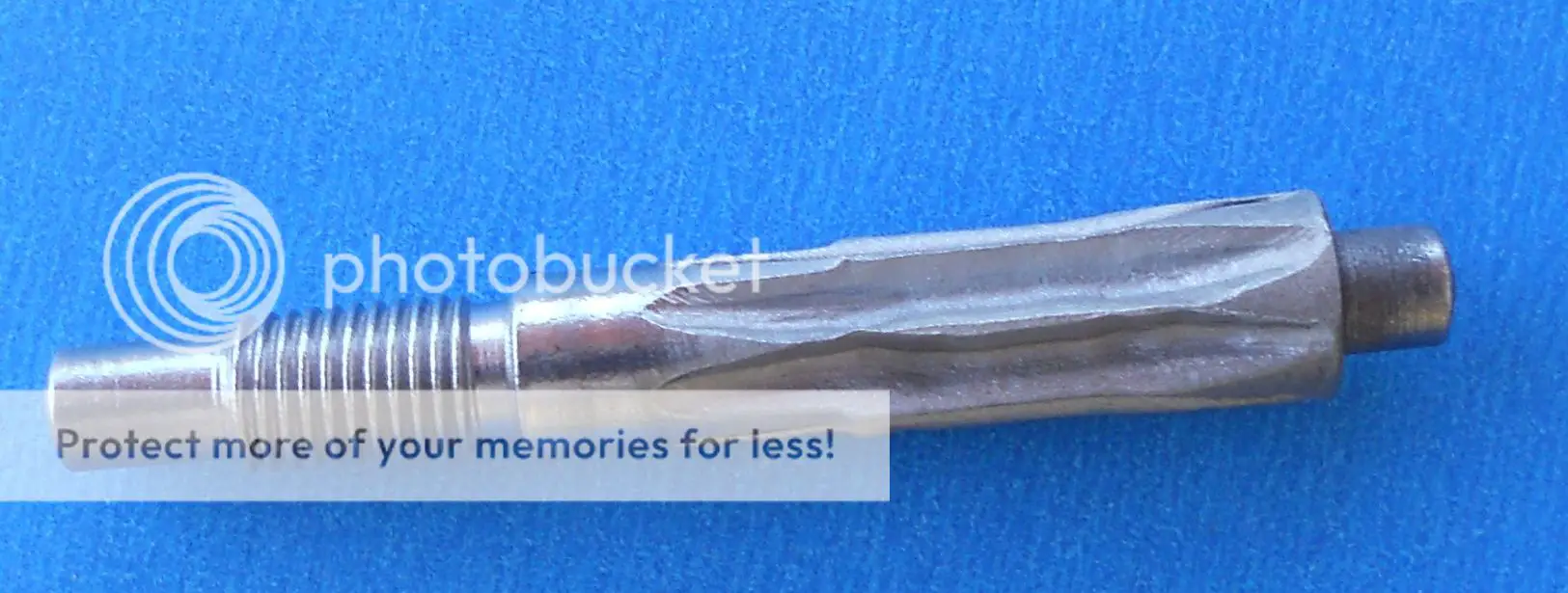

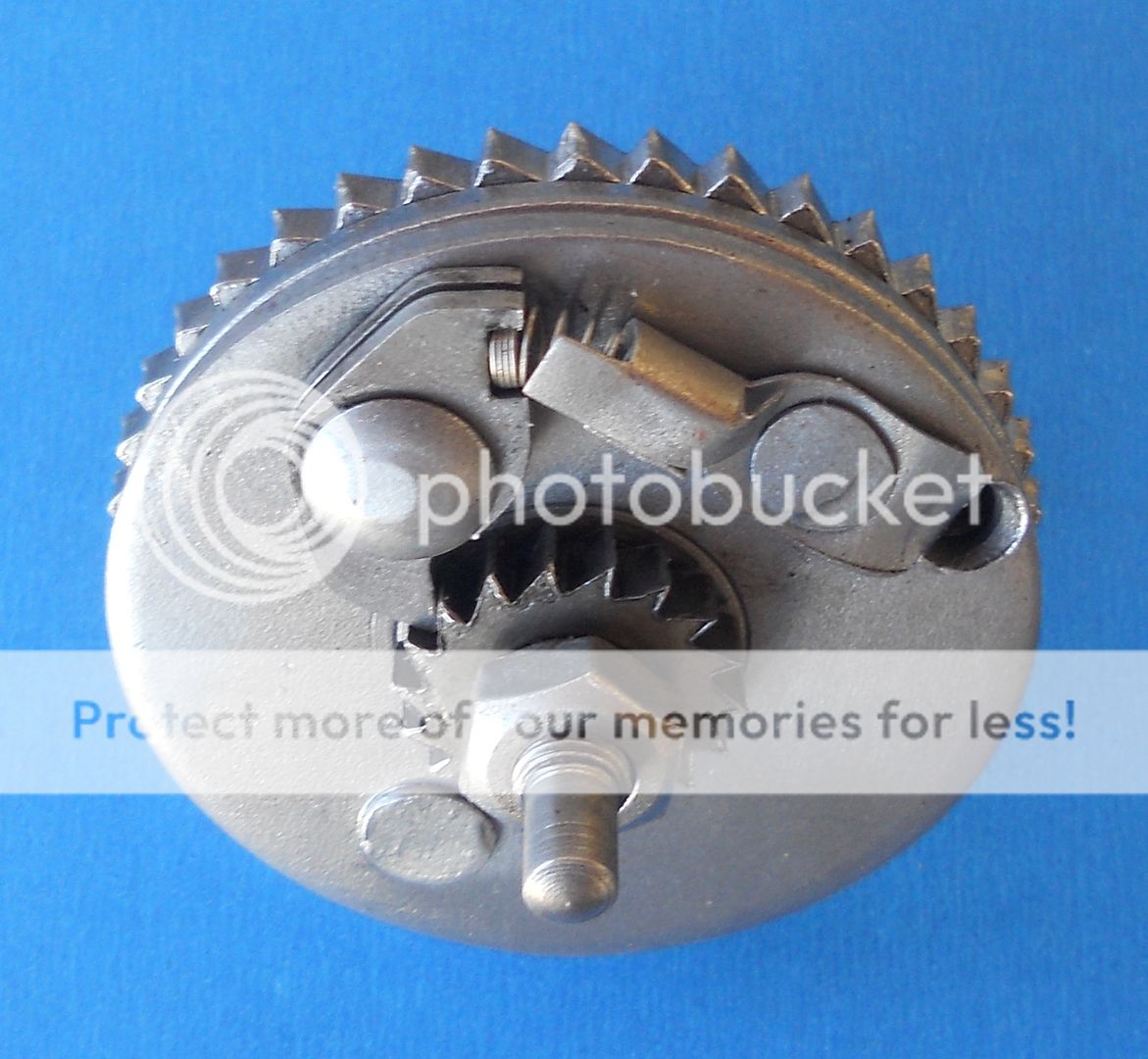

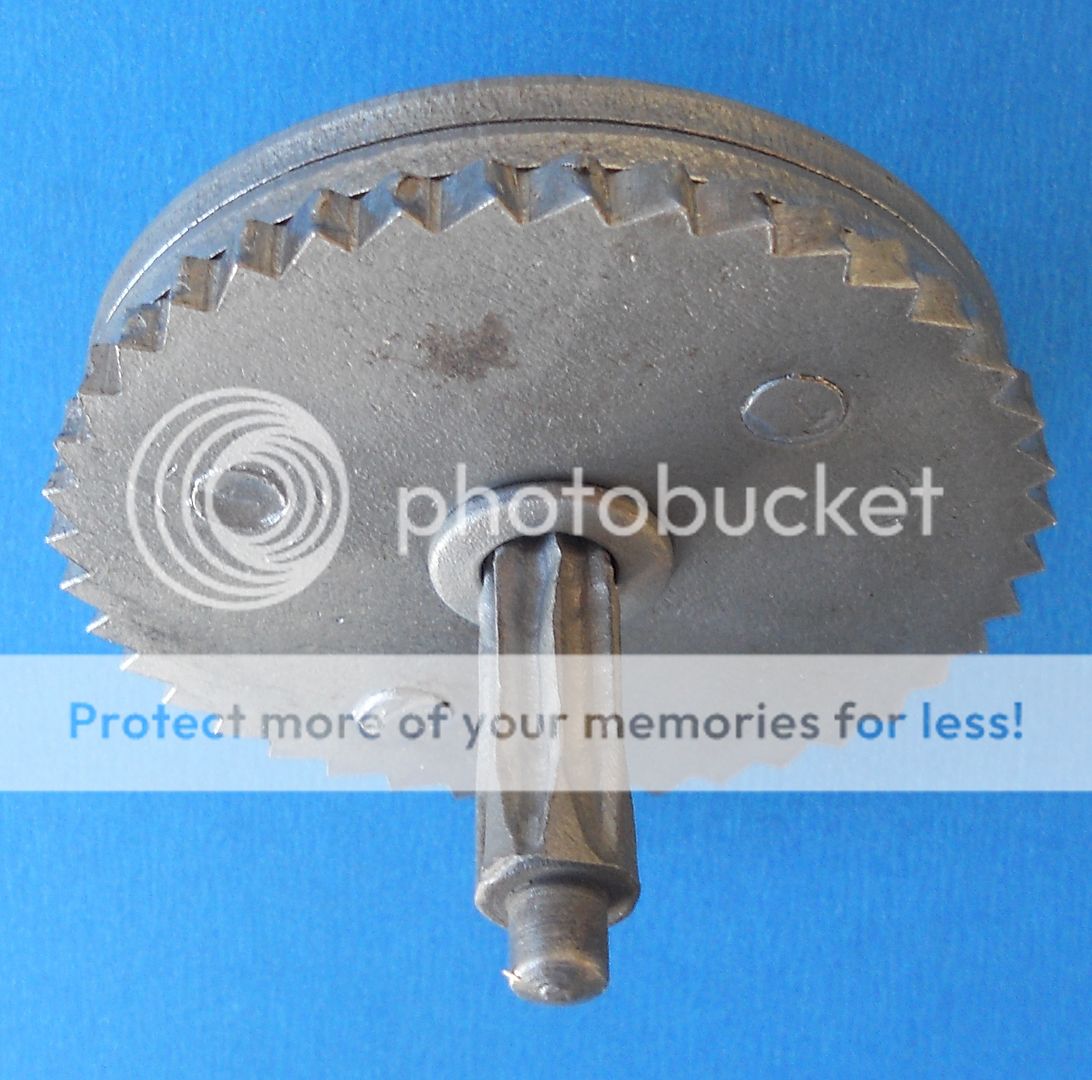

I also love Tig, it's so neat and clean and precise. Running a file over the welded up tooth seems like it's already hardened.
The axle came out pretty good and works smoothly, so I assembled the flywheel.

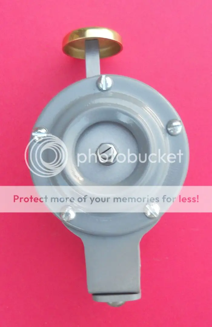

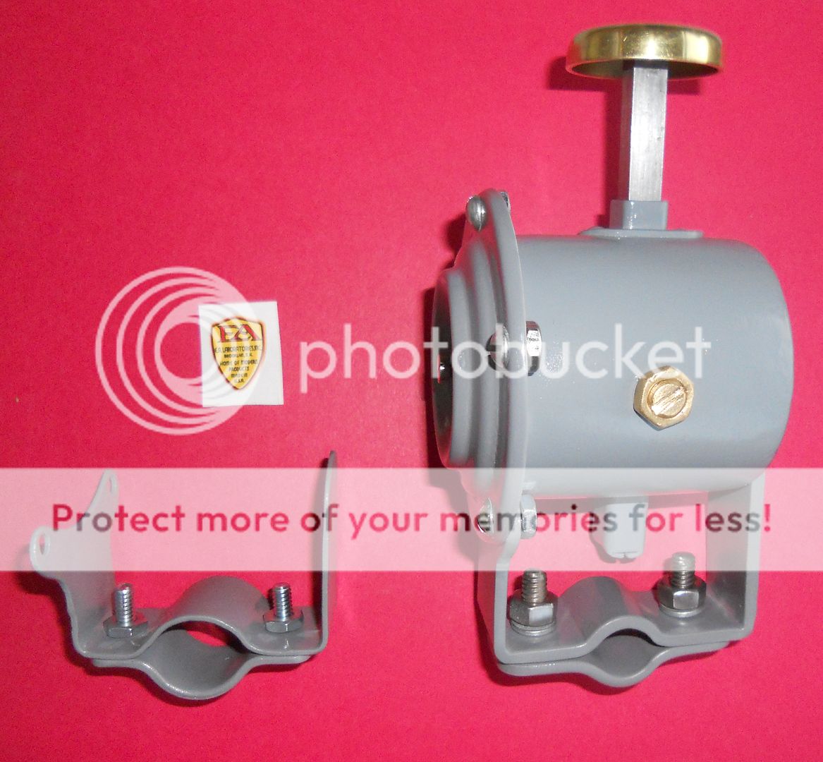

Gilbert, your horn came out pretty good. Still beat up some but sounds cool. Very loud. I made a completely new bracket for a 5/8'' bar instead of using a bushing. I'll send your original 7/8'' in case you want to put it on larger bars. If you use the decal, place it wherever you want on the horn. I'll try to mail it tomorrow. Thanks for allowing me to use your ooga for this thread.

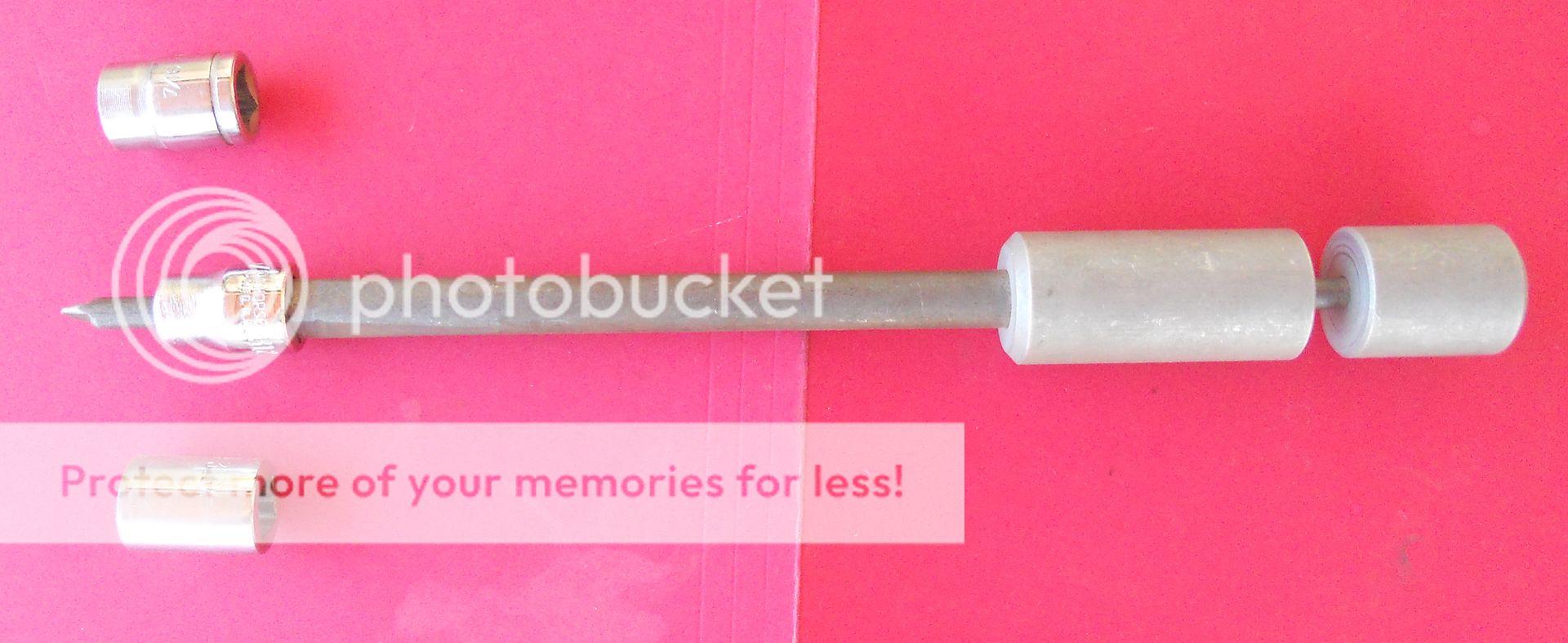

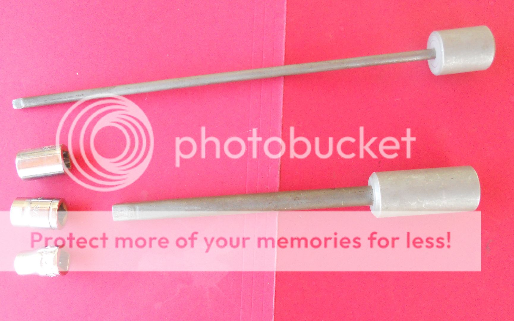

Alright Kirk. Hope you find one with all the parts. I also made a tool to adjust the tone. It reaches down inside the horns with the deep bell and turns the nut independently of the screw. Three sockets fit all the different horns I've dealt with.
