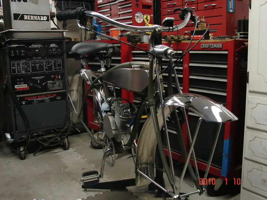

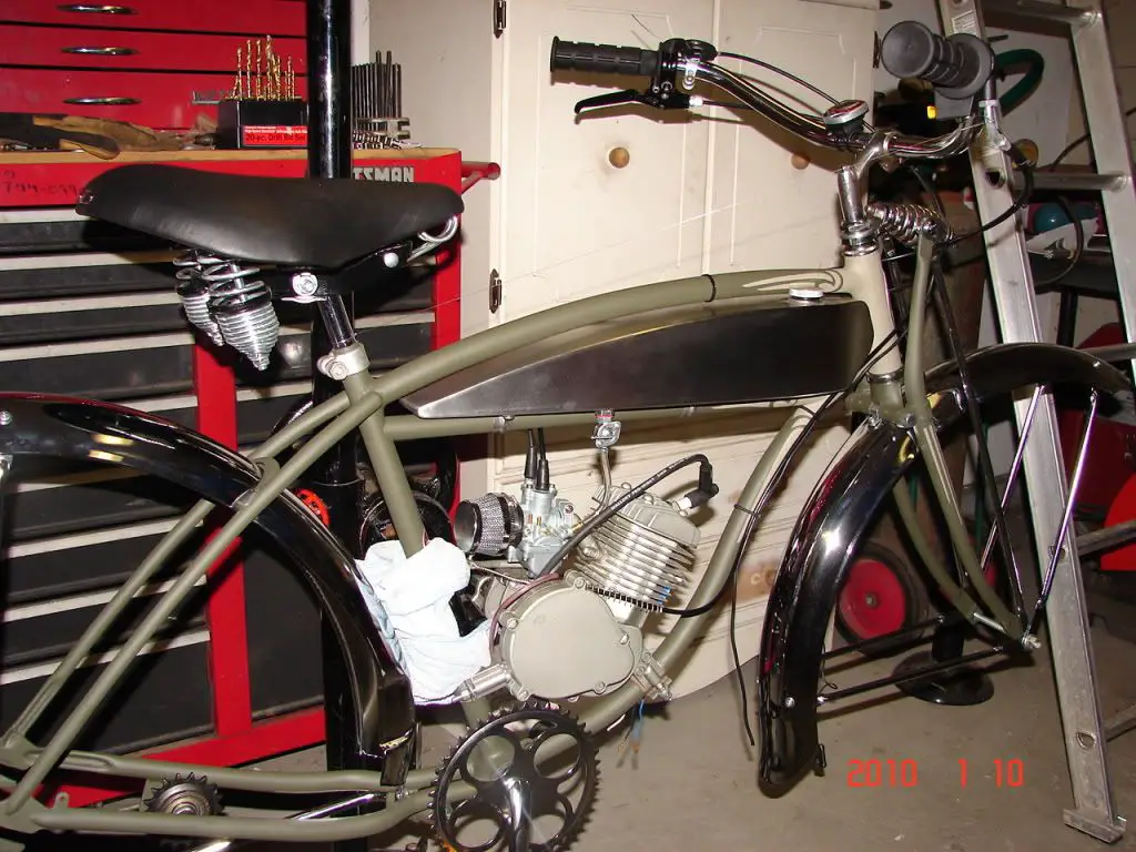

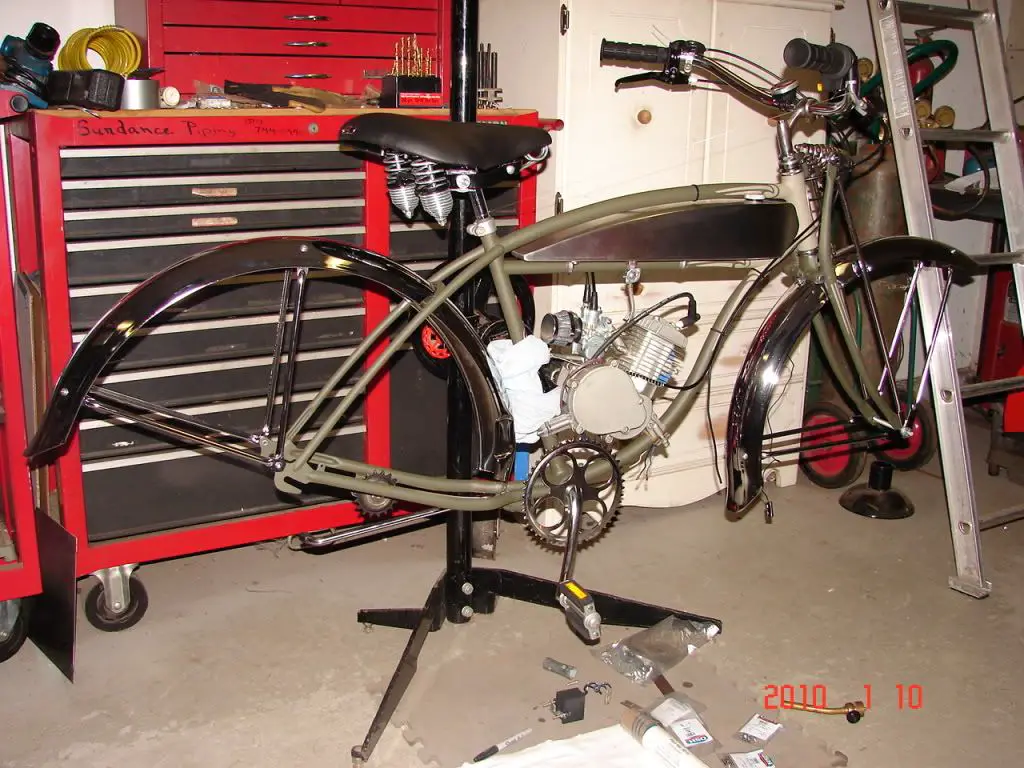

I have been pretty busy lately working on various projects. My wife has been riding my motorbike around quite a bit and asked if I could put one together for her. I have wanted to do a military style build and figured this was my opportunity. I had plans of an olive drab and desert camo paint job on the frame and every other part of the bike either green, black, or tan. I started with a Schwinn frame and a stencile kit off of ebay to give the frame a stock Schwinn paint job using the olive drab and tan. Well, the wife got involved and now I have a lot of chrome pieces as well. It's really susposed to be her bike anyway, so what could I say? It has started to take on it's own personality now. Not at all what I had started out to build, but I am beginning to like the looks.
Here is a partial components list:
1952 Schwinn Panther
Parsons seat that I recovered in black leather
Unknown cruiser bars with Schwinn stem
Oury grips
Schwinn $10 special cycle computer (these work great)
Chrome ballon tire full fenders (these were going to get painted black or olive drab)
Latest manufacture PK80-J Slant Head in silver
CNS Carb
One of my custom in-frame tanks in an unpainted "scotch-brite" finish
1952 Schwinn springer fork
18 tooth bearing mounted idler sprocket for a #41 chain
1995 Schwinn Phantom crank, sprocket, and bottom bracket
All I still need are tires and wheels.

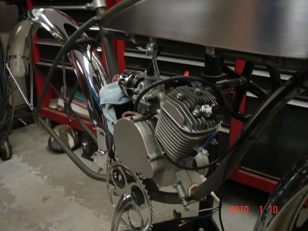

have you ran a cns yet? I have 2 and dont like them i have more luck with a jetted stocky like the shim on that fat frt mount u made nice bike

Thanks for the replys guys. I like CNS carbs. I found that on my 80cc Grubee that I lost a little on the bottom end but the trade off was a far smoother running engine and no more four stroking. I threw an expansion chamber on the Grubee and then got the bottom end back. Wouldn't run without the expansion pipe or CNS carb now that I know the difference. Flybytaco, if you want to sell those carbs give me a shout. Boscrowe, I make the tanks for the Schwinn Panther and have frames available also. I now have a Worksman frame and plan to start building tanks for them soon.

The best advice I can offer is also the most difficult part. Precision. Joint fit-up is critical because your working with thin sheet metal. If your joints are perfect the welding process is much easier. If you have big gaps then your going to have problems. My tanks are all corner welds as this is the stiffest part of the tank and this helps to control distortion. Make it out of thin poster board first and tape the joints to build a 3D model, test fit to the bike. When its perfect cut your metal from the developed patterns.

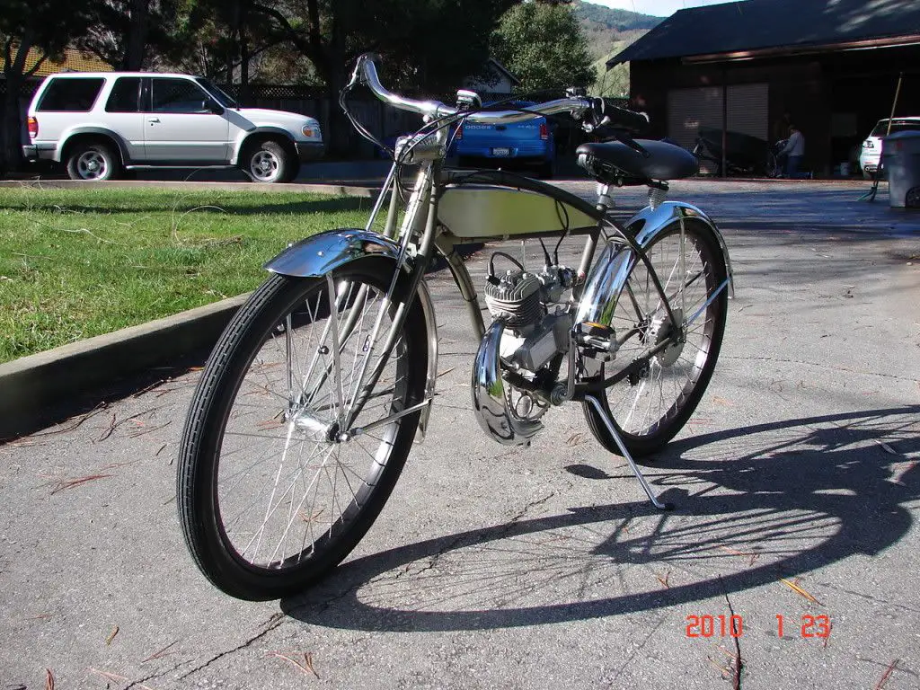

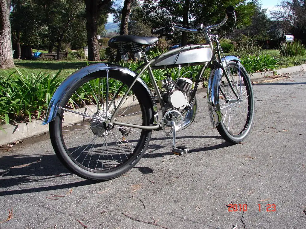

The fenders are an ebay special. $60 shipped. The guy lists them as Schwinn ballon tire fenders. I had planned to paint them but the chrome is really nice. So far they are still chrome. Here are a couple shots from yesterday. I just need to get the chains mounted and she's ready to ride. We had a pretty cool tech session at my shop yesterday with four motorbikes. Talk about a good time! We went for a cruise and just got poured on. It was raining hard. Ended the day doing water burnouts on the motor bikes.

Hi Roman,
