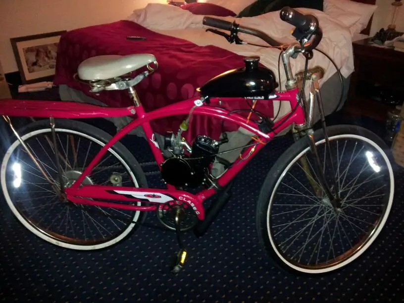

It doesn't look as naked as I thought it would.
Not bad at all if I do say so myself...
First powered run today, very satisfied with this
first start up. Ran it around the hotel twice, allowed
it to cool down while I re-checked fasteners and
such. Gave up on the coil screws, a lack of nylok
nuts meant possibly over tightening to keep them
from coming loose. It's much more effective to
simply zip tie it to the frame - like someone else
suggested.
There are some things I'd like commented on;
1) How does the fuel get to the crankcase?
2) Mixture screw: In is lean & smoke is good, right?
3) There appears to be no conventional idle adjust,
just go with adjusting the throttle cable?
4) What am I forgetting to do?

1: fuel goes from the carb down into the crankcase and then up into the cylinder through the transfer ports inside the case.
2: You have a nt/rt carb. The screw is only for idle. It does NOT affect mixture.
3: the screw on your carb IS the idle adjust, not the mixture. These carbs adjust with needle clip and jet size for mixture adjustments. New engines often won't idle corrctly until they have a few tanks run through them. Wait until you have 3-400 miles before trying to get the tune perfect.
4: Ride it!
Now THAT'S unexpected, thank you very much!

WARNING!
The fuel line that came with the motor kit is incompatible
with gasoline! It started shrinking until it popped off the carburetor!
Do not trust the more or less clear rubber fuel line that
feels like a medical tourniquet.
