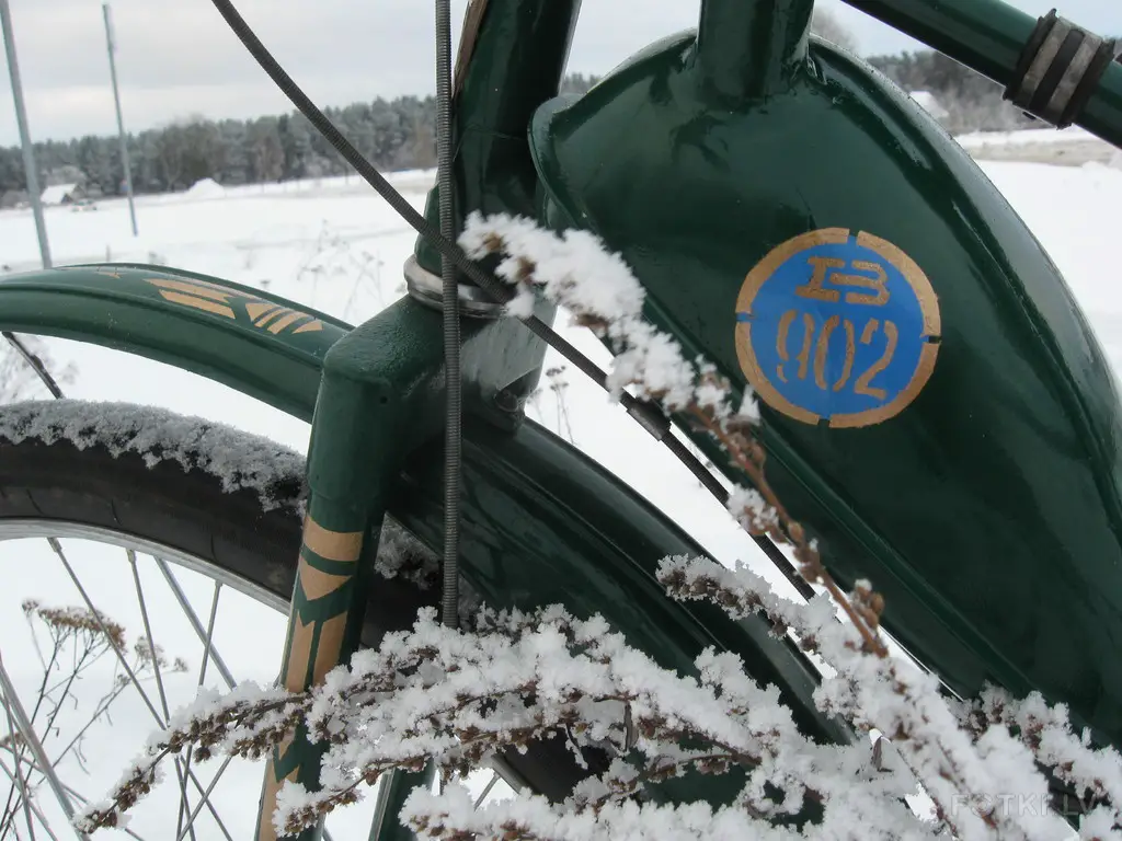

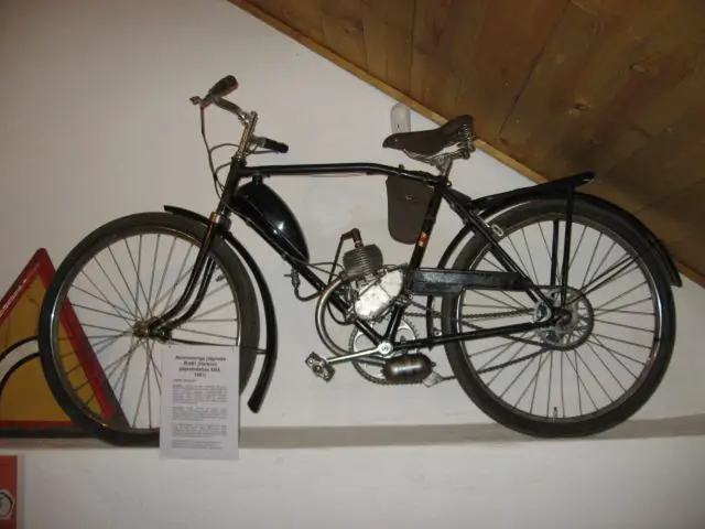

This is one of my projects, renovation of an old motorized bicycle, "V-902" model, second genuine USSR motorized bicycle after "V-901".
Made in Lviv, Ukraine, in Lviv bicycle factory. When engines D4 (original ancestor of Chinese kits) became available in USSR, first of all they (engines) were mounted on standard 28" road bicycles, like this:
But big, high frame, big wheels and just one "Torpedo" brake was too weak and dangerous for driving with motor. That time (1959) there were not so much asphalt roads in Russia, so endurance was crucial.
Thats why constructors in Lviv created special frame set for D4 engine, with additional hard tubes, strong Cho-Mo frame, amortized fork, drum brake on front wheel.
V-902 became first high-series motorized bicycle in USSR, because Krarkov bicycle factory could not produce very much their own constructed V-901, they had to produce more and more ordinary, non-motorized bicycles.

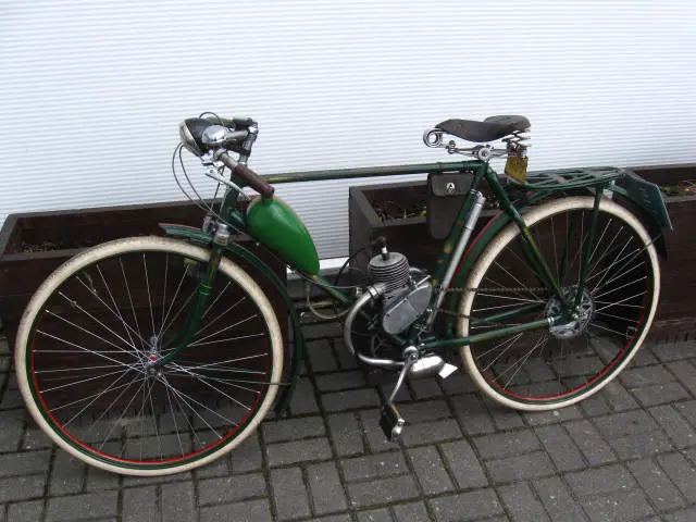

Well, here is model "V-902":

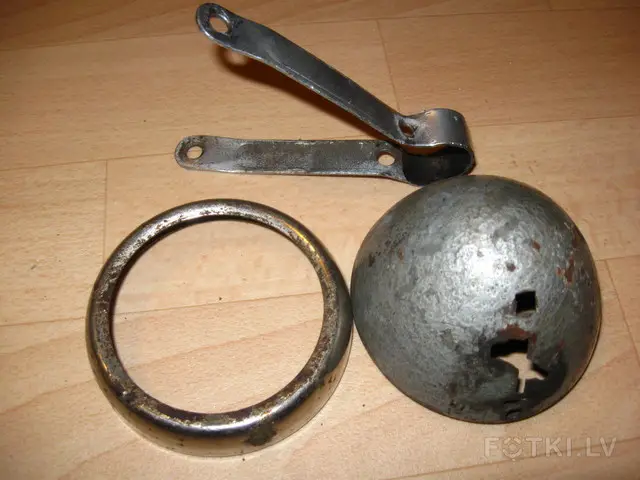

I started with collecting genuine parts:

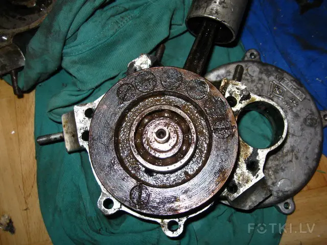

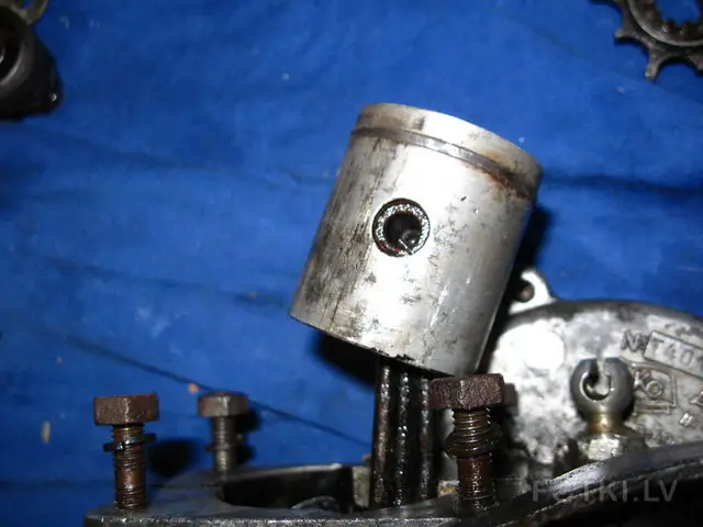

Then bought 1961 year engine, in pretty bad condition:
sbech
Jan 7, 2011
61
Latvia (Europe)

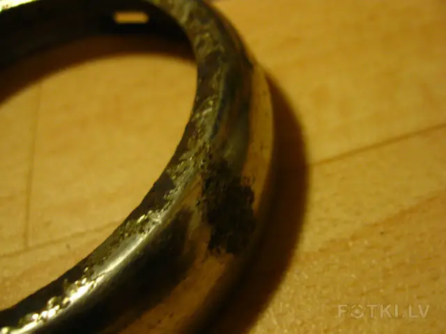

Engine cleaned, re-assembled, rusty bearings changed to SKF.

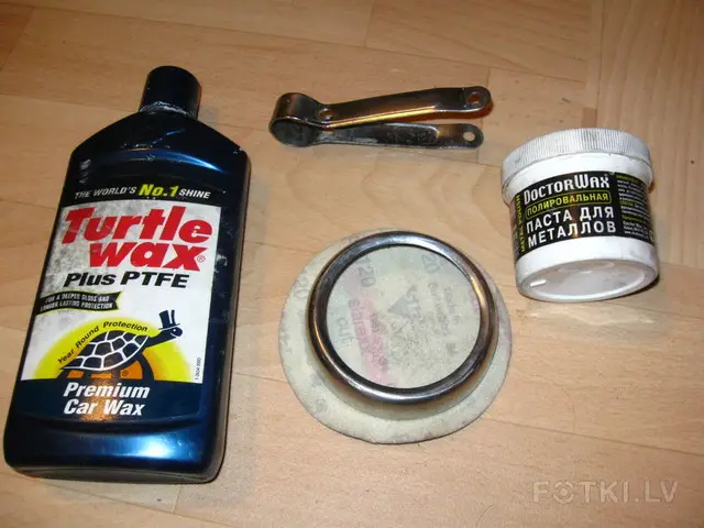

Brake drum cleaned, polished

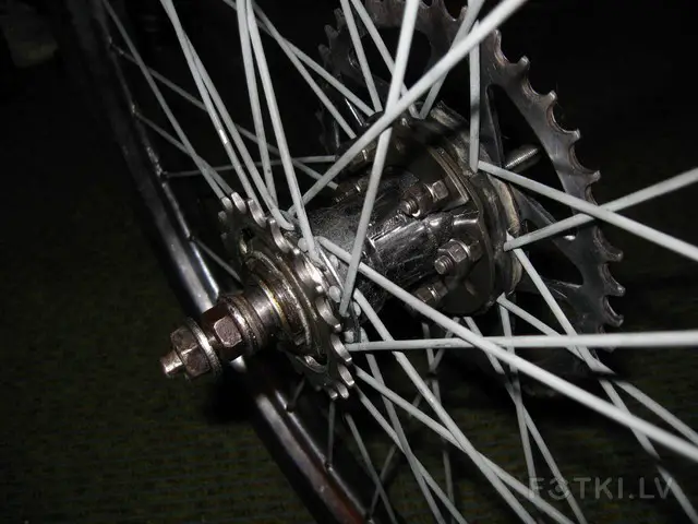

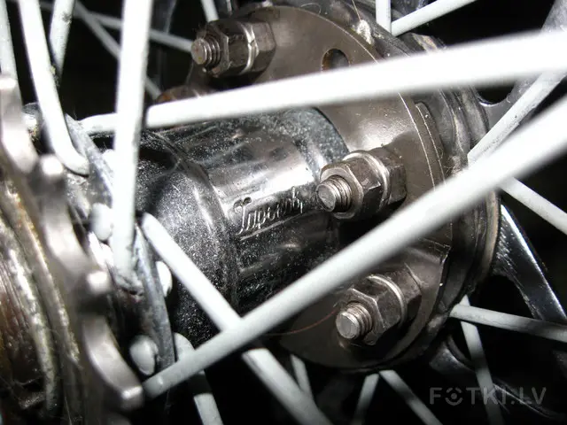

Spokes cleaned in citric acid:
then galvanized and wheel assembled:
Handlebars assembled, polished:

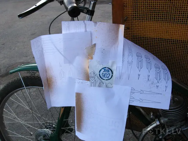

Then gave to painter, paint in special workshop, because I by myself could not gain so much paint cover quality.

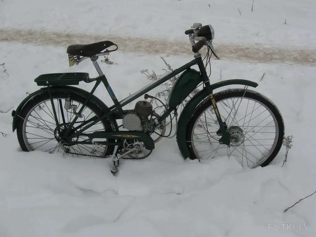

Started to assemble:
Pre-assembled:

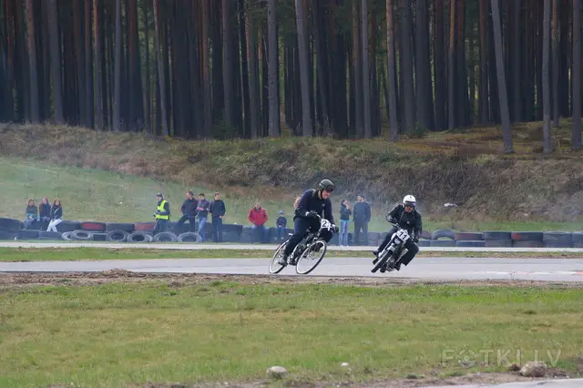

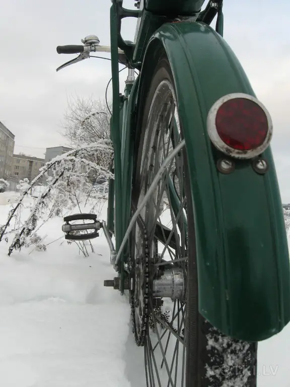

Fastest ride was when using my second vintage motorized bicycle, during retro-moto season start party: :)

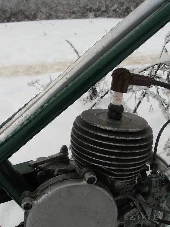

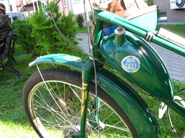

attention to detail
80% of screws and bolts are genuine. 20% left - modern ones, inox steel, abraded for appropriate lookout :) Flashlight wire - with cotton isolation, similar to used those times... Couldn't find cotton isolated spark plug wire.
