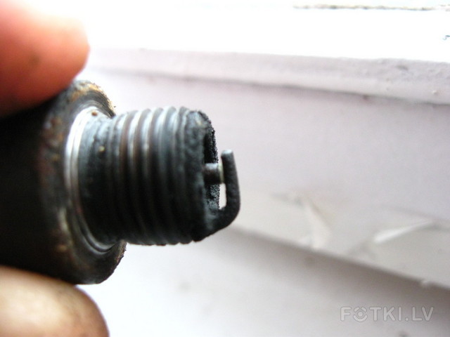

I own several contemporary to motorized bicycle spark plugs.
That one, which can be seen on photo - is 1969 (1960-something, well, dont remember exactly) "A11У" spark plug.
What can I tell about it...
It is quite "hot" spark plug, made for low-forced engines, such as D4.
Soviet mark "A11" means similar like Bosch W9AC. Dont remember exactly, what means "У" in mark, it is either material "uranite" or something about wrench size.
16 mm wrench, 14х1,25 мм
Made by factory in Ufa city, factory, seems, is still alive: ÓÀÏÎ - Óôèìñêîå Àãðåãàòíîå Ïðîèçâîäñòâåííîå îáúåäèíåíèå - ñâå÷è çàæèãàíèÿ, íàñîñû, ýëåêòðîäâèãàòåëè
Works quite fine, as I can understand.

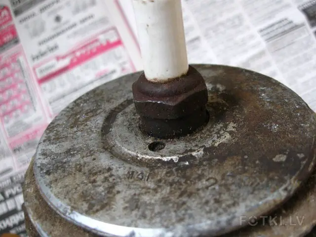

Here can be seen one of old Soviet spark plugs a little closer:

Those old Russian plugs are hard to find. I'd like to find them for sale on eBay, Amazon or the like for the sake of collecting. Very interesting that the Russian plug hex is 16mm (5/8 in.). All the plugs available here have a 19mm (3/4 in.) hex or even 20.6mm (13/16 in.) hex. The link was very helpful, I thank you again.
