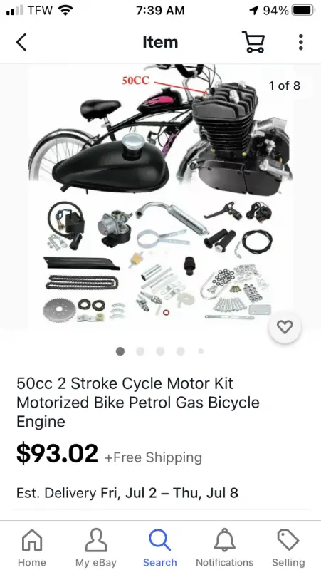

Spend $93.00 delivered for everything you need for a basic motorized bicycle. Then decide what works for you and what doesn’t. I am guessing that for a two mile ride something like this will be more than satisfactory.
