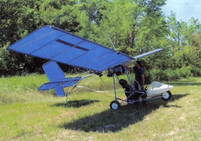

For anyone curious, the weight restriction (USA) for a legal ultralight aircraft is 250lbs dry (safety equipment like a ballistic recovery chute is exempt frm this) so any of the legal ultralights you see weigh that or less.
Yet this doesn't mean yer limited to the flying lawnchair style like my ol' MX, the following (complete w/bouncy landing lol) is a Fisher 202 Koala ultralight made from spruce and dacron (newschool wood & fabric) and has just a 250cc single cyl
YouTube - fisher FP 202 koala ultralight
Now while not as small an engine as the china girl, still... it shows whats possible, I had some stick time in a friend's Koala and it was a fine flying machine. I did wish for more climb, but I'll admit I was a climb ratio fanatic as there was more than one treeline that would try and ambush me as I innocently chased the local geese, did strafing runs on oblivious cattle, and generally trying to annoy as many golfers as possible :D
The closest to the china girl engine capabilities I've been able to find so far while still limited to "normal" construction materials are some of the earliest ultralights, foot launched and sporting 10hp(ish) chainsaw motors, like the Easy Riser;

Back in the early days of ultralight flight it wasn't uncommon to see 250cc single cylinders in ultralights...
But that was scary as ****
You probably could fly one of these engines - but there's no way you could take off or climb. The best you could hope for would be to prolong a glide in a very slippery glider.
My Quicksilver MX had a dual carb, twin cyl Rotax 440 @ 40hp+ (w/a triple bladed carbon adj pitch prop & a few other mods) to give you an idea of what we're talking about. Although considered overpowered (engine for a 2 seater in a single seat plane) I found it to be "adequate" for the bush pilot style flying I was known for. :D
Long long ago in a land far far away I taught myself to fly in an Eiper MX that looked a lot like that one. seems like it had a Rotax 370 something engine. CRS

Nice Elmo - the MX is a true classic, I do miss mine. Eipper Formance? Earlier than mine - an original. The poor MX went through a coupla different companies once the "rush" of the 80s was over but unlike so many others - still exists today :D
