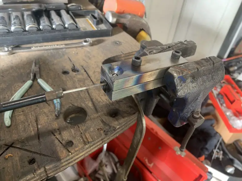

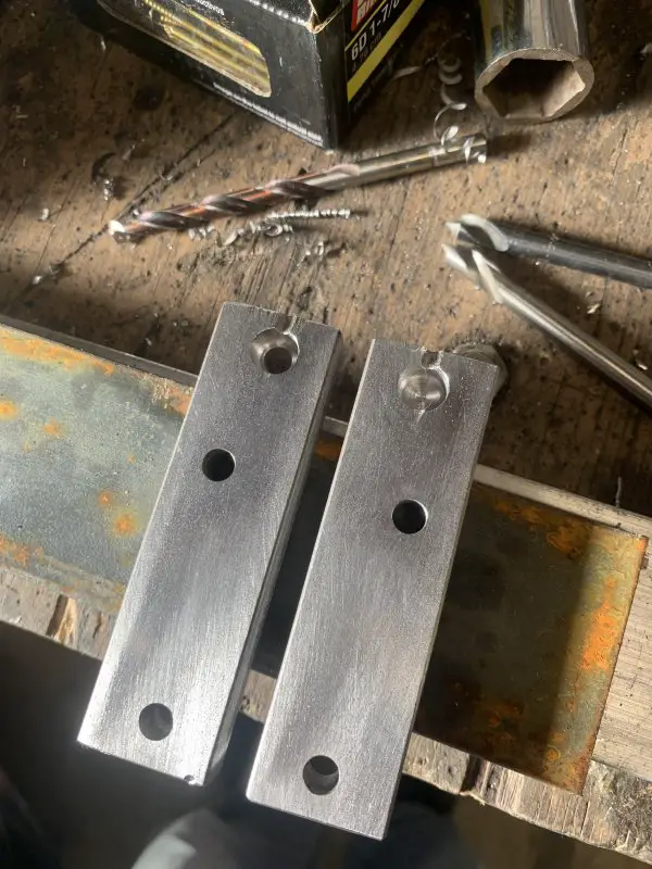

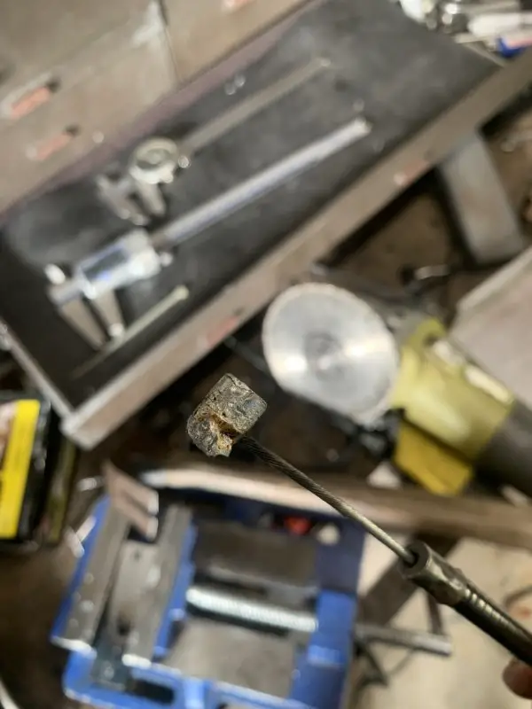

Well I broke my brake cable a while ago, fixed it with a disposable mold. The cable pulled out after a month. Thinking I didn’t fray it well enough. Made a 2pc mold, didn’t have enough lead however. Worked out though
I like the mold you made Tony, but lead, even wheel weights alloyed with antimony is not hard enough as you have discovered.
You being in Cali. likely have Zinc wheel weight sources. Cable ends are cast zinc.
Preheating your mold will prevent the casting from having "knit" flaws. Looks like you have that figured out.
This vid is kind of windy but once the casting begins is not B.S.
Finding Zinc at home - Zinc for casting - Pouring Zinc metal bars and shot - YouTube.
