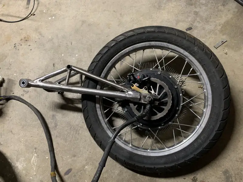

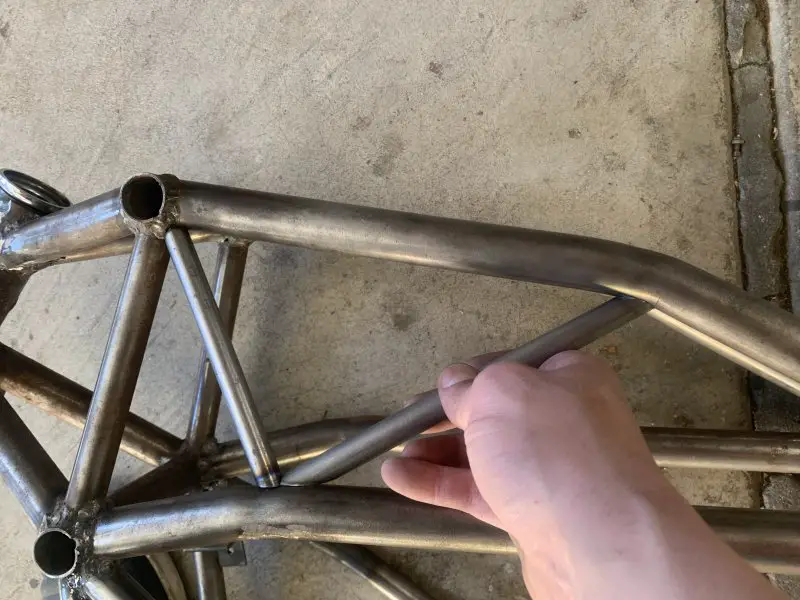

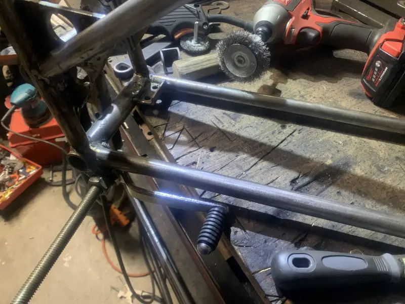

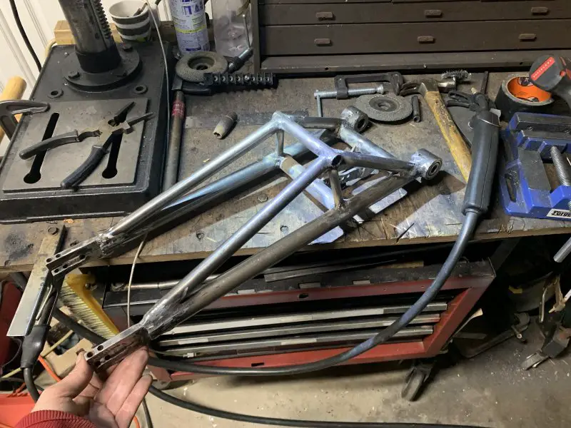

Been working on the odds and ends now. Decided my swingarm could use some triangulation cause those twin 1x.065” tubes didn’t seem too strong.

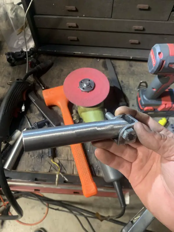

Repaired my kickstand to have that snappy lock at each end. Just had to move the bolt for the spring further from the pivot.

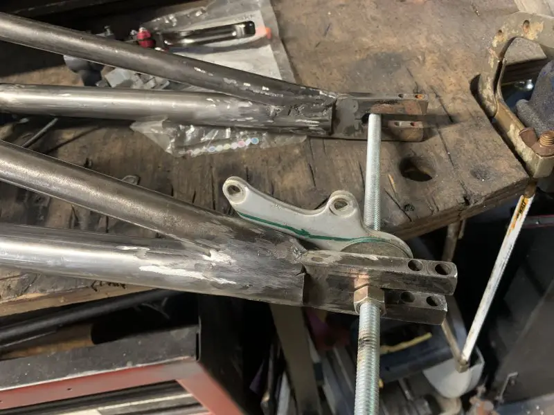

Going to register this one as a motorcycle so I need a working rear brake. Got this caliper off Amazon for $8... found an old mongoose suspension frame rear end for the brake tabs and an old 160mm rotor..

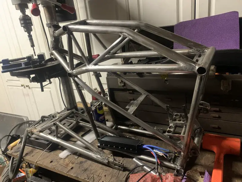

Fabbed up my upper frame triangulation tubes. Big job in itself. Tacked em in today.

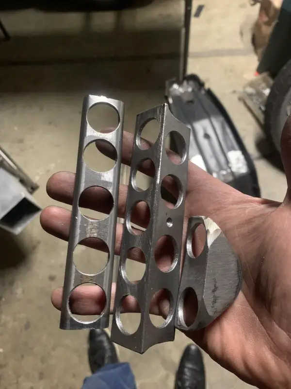

Fabbed up footpegs with swivelling mounts.

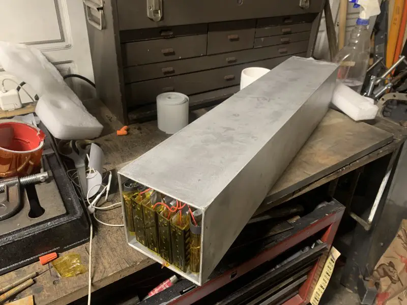

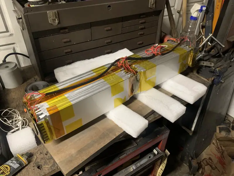

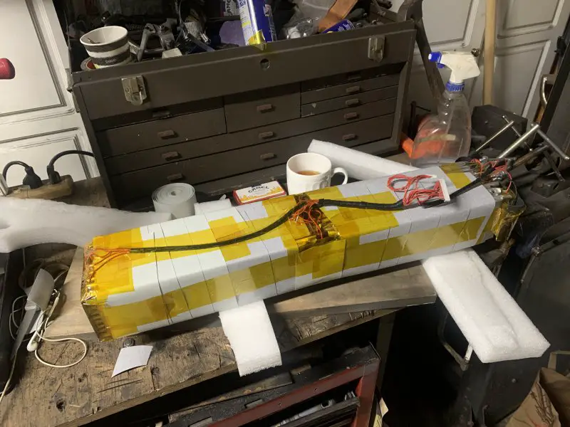

Wrapped up my battery in fish tape in preparation for fitting in the box. Did a test fit. Drops right in and fits flush on the end!

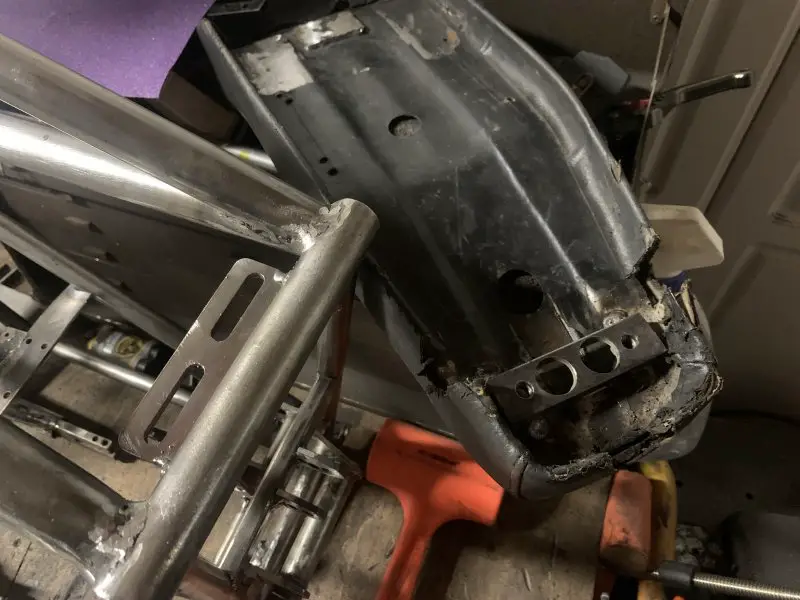

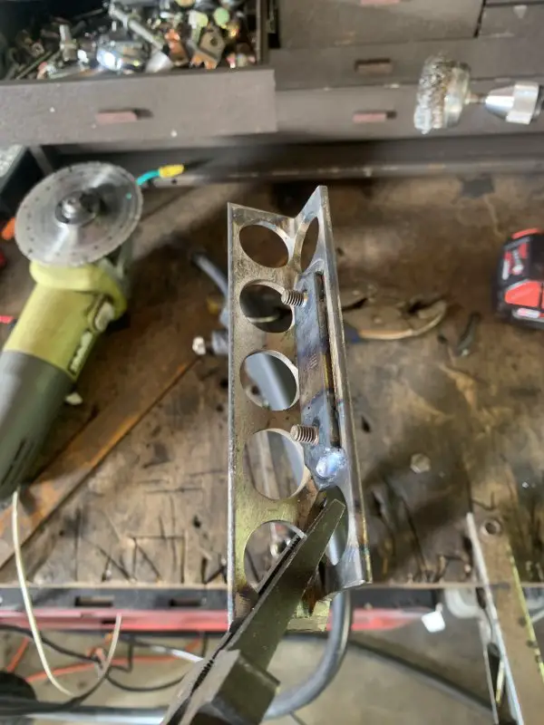

Seat mount front- piece welded to underside of seat is C-channel with 5/16-18 nuts welded on inside. Frame front seat mount as you can see is a piece I got laser cut for some other job that I never used. That was a quick little job.

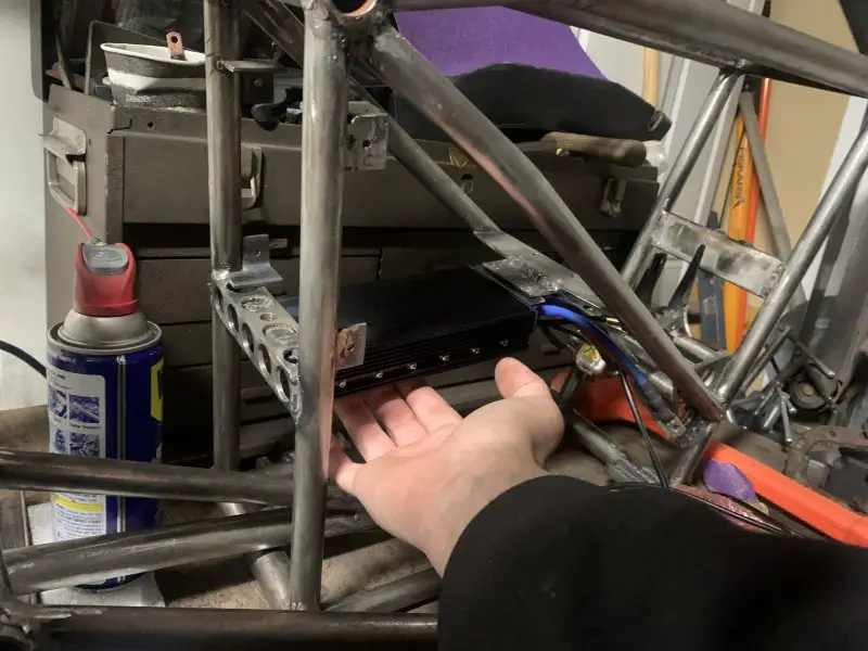

Here is how the controller will mount. Behind it will be a terminal block for battery and motor phase wire connections, and you can see the J1772 mount near the rear.

Got a lot done this weekend. This morning was the last of the frame fabrication and I had to decide where some components would go. I didn’t want to decide how the rear of the seat would be supported so I just welded in some tabs to bolt the supports to so I could get on with finishing the frame.

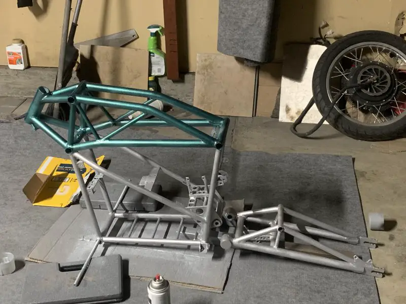

Ran out of the green paint. Can’t find it for sale anywhere unless I buy six cans for $100 including shipping. I’ll wait for it to come back in stock and give another coat in a few months or whenever.
All rust-oleum coats were 2x self etching primer, 3x filler primer, 2x metallic textured 251053 silver, and one light coat of racing green metallic 7252.

Triangulation = strong and rigid. Every post is a fab mind blower.
Thank you Tom. I try. But this is the last time I do something as unique as this. Each tube on each side of this frame is unique. 11 per side. Mirror image of the other side. So 22 unique tubes for two sides. I’ll do another tube frame but will design for more like tubes to reduce fabrication and hand fitting time.

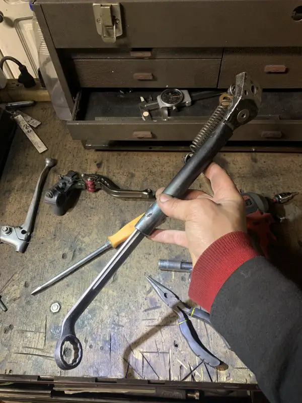

I got a long kickstand on my bike because it's top-heavy. The bottom of the kickstand is an old jammed-up ratchet wrench.
