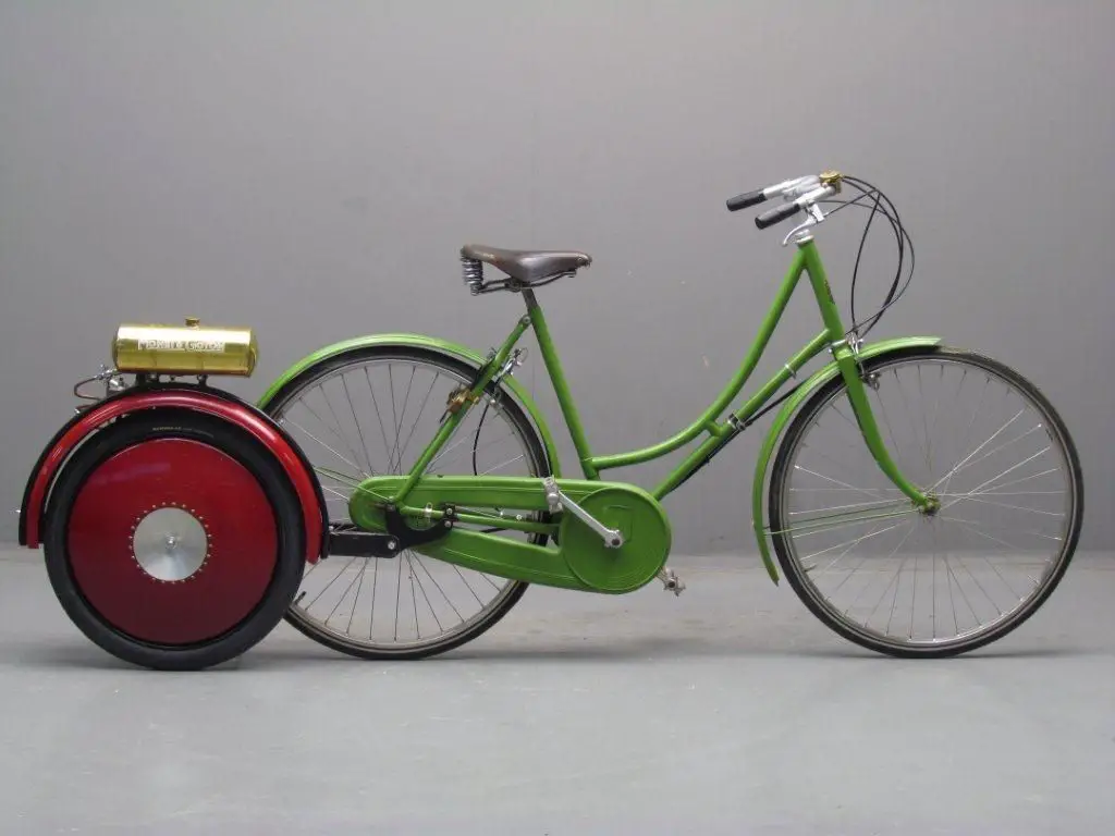

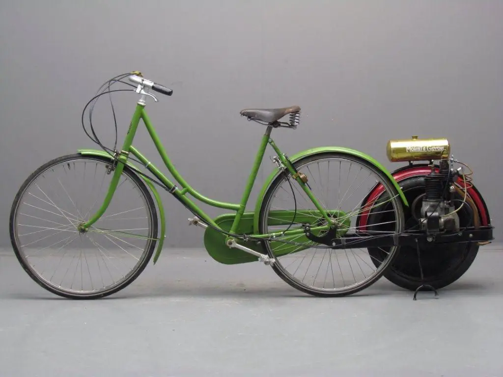

As many of you know I like French cyclecars, Velocars, bikes & etc mostly because of the principle that, 'The French follow no-one and no-one follows the French'. That's not an original Intrepid quote by the way, I got it from the Cyclekart Club forum. Getting back to the topic something I did not know was that Monet & Goyon (one of my favourite French makers) made a motorwheel.

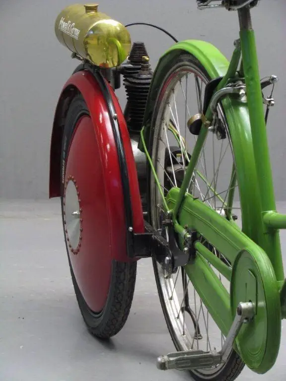

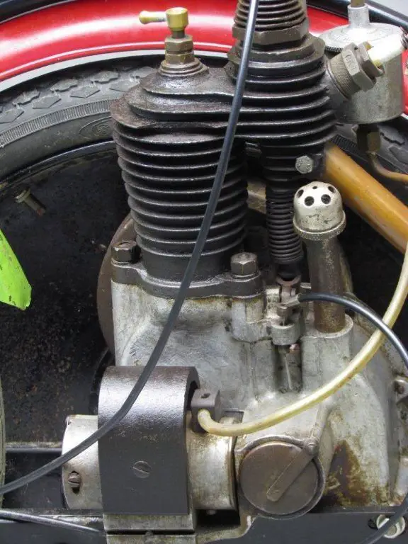

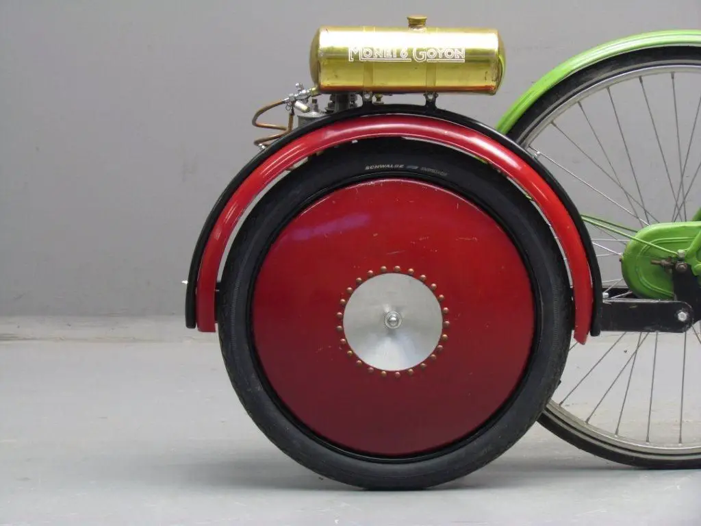

Doing my best to ignore that distractingly beautiful green bicycle I soon noted that Monsieurs Monet & Goyon had taken a very different approach with their motorwheel and what's more I liked it :)
Really is cool Intrepid!
I really wanna do one like that with a gokart sized drive wheel with a CVT.

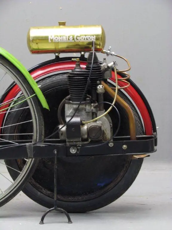

Came across this and thought of you. I'd love to take a vertical briggs, re-build it to run horizontal but with the vert base and build one of these.
I would love a fuel tank like that for my Pig. Much as I hate French cars, this is a very beautiful bit of vintage engineering and typical of your good taste I.W.

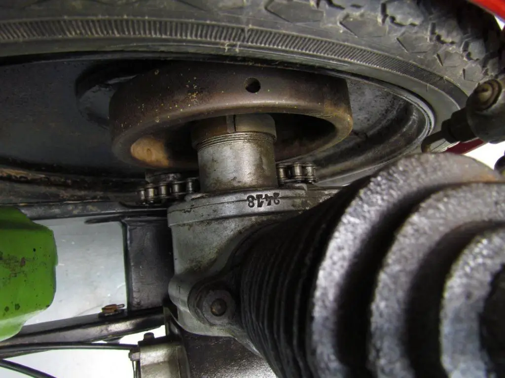

I'm not sure that direct drive is going to work. The original motorwheels always had some form of reduction gearing which was most commonly driven off the camshaft as the first reduction stage.

I'm thinking using a jackshaft between the motor and wheel to get the needed reduction.
A couple nice old pillow blocks with brass oil cups, a nice vintage looking clutch, a couple sprockets....you could have a bunch of vintage whirly bits exposed for a nice mechanical look. I'm fairly sure someone with your impeccable taste in machinery has something suitable and beautiful laying about somewhere I.W.....
I'm thinking lots of brass cups and maybe some copper oil lines with a old time clutch driving a chain or belt to the spacesaver. Hide the ugly wheel with a vintage looking disc cover or possibly cut out some rim openings to disguise it.

Maybe some kind of friction with a rubber roller on the engine shaft running on the lip of the rim to mimic a gear drive on the internal surface of the rim?
Several old motorwheels used this kind of internal rack drive.
