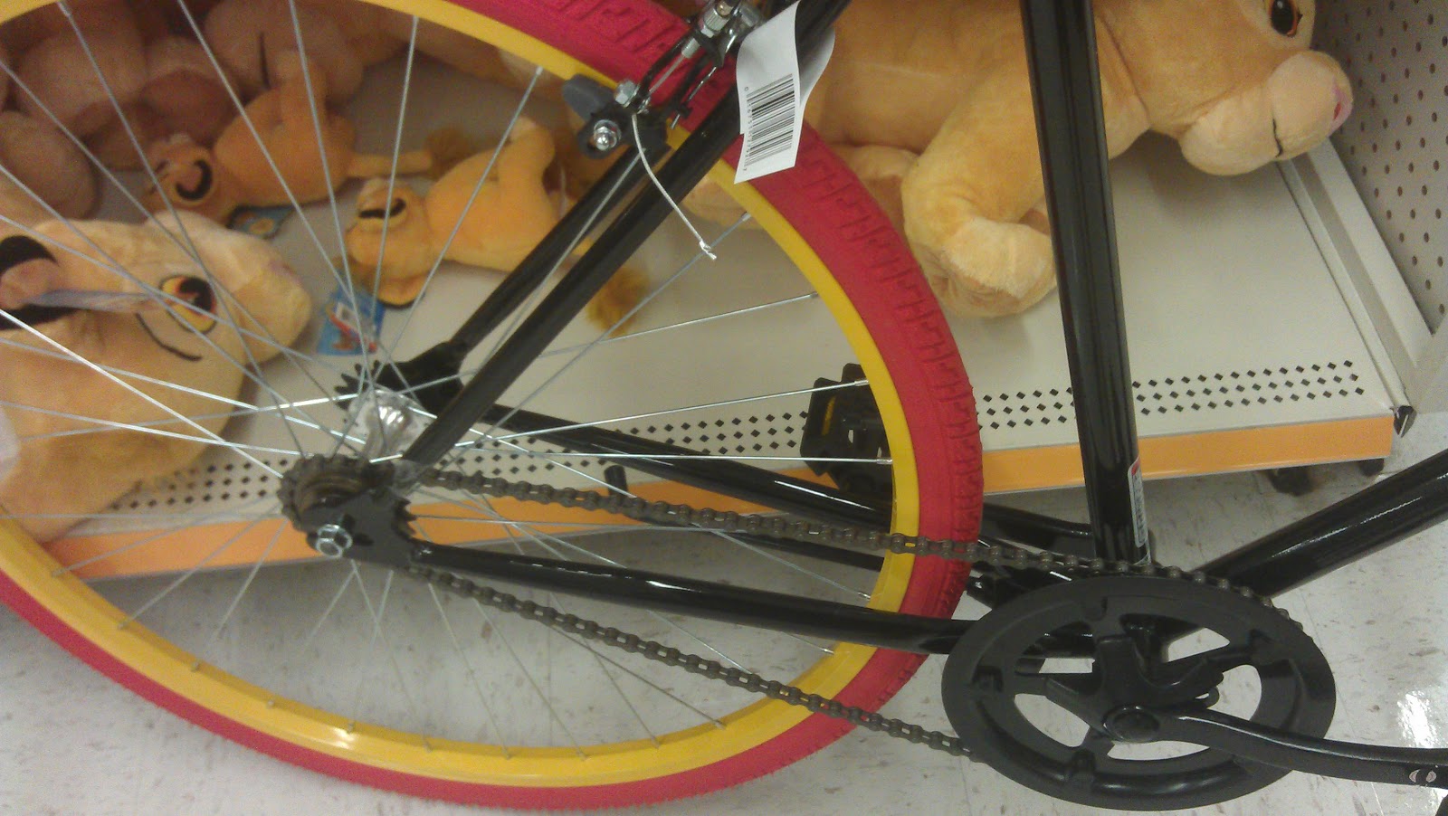

Yeah, that really caught my attention. Love the space and the price- It's $99. Not sure about the wheels strength wise though- I think there are fewer spokes. I could always change the handles bars later on... I saw it today while at Walmart.

From what I can tell from the very few pictures of the thruster fixie online- it looks like there are sprockets on the other side of the hub. This would be a good thing yes? Meaning I could attach a large sprocket to the hub directly, maybe?
I think I'm leaning towards this bike for the frame and the back wheel. I'll take a closer look at Wallys tomorrow before deciding.

I was just wondering: is this bike a true "fixie"? Isn't motorizing a fixie bad, unless you add a freewheel sprocket into the mix someplace? Won't the pedals start spinning like eggbeaters once the engine kicks in? Just wonderin'.

**** AW. I knew that and forgot that... hmmm I might not be opposed to adding a single speed freewheel to the mix since the other side will still be fixed right? It does look like a flip flop hub- I think.
Where I live it's pretty much all flat and am not planning a move anytime soon so I'm not worried about other speeds. My 150cc scooter passed away last month and twice I had to walk it home quite a distance before she finally gave out. As long as I can pedal her home I'll be happy. Plus I'm not in a mad rush so modding time isn't an issue.

I'll edit here since my pic posts haven't posted yet then I'll run silent. Promise. From what I can tell this is a tamed Kent Takara Kabuto fixie selling for 199+ minus the drop down handle bars and souped up pedals. Not 100% sure. I'm off to Wally this morning to pick it up. Will switch out the cheesey brakes for some I took off a trek a few years ago and start modding away!

Couldn't I add the single speed freewheel pedal-side and leave the fixed sprocket drive-side and add on an adjustable sprocket tensioner pulley via an attachment plate to the stays?

Good news here. One side has a freewheel and the other side is fixed.

I'm in the process of mounting the engine, Know that apparently the rear hub maker Quando is thought to be crap among other bike users. I had all kinds of plans to do this and that to fix the sprocket to the hub. Ended up going all JB Weld on it's arse- plus some extra.
http://motorbicycling.com/f3/flip-flop-locking-question-33375-2.html
