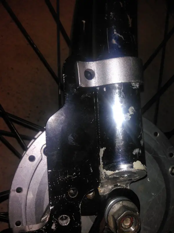

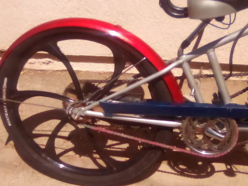

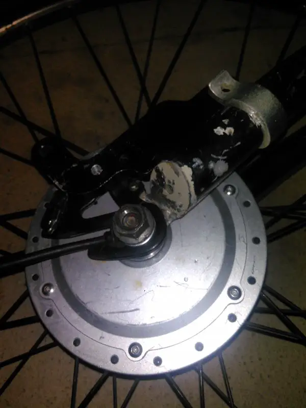

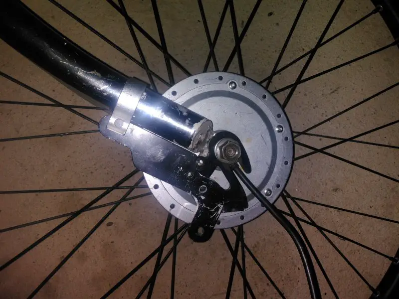

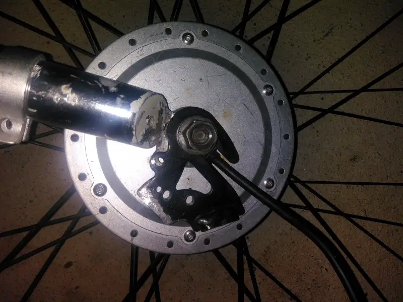

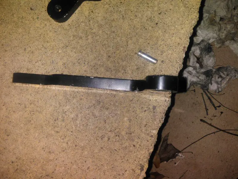

Going through a friend's bik fte pile I came across an old scooter that had the washer stays that fit in the bottom of the dropout slot and the folding mechanism that allows the neck of the scooter to fold down fight against the deck, yielded two perfect pieces of 1/2 inch thick aluminium that fit nice and flat against the fork.
I just gotta bolt the arm to the dropout and strap it and that's outta the way.
It's so close I can almost taste it!!!

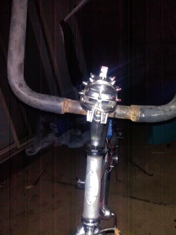

Need something like that on my cane if it’s light and small. Lol
Do you have access to a 3D printer? If so I found a website that has all kinds of stuff.
Emblems, bike badges, skulls and daggers, knuckle duster... Even snake heads like we were talking about on the other post.
I don't have a link to it immediately available but I will post one asap if you are interested.
That would be cool on top of a cane.
I'm kinda torn between putting it on a cane or on my bike but because of the lack of high quality parts and lackluster paint job, I think I will put it on my bike to make it just a little more attractive.

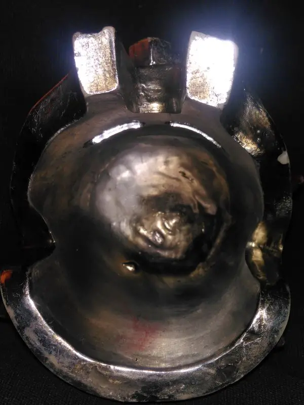

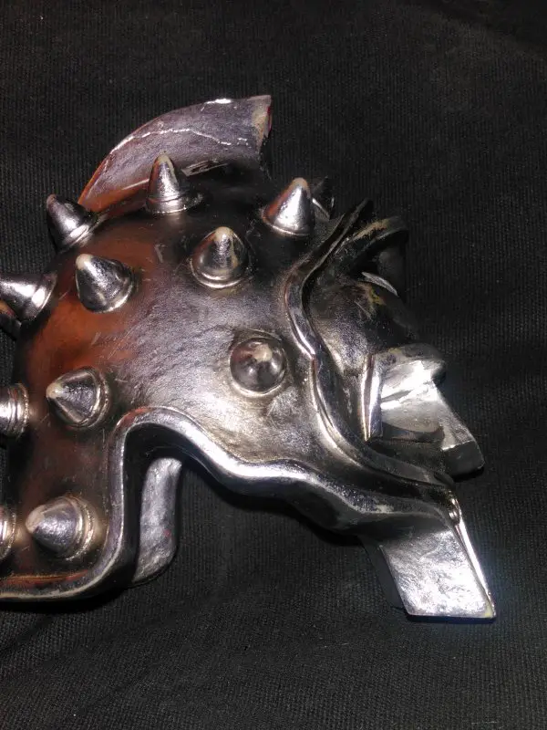

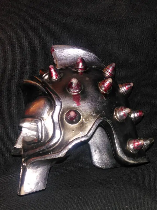

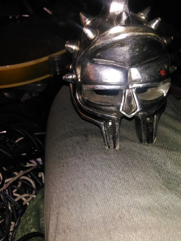

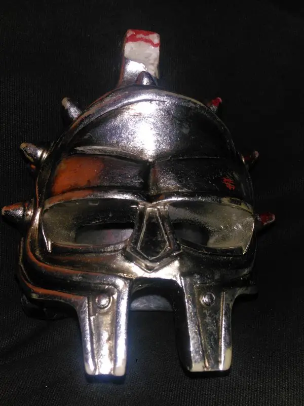

Oh and by the way that is a fish aquarium decoration you can go to your local PetSmart or pet warehouse store and find a bunch of this stuff. It's a hypoallergenic resin compound. I think it would probably be more advantageous to print it 3D because you could choose what type of material you made it out of.

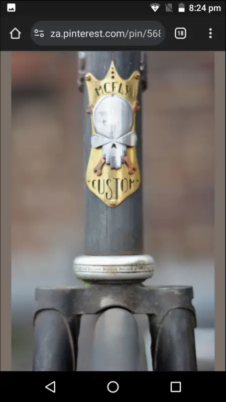

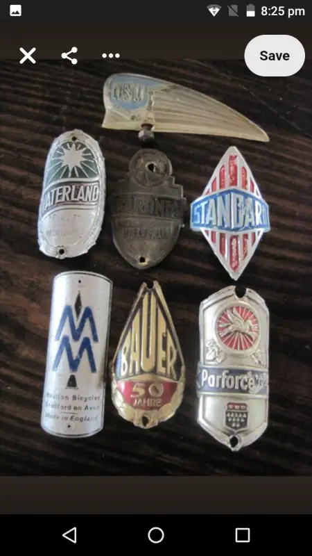

Grabcad.com and cults3d.com and yeggi.com are where I found a lot of really cool stuff

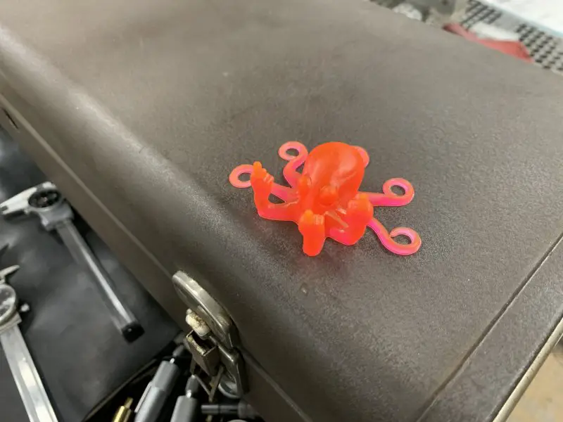

Yeah my old coworker had a 3d printer. He printed this fckofftopus and had it waiting for me on my toolbox when I ditched work after Valentine’s Day (^)
Lol that's freaking awesome!

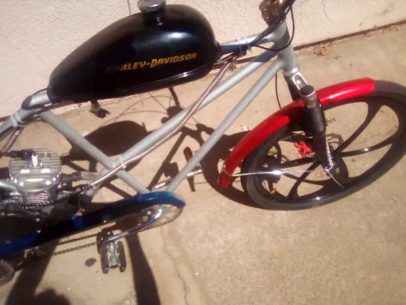

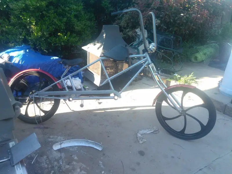

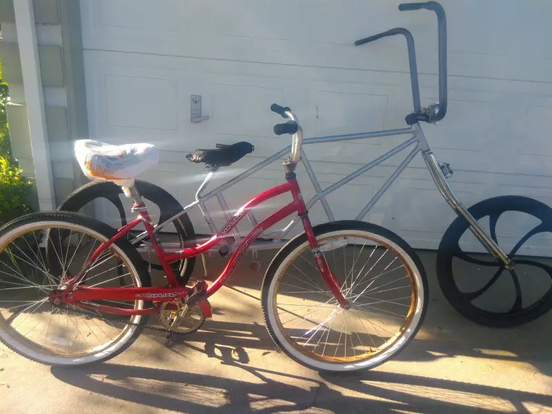

A friend gave me a pair of Harley-Davidson ape hangers.
As you can tell the bike is rather long. The one sitting next to it is a 26 inch females bike.
I kind of like the way it looks.

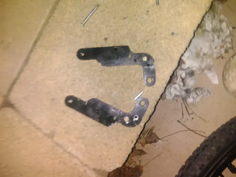

Besides the OEM rivets possibly popping off
It's the fender L bracket that cracks and breaks. Then the fender catches the wheel.
As fender wraps around the wheel the U brace wraps around the axle. It then wedges itself into the wheel causing the rider to fly head first over the handle bars,
Replace the fender L Bracket with a stronger L bracket and or add an extra U brace
Older Bikes made in USA used 2 U braces on each fender so if the fenders mounting brackets broke the fender wouldn't hit the wheel

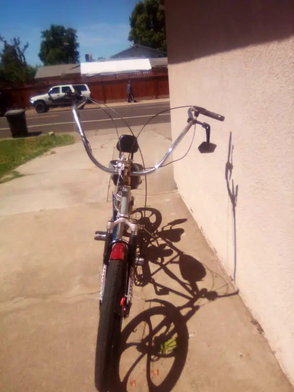

Yes wrench, thank you sir. I am using 2 solid rod fender supports that are bolted on to the frame itself with nylon nuts and locktite blue and Im not using the flimsy lil "L" bracket. its getting its little rivets cut off... heehee.

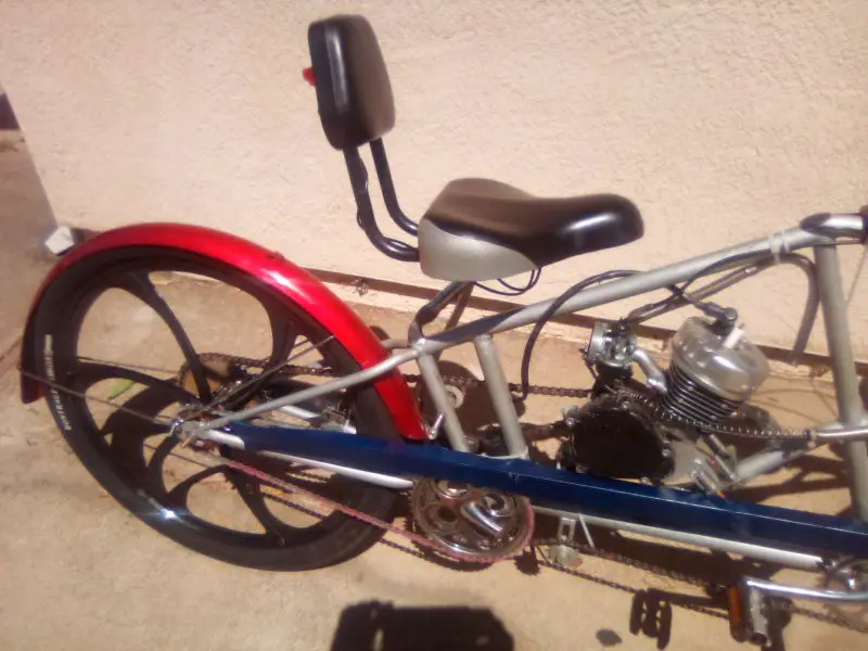

I will post more pics tomorrow. I have all the cables and a 4 liter gas tank and the chain, turn signal horn and headlight switch on. I also took a low profile 18 volt drill battery and modified it with quick release stereo speaker wire connector for the light system. It works pretty darn good too, with the LED light I let it burn headlight and tail light until it went out and got 17 hours of run time.
tho, I am having a bit of trouble placing the stock chain tensioner without it interfering with the chain due to the diameter of the frame tubing. I have a case mounted tensioner that I might switch to but because of the length of the chain and sag... I think an extra helper wheel would be adventitious. it took a whole chain and about 1\3 of another full length chain to make a complete loop. and I am running motorcycle chain so its kinda heavy.
but EVERYONE who sees it is like "DUDE. BAD AZZ BIKE!!!... =}}
I wish the frame were lighter because with the electric front e hub and battery to run it make the bike SUPER HEAVY.... which is a stopping hazzard waiting to just happen.

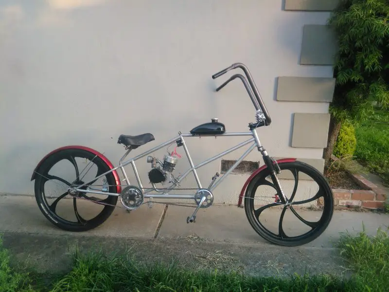

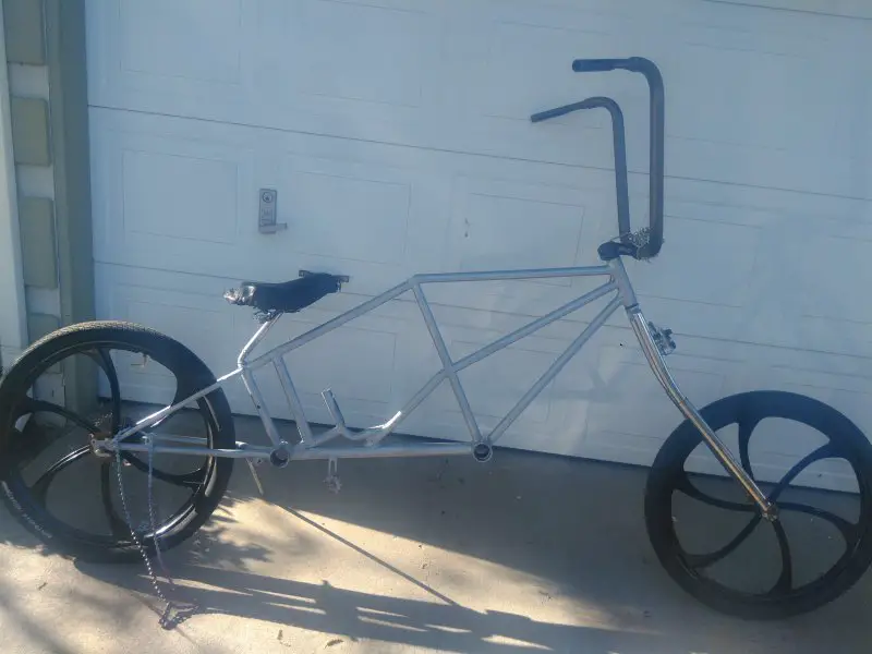

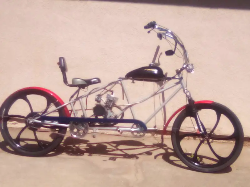

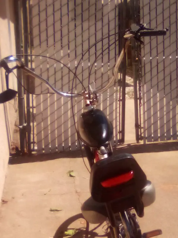

I have a little more paint and trimming to do but this is basically what I ended up with.
I will give better pictures when I get it finished. But it rides smooth as butter!
I am very happy how it turned out. It's one of the baddest bikes in my town.
