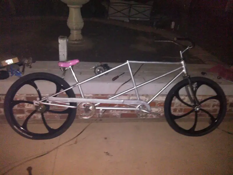

The random tandem thus far
Wevil Kenevil

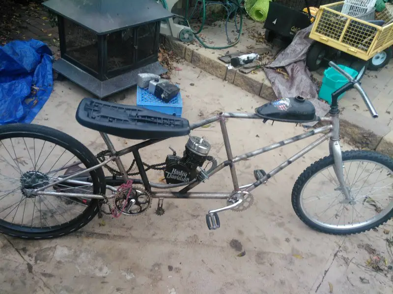

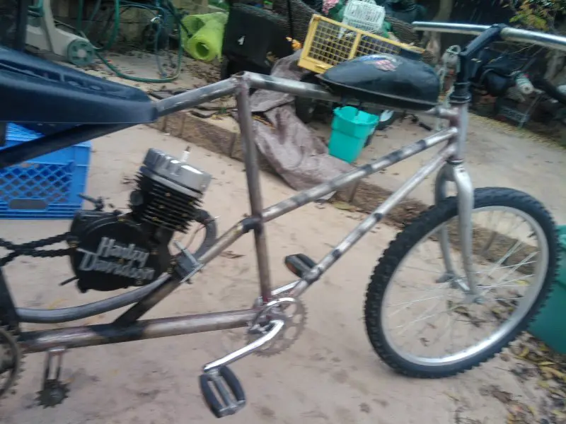

It's creeping that way. I'm leaning towards this 50mm 100c builder I have compared to the yd no head I got.

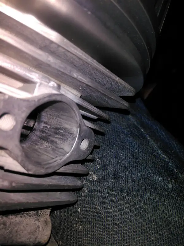

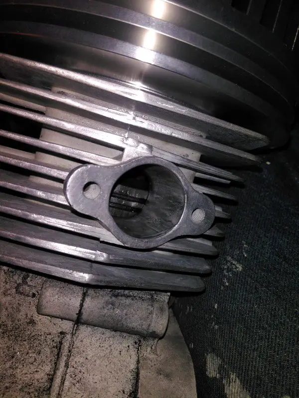

What to do about the exhaust port being so freaking big with such a small face?
Thinking of viper flex pipe with a baffle no muffler and an insert bolt on collar.

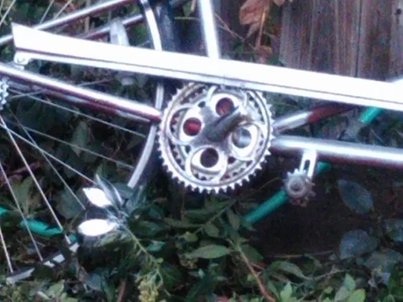

Oh I decided to keep the front pedals and sawn off back crank pedals config.
Kinda okie but so am I!

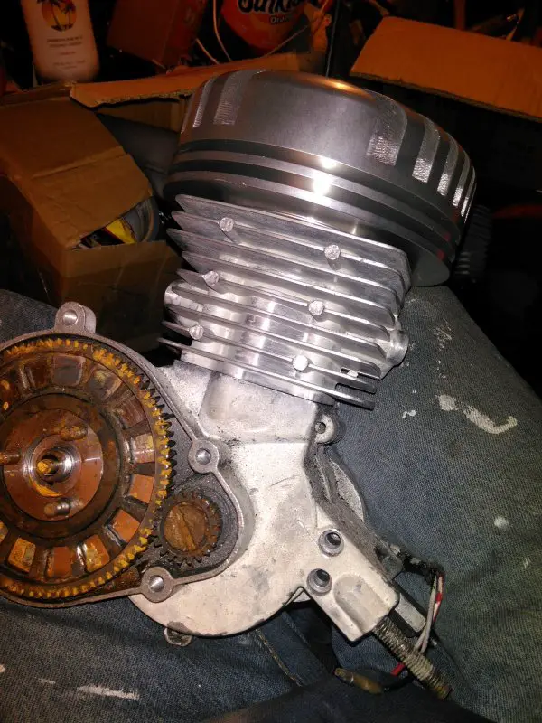

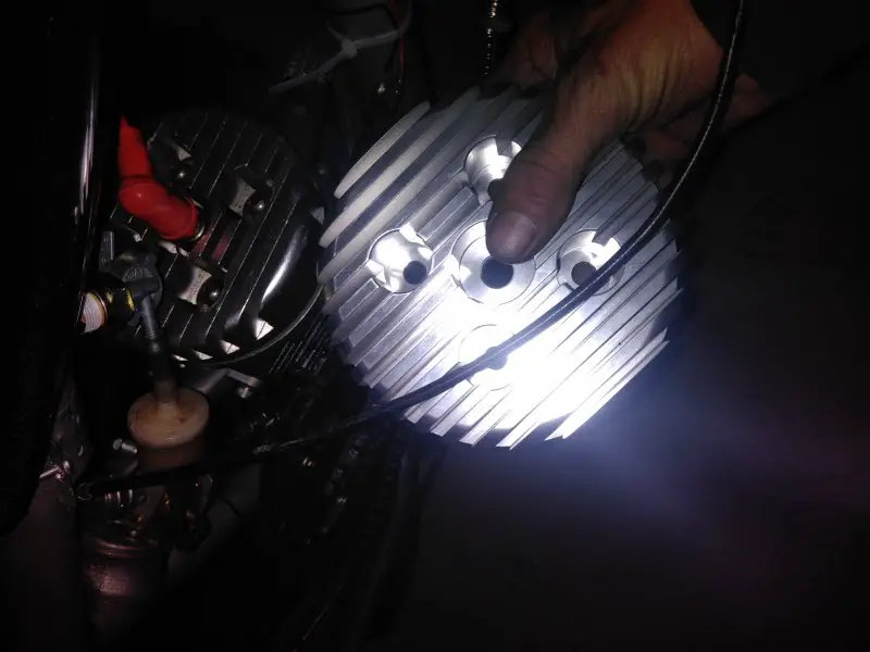

I mean look at the size difference in the head.
It's 1/3 bigger than a normal 800cc.

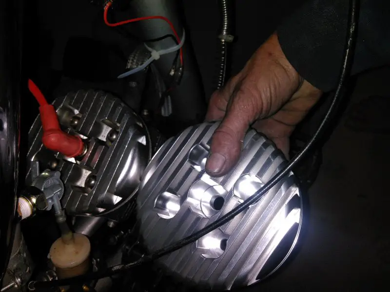

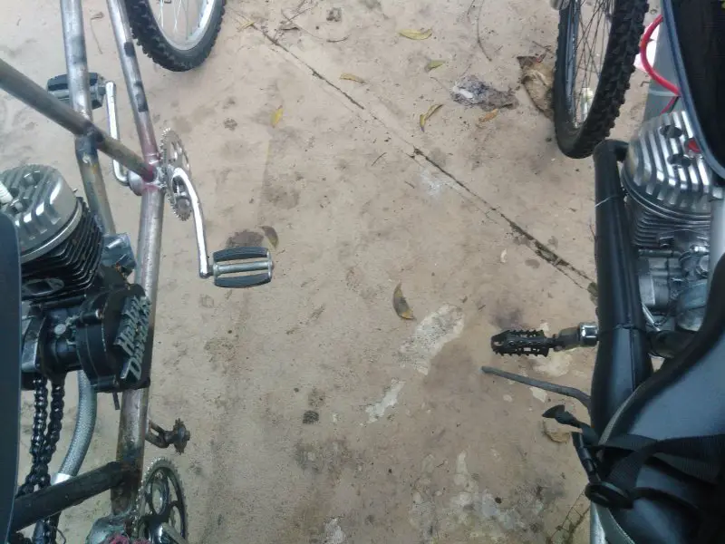

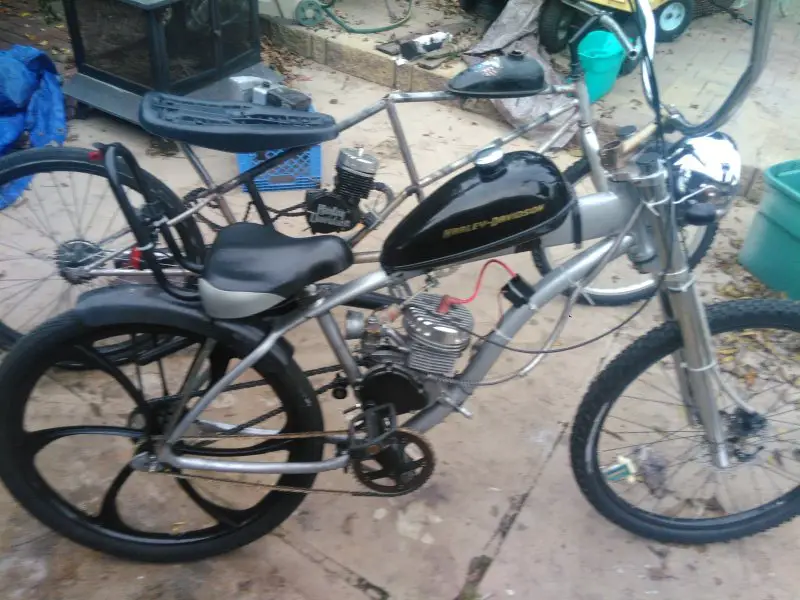

I couldn't stand it and put the motor that I'm going to put on this on my other bike this is what it looks like.
The last picture with the two bikes I was trying to get a comparison picture on the size of the heads.

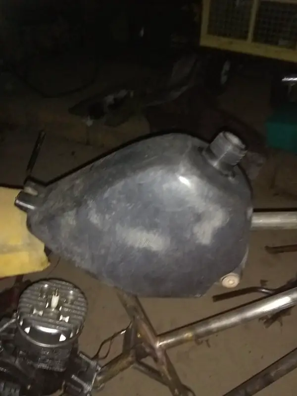

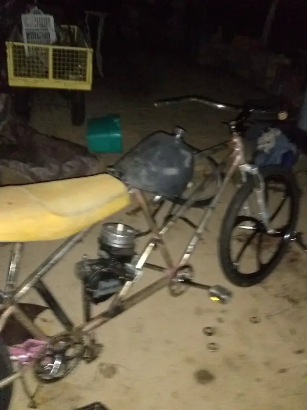

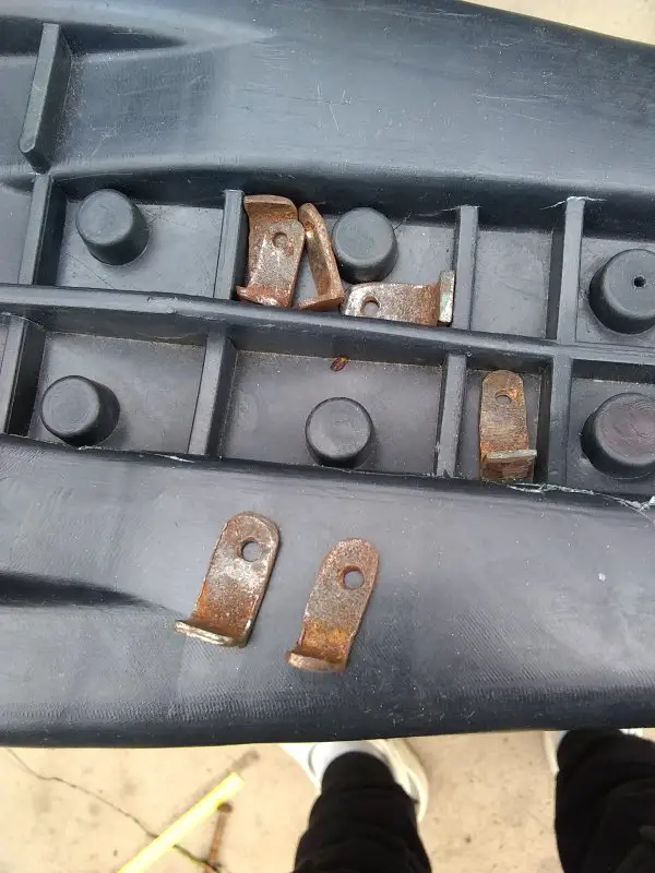

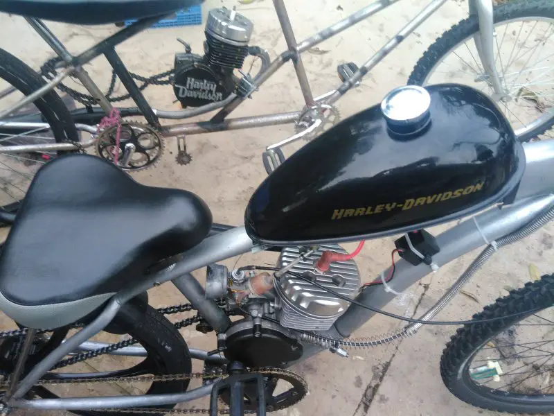

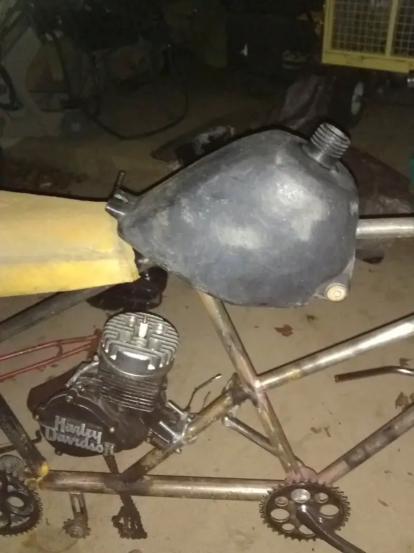

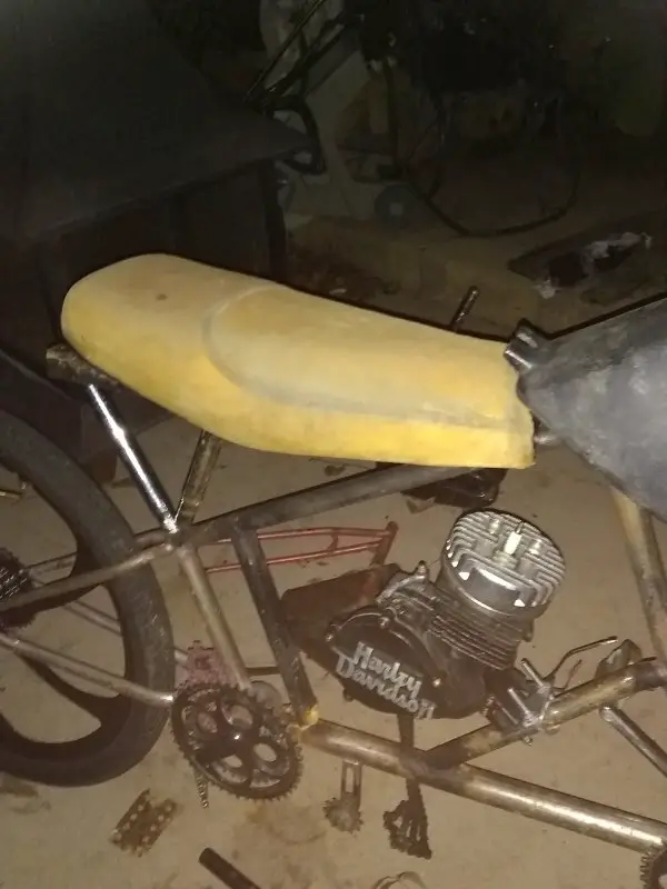

I got a seat and gas tank for bike.
I have to recover the seat but I've got plenty of leather that I got from an old leather couch that I can use.

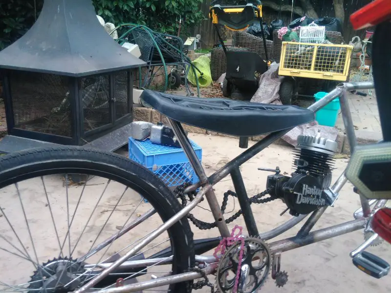

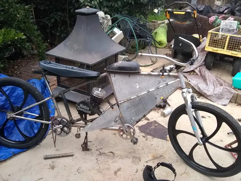

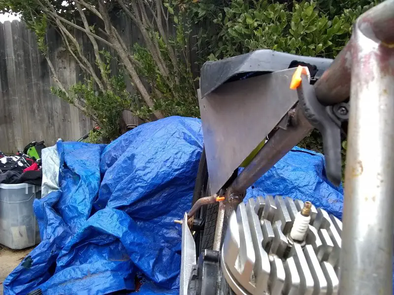

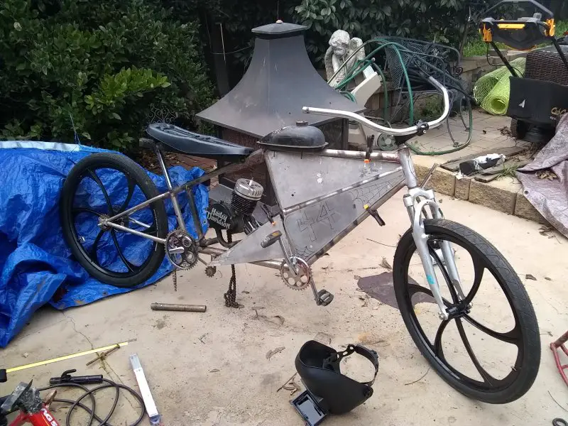

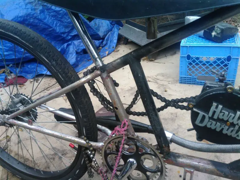

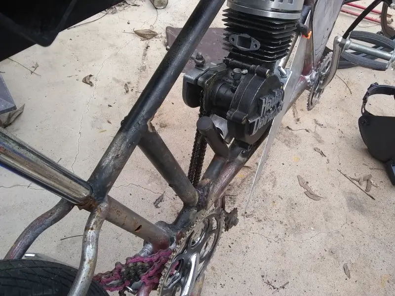

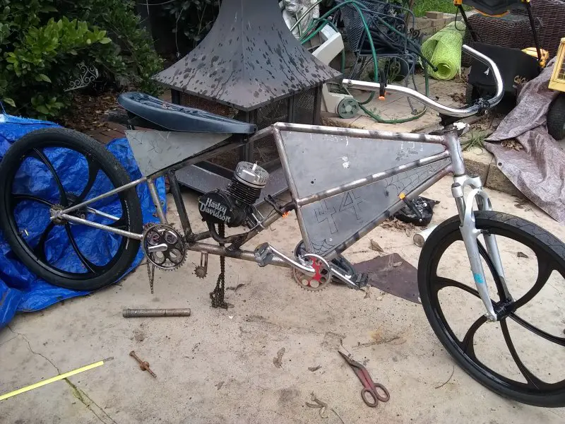

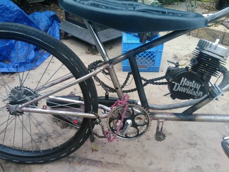

Got the motor mount installed today...
I think I am going to use body panels with spiderweb designs cut into them or something. Red on black Munsters style... Idk.
Plenty of room for the carb.
Made brackets for mounting the body plates out of old bed frame ...

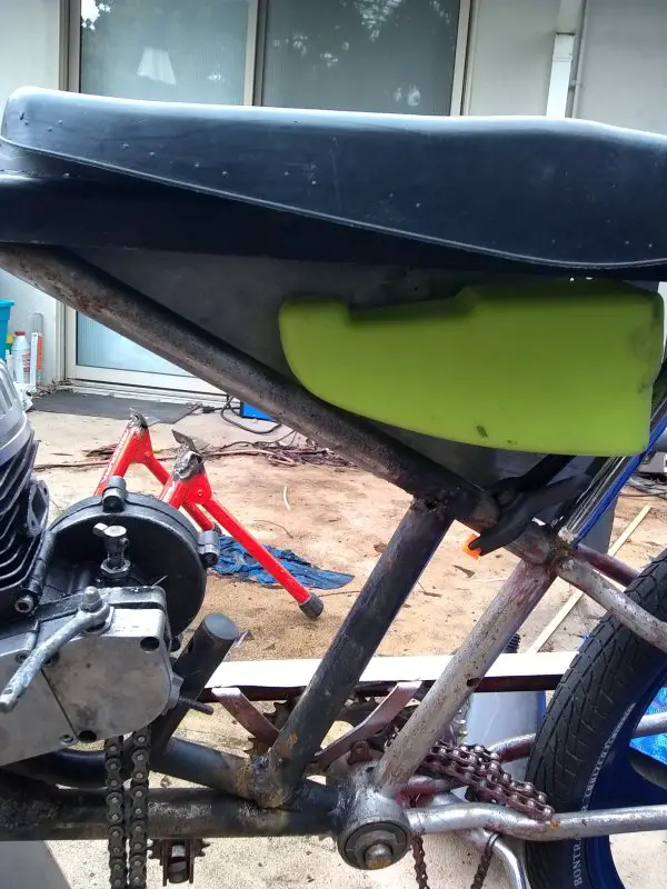

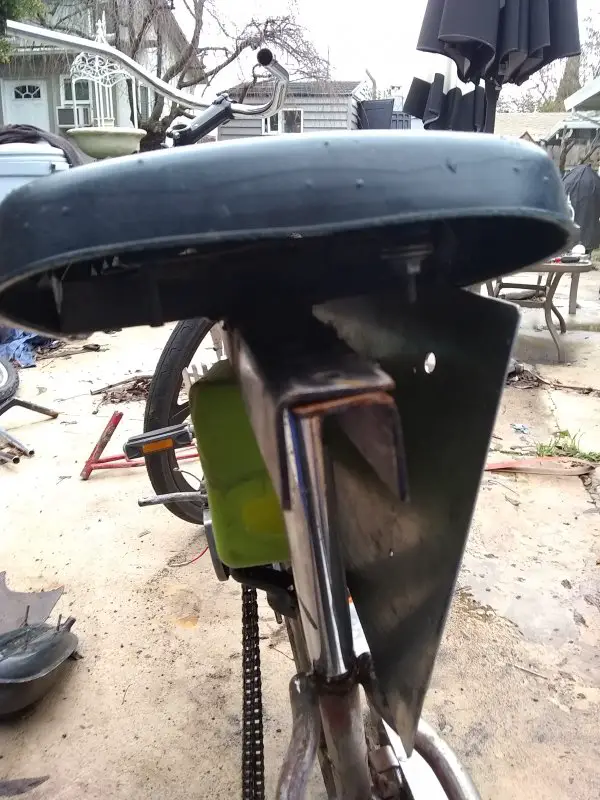

I did decide to put the gas tank under the seat and tuck it out of sight with a couple flat panels. A weed eater tank will fit nicely inside.
The green thing is for fitment...

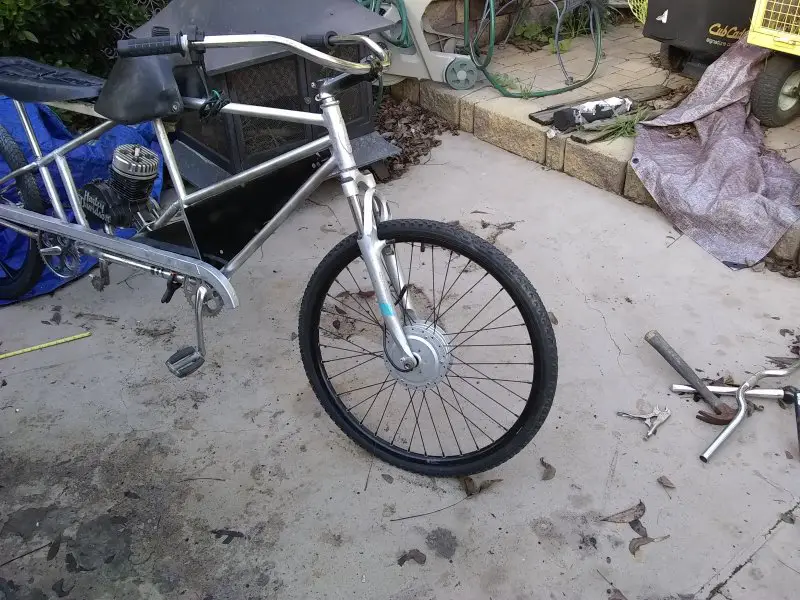

Got the e hub on now I am waiting for the control unit...
Something I learnt about front wheel e hubs from reading forums here that probably saved me from a potential wreck.
Don't use a pedal assist control if using a front wheel drive hub because it will cause you to wreck by engaging at the improper time.
Thank you to all who discussed this topic on here.
I know it may seem trivial but on this bike that I'm building I would hate to wreck on this thing is so heavy it would be catastrophic
Holy smokes.. I didn't know the can of worms I was opening when I decided to add the electric front wheel to this project.
It's not plug and play... It's Torque arms and brake adapters, control voltages and chargers and...
Instability and all kinds shhhtufff
I am going see it through. But damn I will make sure what's what next time.

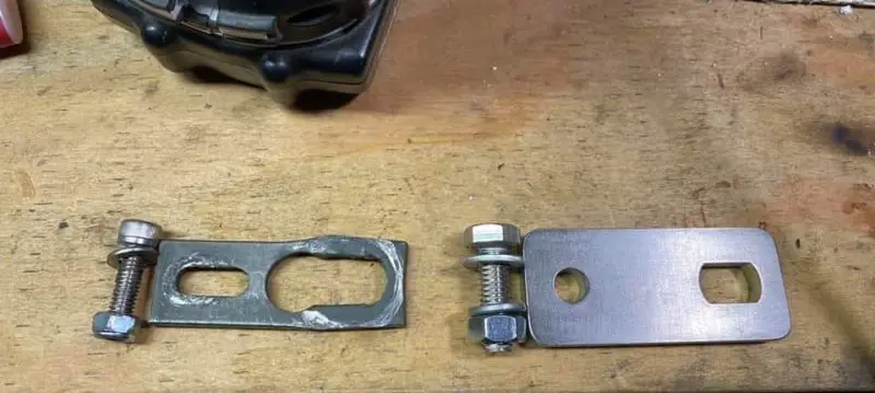

I'm cutting my torc arms (2) out of leaf springs, it's just taking a while to file the inside holes out to exactly fit the axel. I want that to be as precise as can be.
Because of the way that the bike rides and how heavy it is I definitely do not want to wreck this bike. It wouldn't be pretty.
Grin technologies makes a good set of TAs for 16mm axles with 10mm flats. Those are stamped probably. You could get them lasered to your spec and they’d be dead nuts for about $30 from sendcutsend. I got these to sell as upgrade for a production ebike.
Makin em yourself is fine but they’ll never be as good as a laser.

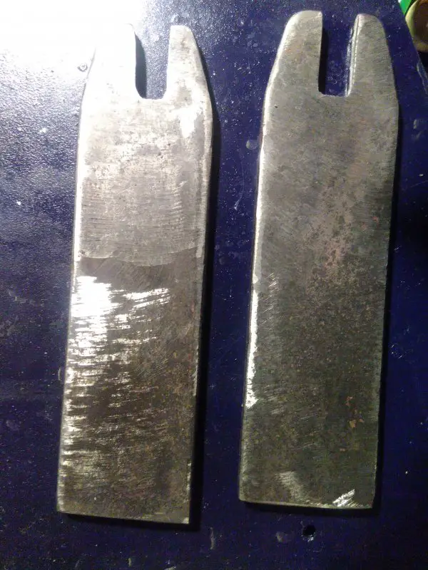

This is what I have so far...

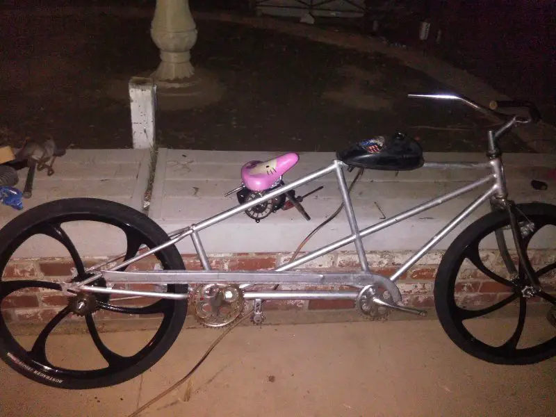

It's leaf spring. They fit tight tight... I used an angle grinder with a cut off wheel and I went at it one stroke at a time until they finally fit. Thank you for sharing that I appreciate that very much.
Lol on the hello kitty seat. So hilarious

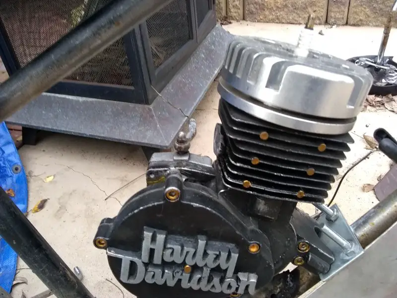

The Ld 100cc (50mm piston) definitely works better with a baffle and longer pipe.
I'm running the flex pipe on the 100cc with the G4 or G5 cylinder (I can't remember which... The one with the open ports) a 3d printed velocity stack, the piston has been "skirted" on the side that faces the intake so it allows it to suck in more air, exhaust and intake ports cleaned and polished/ roughed, and a 74 carburetor jet but I'm afraid that's not big enough I'm probably going to jump up to a 78, and the billet high compression head.
I definitely suggest looking into all of the stuff you're going to have to buy because none of the standard 80cc stuff fits it unless you buy one of those kits that has been honed out... Which I would avoid those all together. Now that it's had a chance to break in I like the way that it sounds and handles a little better.
But yeah, if you need to ask me any questions or anything whatever you're welcome to oh avoid the thruster pipe on the 100cc because you don't have any room hardly between the pipe and the head and there's no place to support the pipe it sounds cool but it don't work.
