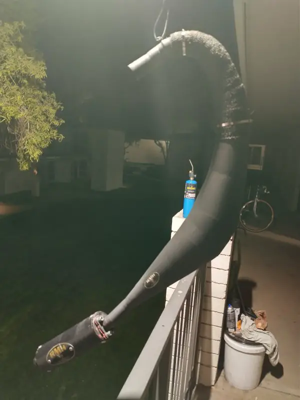

Yeah i Have a flux and the problem is dime stacking because the material was too thin. I had to use the lowest voltage and speed to get straight welds and fix it that way instead. Here one sec here's a photo of the job completed.
Since the pipe has a slip header the other issue is finding the right material to seal the connections. It will cause engine issues and a bit of bogging otherwise.
So here's what I think might work. Muffler or Exhuast Sealant and bedding the slip header with fiberglass. I tried several Silicone sealants. To much RPM and PSI coming from a Minarelli. The seals only last 2 days max lol.

I just welded the leaks then bedded the area with Versachem Muffler Weld Exhust System Repair, painted it with high heat automotive silicone based paint, then wrapped 20% of the pipe and metal zip tied the fibercloth material. Granted they do recommend to use their brand of spray silicone to seal the wrap, it's really expensive. 30+ dollars.

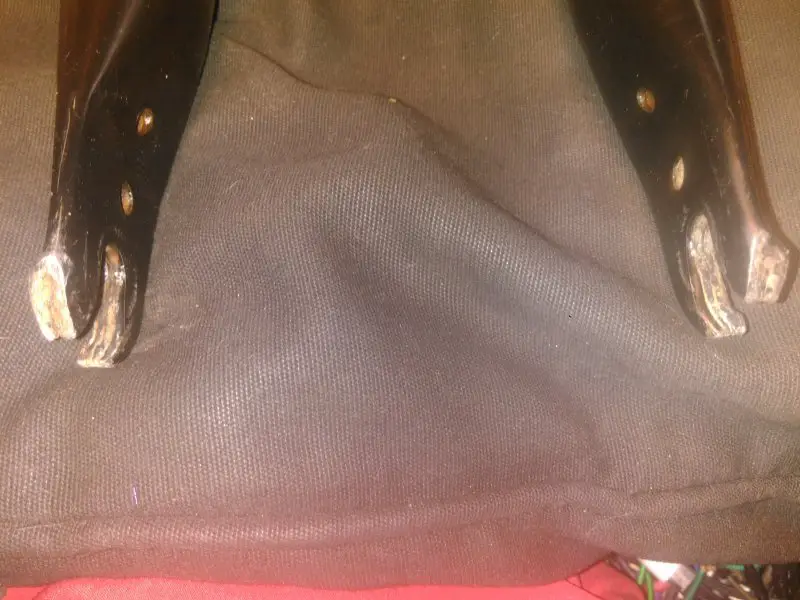

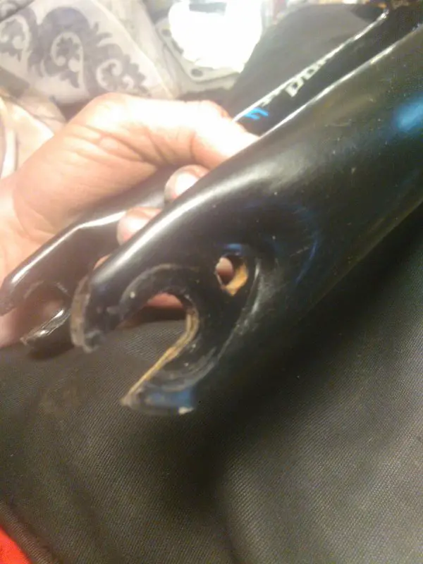

Well I have a 3 nice sets of front forks... But they all have aluminum or magnesium dropouts.
I was looking around the "bike pile" and found some cheapish forks that work until I get something else.
They are just spring dampened BUT the dropout is Definitely steel and Since I will only be using the front hub to get the bike motor started I think with the proper washers and torque arms it will suit my need.
See photos.
The steel tubing that the spring is inside of comes down and is pressed together and "laminated" on the ends so it should handle the torq with torque washers and torque arms.
It's the only ones I got so I'm going with them, safety over comfort.
Temp work around.

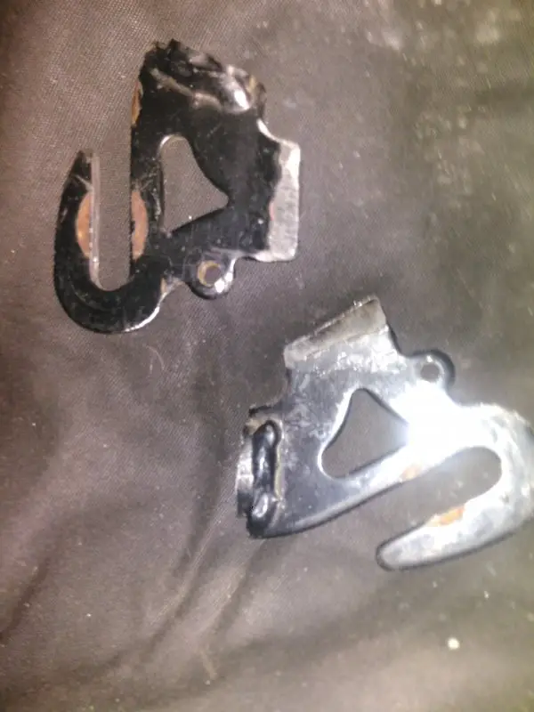

For the torque arms instead of using the leaf spring I cut the back dropouts off and old bike and modified them for use as front torque arms. I will post pics when I get them installed.
I figured since it's only a 350watt hub that arming both sides will be sufficient to do the job since it's only going to be used to get the motor started and temporary boosts of speed while running. The torque will be minimal since the gas motor will be carrying the majority of the weight already.
Sorry for the micro reports but beings this is my first e bike build and alot of what I'm doing is trial and error.
