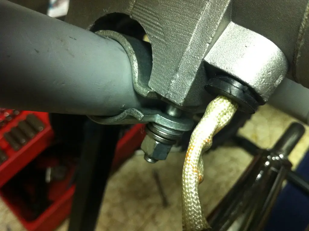

F50 from Dax came in as well as the banana pipe from BGF. Started mocking it up. Stock mounts are too large on the case for the down tube. My plan is to flip the brackets and use two on each side as in the pic. The tank has been angled in the front and tack with all the fittings in place. Not sure the clubman bars will stay. It's a different look. They need to be trimmed. Waiting to order a set of Worksman wheels/hub adapter.
The plan this weekend is to finish the frame off with some more filler and primer. Hopefully paint following.
I'm also debating if I should trim the piston skirt. You can see in the pic how much it's off from the intake port at TDC. We shall see.

you can cut the tabs off the other mounting bracket so it fits right inside the oversize mount, getting rid of that gap. i usually cut shims from a piece of pipe on the smaller diameter tubes older frames come with.
and trimming the piston skirt is something i've never done until my present motor, and now i think it's a must. it seemed to smooth out the entire powerband, maybe suffering just a tiny bit at very slow speeds, but who wants to go slow anyways? :)
looks great so far!
poorboys bikes
Custom Bike Builder
Apr 18, 2010
46
wichita, ks
I would leave that mount idea alone! i bet that would work better at dampening the vibrations from the motor than rubber & be more reliable! I might try that on my '58 schwinn, thanks for the idea:) Maybe rubber grommets on the posts, in between the motor & top bracket? Nice build so far!! Hey I'll take those bars if you dont want them!

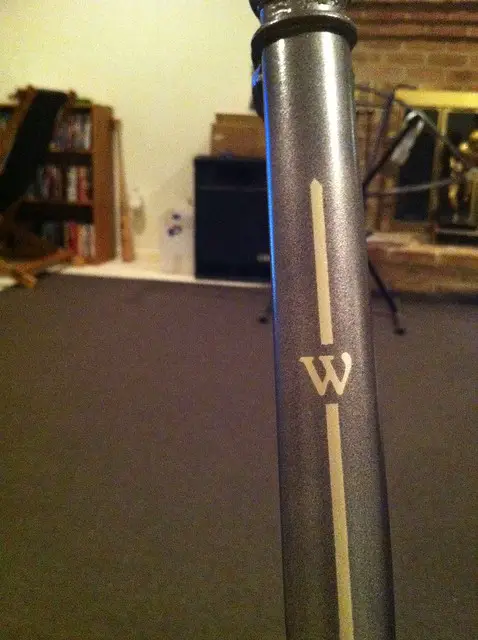

Got the frame painted this weekend. Still need to clear it. Happy with the "patina" and details. Tank install is next.
Gonna be using a Drag Specialties seat pan. Should be here by this weekend. Stay tuned.

Frameset cleared. Get's the rub down tonight. You can see a bit more of the patina I was going for now.
Carb came and seat pan on the way.
