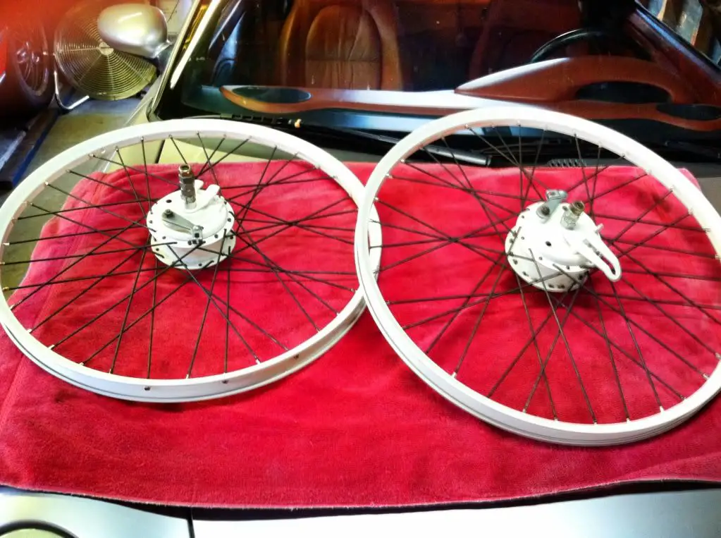

Tim (Feelyx) and I (Cobrafreak) were Building up some wheels today for his current build, the Feelyx Flyer. It's going to be a Military build with a desert camo theme. The wheels are laced cross-3 with 11 gauge Husky spokes and rims with Italian moped front and rear drums. They are going to be really stout wheels for sure. The paint is a gun kote product, or something like it. A coating made especially for firearms, it is super durable, probably just under powder coating. You apply it with a spray gun. The spokes are gun-blued. The engine is going to be a GX200 clone with a torque verter transmission. Tires are going to be Simplex Servi-Cycle. Bike will have a custom frame, custom fork, custom tank, custom rear leaf spring suspension. Bad @$$ !

Very cool, look forward to seeing more. I recall a bike on biker build off tv show that was coated in that blue gun barrell coating. It looked cool.
Thats a nice looking interior in the car that the wheels are laying on.

From the location of the lever I think it’s just a early drum brake ( ?).
You can click on those photos and then zoom in ever farther, at least I can with my Jurassic Mac.

You are right just looks like a drum brake.
Good old Wally World E machine zoomed them in just never thought of doing it ...........Curt
