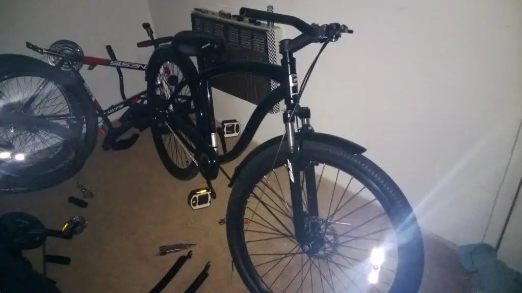

The Evil Onyx - 80 percent
Here's a picture of the finger-tight mock-up I had done. So I lost my patience and drilled into the frame. It's regrettable, but my girlfriend doesn't share the same passion that I do to tolerate the bike parts laying all over anymore. So it had to be done... (-_-)
I would say the bike is about 80 percent complete at this point. There is very little clearance anywhere on this bike as the parts barely provide enough clearance for the pedals, chain and tire which makes me very nervous.
Additionally I need a clutch lever as the one they sent me was broke. Longer fuel line, or a nice inline filter (glass?). Wire loom to tidy up the wires. Need to open up the clutch lever thingy-ma-bob and see why it's sticking. Upgrade to grade A bolts for mounts. Take it for a ride down the dang road. Then I can put some nice pink tassels on it! Almost there - so close!!!

It's looking good!
Weld in a sleeve through the frame tube where you drilled the frame. You can keep your "bolt through the frame" mount and have a strong frame too.
