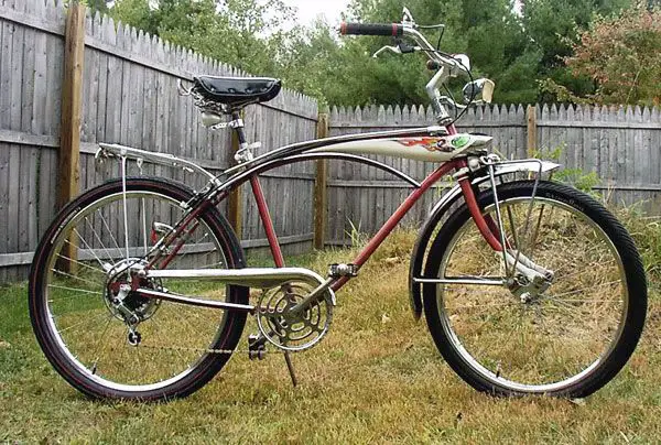

The reason I ask is because I want to motorize my Flightliner, which is a tank. That's good news, it probably weighs about the same as yours. Cool, Thanks!
i'm all into the heavy duty american made bikes. it's not so much the weight, it's that they're solid. my bike doesn't rattle, doesn't flex, no creaks, nothing's broken but the 70 year old skiptooth chain, and it'll outlast the factory that china bikes are made in...
i think a nice heavy bike is better for these engines anyways. for exactly the reason's i've stated above.
OH Man, that is gonna make for one sweet MB! Post lots of pics HH
Looking forward to them big time HH. That is an awesome bike! (an' screaming for a motor!)
