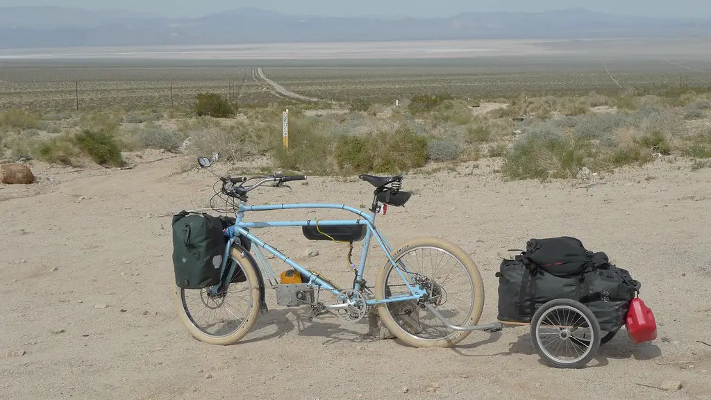

Here's my late entry. I built the frame fro scratch. All 4130 aircraft tubing, brass brazed. Engine is an EH035 Subaru driving the left side crank. 24 engine-driven speeds. Recently rode it from san diego to las vegas in 2.5 das. Averaged 25mph pulling a 60lb trailer. Staton gearbox geared to spin the cranks at 100rpm at peak power.

A bit more about the bike, then, hopefully, a picture. I'll be doing a 500-mile ride around Arizona on it december 17th with a friend. After that, it will be shipped back to Bozeman, MT where I'll build a tank for it, along with a trussed fork. I haven't built a fork yet, so I'm looking forward to that challenge.

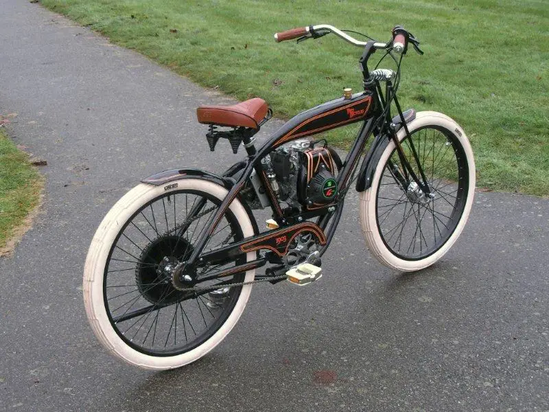

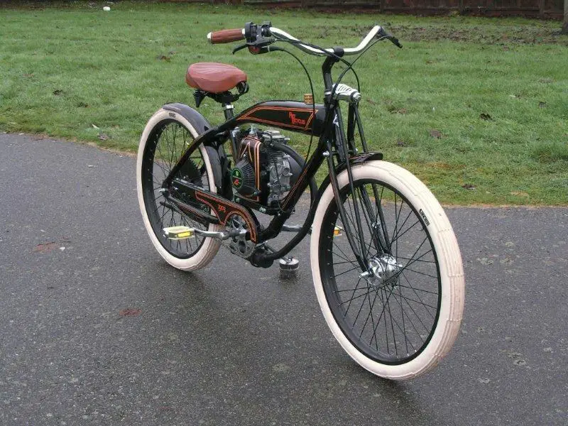

That means allot coming from a master like your self. I try to keep it clean looking I believe that less is more, I make up for it with all the features from the billet aluminum and ball bearing throttle to the HD Axle Free Wheel. And my customized engine mount that lets me keep the chain tight and loose the chain idler. The top tube tank with clear see through fuel filter and clear see through fuel line help loose yet another bolt on that can clutter up the look.
The next feature is the custom made exhaust made with over sized pipe and a hand made muffler with 5 baffles then extending on right to the very back of the rear wheel. All the while trying to make this bike as safe to ride as possible with brakes front and rear and sealed bearings front and rear as well. The last of the features are the free wheel on the rear that will make it easier to pedal when the engine is shut down and a 22 tooth pedal side rear sprocket that help make the whole pedaling experience much more enjoyable.
Who ever ends up with bike is going to be a very lucky person the Felt 1903 was my first choice when I started doing this a year ago and when is sells I will be a little heart broken as this bike is my crowning glory.
Cheers from Blow By U
Terry

I wanted to compliment you on several levels. Your bike is something else and obviously performs as great transportation. That you made it from the frame up, brazing it all together yourself, designing it to fulfill your needs is impressive. You have a great fountain of creative energy and obviously just like to make things, out of metal and paint or words and images. It's a good way to live I think, as a maker of things generating your own light as you go. I'd like to know more about the how to of your engine/gearbox/drive train as it looks like a great setup. I also have a set of those Fat Franks and think they give a great ride. Just spent a pleasant and interesting hour wandering around your links... thanks.
SB
I like your bike build. I think that the desert picture makes
quite a statement.
Thanks. My goal for the build was a bike that looked somewhat old fashioned but that had the same cockpit geometry as my regular road bicycle. This does that, making it a great long-distance machine.
I'll be taking it on a 570-mile loop through Arizona in 2 weeks, so I'll post some more desert photos when I get back.
