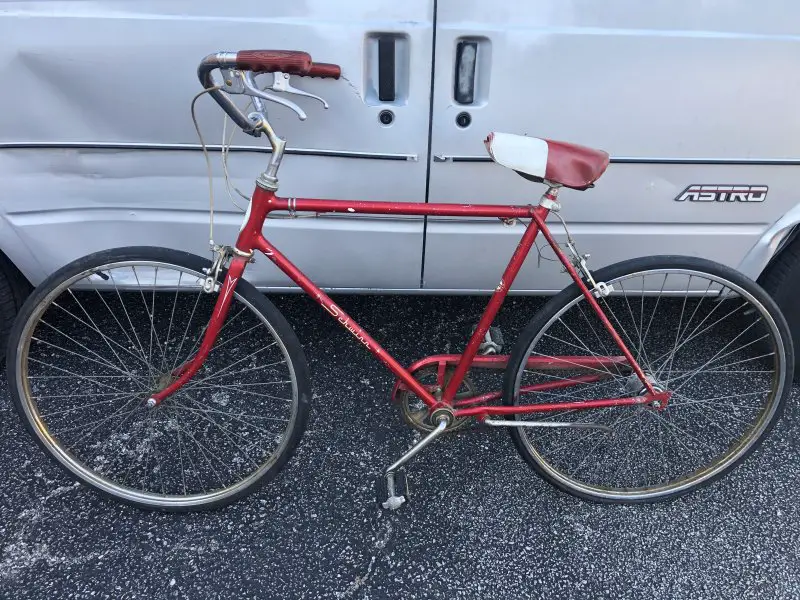

I drove down to Mansfield yesterday to pick up this old, rusty Schwinn and my kit should be here today along with a pair of tubes and tires!
I was looking at using my old Peugeot road bike but the swoopy handlebars don't look to great for the throttle. A jetski style lever throttle crossed my mind but it was easier to just grab this old Schwinn off craigslist for $100.

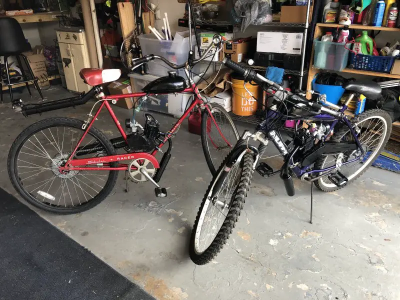

Ain't nothin' ever easy! But I got 'er running good enough to play around with this evening.

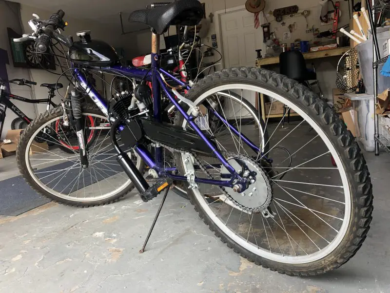

FYI the old three speed Sturmey Archer hub that comes on some of these old Schwinns is just a teensy bit too large in diameter for the bolt spacing of the standard rear sprocket and hardware.
I grabbed an old bike with 26" wheels and used the front on the rear since the crank hits the engine casing in two places and I didn't want to mess with the coast brake on the donor bike. Might mess around with that tomorrow as right now I've just got the front brake and it's less than great.

I've got to get my engine raised up a little so my pedals will clear and sort my rear hub issue before I make any long rides.
