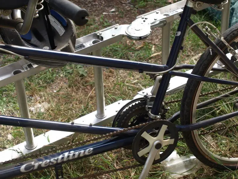

Man, they all look great but I am really discouraged when I look at mine. I will go out and take some pics right now to show y'all. I have a chain on both side of the bike where it looks like all of you have the chain on one side only! Also it doesn't appear to be enough room with frame mods! Not sure that I have the tools and the ability to make the adjustments to the frame. Anyway, all your input is vital to my decision...I would love to have a nice slow cruiser to take my wife out on some bike paths around the area (paved). Thanks!!

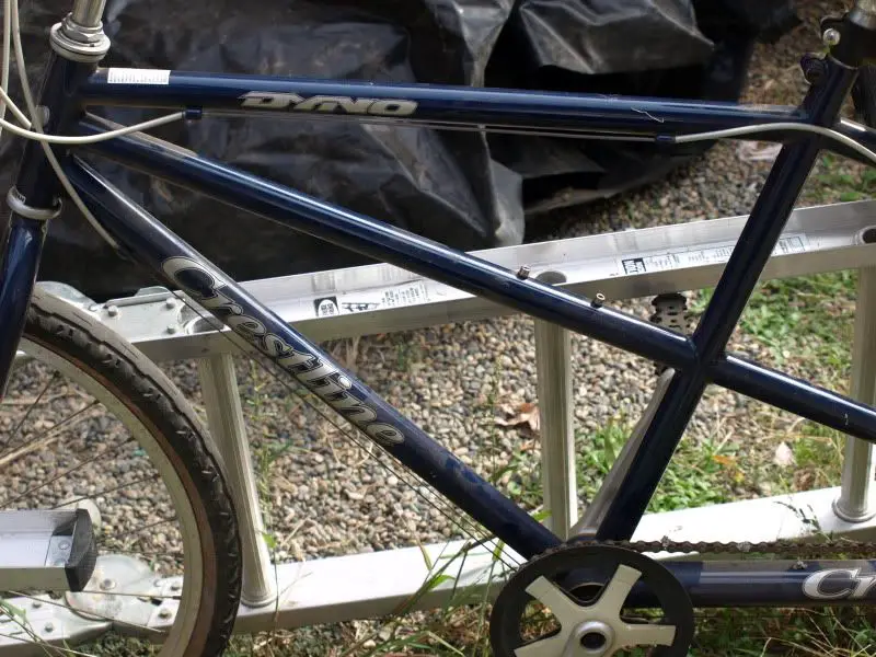

Ok, here is the first pic of the frame - front...would have been perfect without that middle bar!!

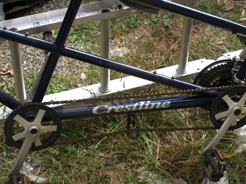

Here is the back part of the frame...still not alot of room!!
Here you can see the dual chain setup...

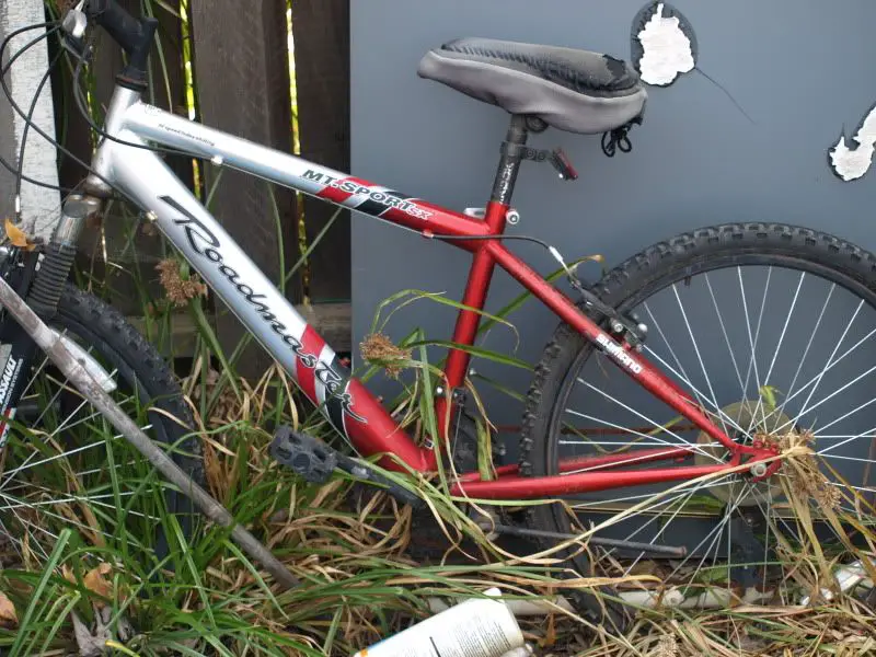

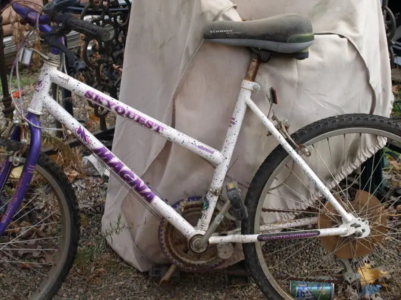

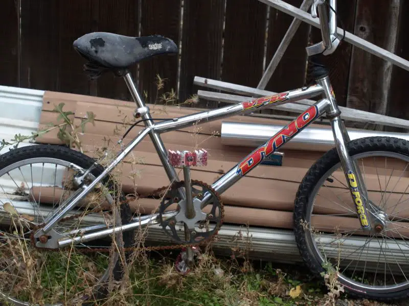

Also, have some other frame options for an individual bike...any recommendations or help is very welcome!!

howdy mac, welcome to the forum.
um, i'm pretty sure none of those small bike frames will fit an engine. as for the tandem, you could cut that middle tube in the back like scotto did, and stick a big honda gx160 in there with a qmatic transmission. that would require welding, and using a cutting wheel on a grinder. you'd have to weld a tube into the corner that looks like this: \ . then your 4 stroke mounting plate could go on in there. for more ideas look around and use the google search feature. i've never done a tandem so i'm mimicking scotto's design.
