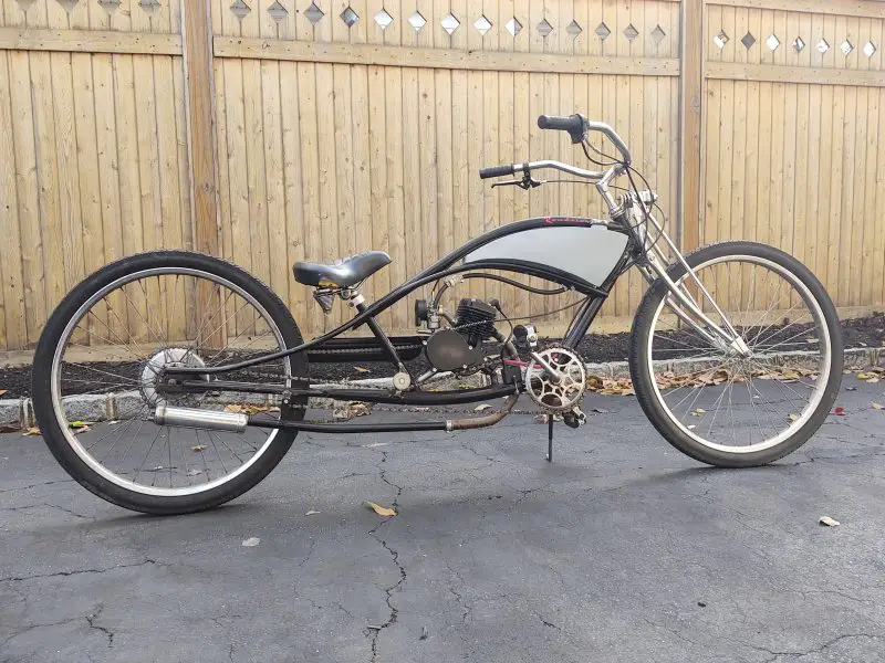

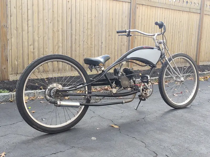

I put about 15 miles on it today. Just cruising with a few full throttle bursts. Top speed was 26 mph running on a 20:1 mix.
Overall it runs pretty good. My only observation was that it seems to have more vibration to it then my other bike. It's also louder. The only difference would be an upgraded carb on the other bike.

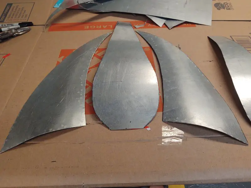

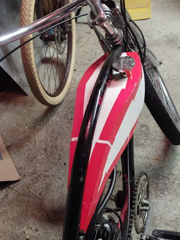

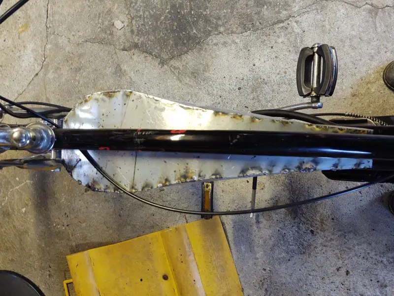

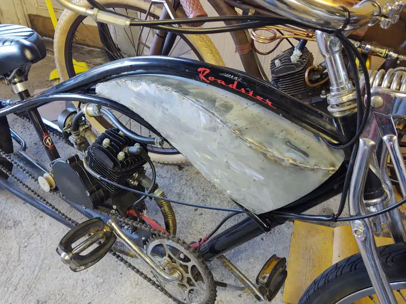

I'm any case, I had a few days off and decided to make a tank for the cruiser.
I made a mock tank up first and then used those pieces as a template for the metal.
Probably not the best first project due to all the curves and the thickness of the metal but, it was a good learning experience.

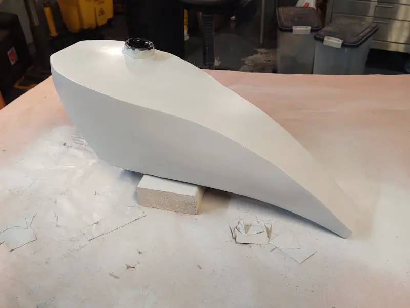

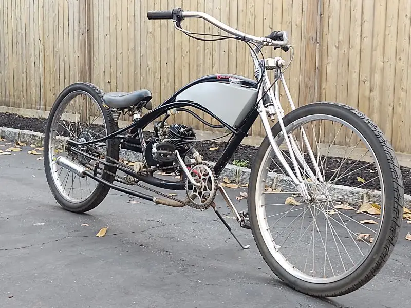

The final product was slightly twisted but still fitted very nicely into the void in the frame. I filled it with water to test for leaks and then I treated it with a tank liner for added protection.

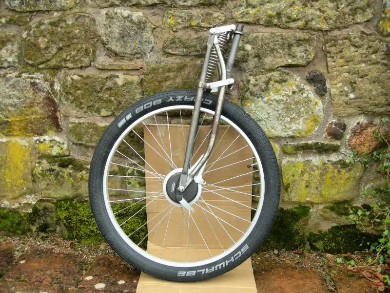

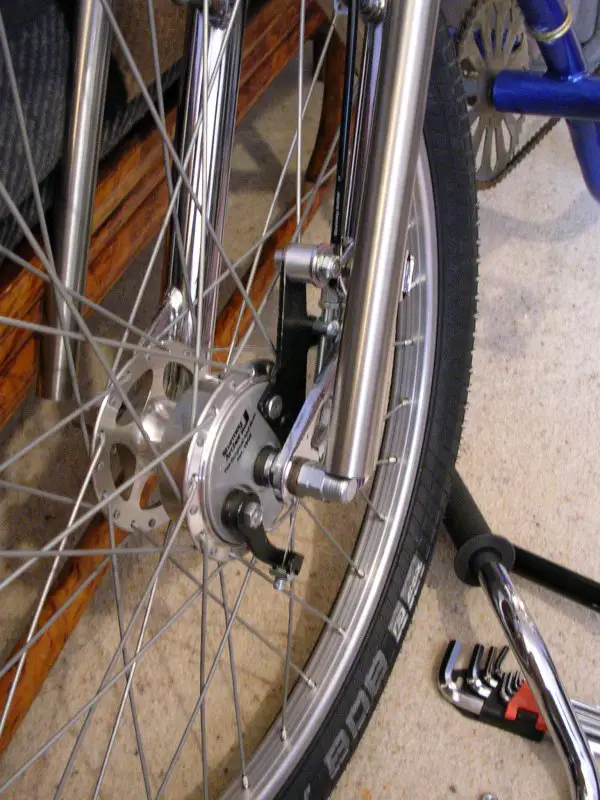

Jerry, it currently just has coaster brakes.
Please get more than that. You may want to consider a front drum brake. With your skills rear rim or even a disc is possible.
There's also Springer forks that disc brake hubs can be used on.
I can recommend the Sturmey-Archer front drum brake. Used them on a couple of my builds and they're more than up to the job of providing enough stopping power for the China Girl motors. Look great too.
Or if you can find them, SRAM front roller brakes work great too. Fitted one on my Gnome-Rhone build and it's more than capable. Either of these front brakes won't involve you having to swap-out or amend your forks.
