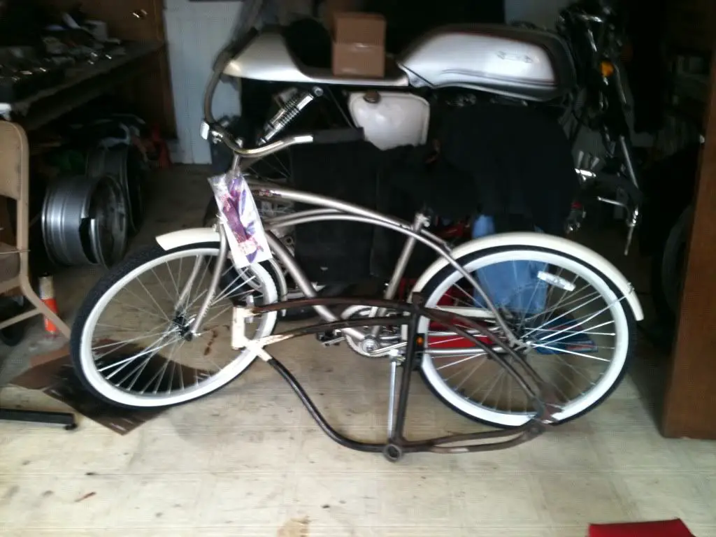

Hi there.
New to this forum and motorized bicycling.
Just bought a Huffy beach cruiser from walmart (see pic below) and ordered a 49cc 4 stroke 4g t belt engine kit.
Wondering if any of you have any advice to whether I need to strengthen my bike in anyway to handle the motor?
It has a steel frame and steel wheels.
The gentleman I ordered the engine kit from said he has the same exact set up on his bike and has never had a problem....but just wanted to make sure with you guys.
I don't plan to ride this everyday. I live in Seattle, unfortunately, the weather doesn't allow it :/
But I would like to once a week....just go putt around town and do an errand or two.
Also, it only has one brake in the rear. Does anyone recommend an easy front brake set up...like a disc, drum, U shape etc....
I would like to keep it as ol school looking as possible so a disc brake setup would probably be my least favorite.
Any help would be greatly appreciated...

Hi and WELCOME brnot While I am a newbie too, IMHO your cranbrook will be fine. Just remember to keep current with maintenence and do a safety check every time...

Your bike should be fine just keep an eye on the seat stays, those are a definite weak point on huffy cruisers.
<snip> Make sure everything is well greased and properly tightened. There are quite a few here that have thousands of miles on those wheels so don't worry about that.

Ah! That RIGHT Kemo Sabe ! Seat stays no good on Huffy.
The stock seat on my huffy didn't even last a week, or wuzzit my BUTT that didn't last a week. Buddy gave me a STRANGE SCHWINN seat with nothing "out front" and it works fine somfort-wise. There are tractor style seats out there for less than $50.
Kevlarr's more than right about the rear bearing adjustment and grease. Mine needed re-adjustment soon after motor install -"re-adjust the combs" is what I was told I was doing. Any wobble you see back there, don't delay fixing it!

Hi here is my 2 cents. i got a huffy santa fe same frame as a Cranbrook i got 49cc hs 4g trans and ride the **** out of it, over 2000 miles now. i've hit every pot hole in town, most times because some A hole in a car crowds me in to it. i have had no problems with the frame strong as ****. but i got to confess i have MB wheel on it {shame on me} {:-) they are stronger for pot hole jumping (local sport here)
the only thing i can recommend it to put SLIME your tubes and keep you air pressure to max for your tire, unless you like to push you bike home with a flat.
