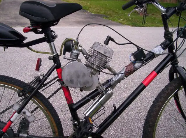

thanks, fairracing! that engine sits pretty high, huh? the bike i bought today is a rusty old Murray which has the two down tubes like that one, but they're curved in such a way that the engine would sit lower.
i think this old bike might make for an interesting build if i got rid of that top tube that was so crappily stuck on it, but i'm still wondering about the strength of the girl bike frame geometry; seems like a triangle missing a leg. wonder if the chances of sudden catastrophic frame failure would be in any higher than on a men's frame if i bolt on a little Morini?
