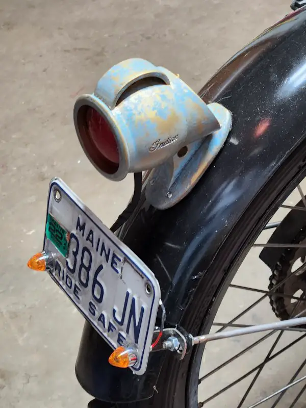

One thing I didn't realize when starting this project is that it would never actually be finished. I spent the last couple weekends working on a few details and I think now I might actually be getting close to being done.
Air filter: I went candle shopping with my wife and spotted a candle with a brass cover that turned out to be the perfect size for a four-inch air filter!
Stand: My old one wasn't very will designed. The smallest unevenness allowed it to rock/tip. This one is significantly wider and more stable.
Muffler: The old straight pipe was made when the bike was supposed to be a board track racer. I couldn't stop thinking an original looking muffler would look a lot better. The downside is this thing actually lives up to its name: it muffles a little more than I might like.
Wret I've greatly admired your bike from the start yet each change has definitely altered the bikes personality & reflects your own. Though I liked the red & shiny black along with the highly polished stainless tank they seemed a bit out of place, especially as you changed from board track style to period road cruiser. I'm thinking the patina on the tank & motor are really looking authentic, the solid brown rust on the engine wasn't very convincing. I actually like leaving some shiny on tins, fenders wheels and the same with aluminum and chrome accents etc.
I really can't complement this build enough & as for it's being about finished....I'd say not until you lose interest or sell it. One of the positives of only building one of these bikes is that you can concentrate on getting it absolutely correct for yourself rather than spread yourself thin working on multiple projects that also, in my experience, never get finished...kudo's! Rick C.
Yeah, it took a few tries (and about a dozen cans of different color paint) but I think I've finally got the rusty iron look down. Repainting over and and over helps add texture too.
Here's a better shot of the muffler. Fortunately I found a way to keep most of the horrifying welds on the inside. ;) I was going to paint it black but I'll enjoy the shiny stainless for a while and see if it grows on me.
Also forgot to mention, for anyone wanting to copy the configuration and look of the original Indian handlebar stem, an old Raleigh stem with seat clamp underneath does the trick.

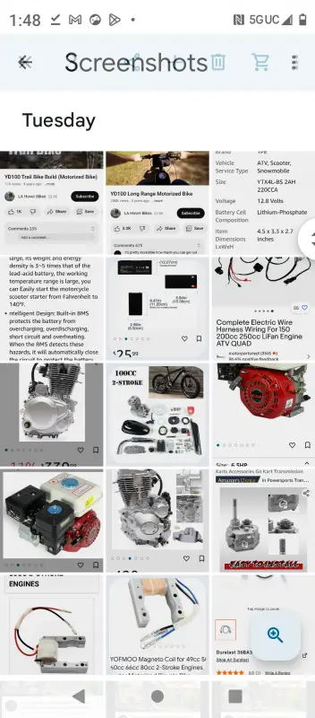

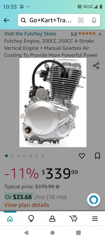

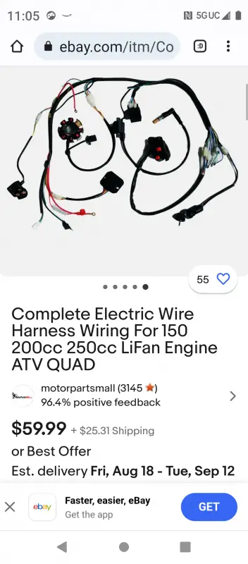

And because everyone is an assumed liar lately I put my Tuesday screenshots up...
