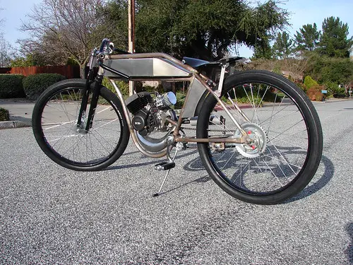

A few photos of the latest Sportsman Racer. The Racers are Morini powered using the S6S 9.4 hp engine. What is significant here is the two stroke pipe. I have messed with this pipe endlessly trying to get it to blend with the BTR frame while not destroying the look. It was tough and required a number of compromises. It may not be the optimum shape for the engine but at 9.4 hp I figured I could sacrifice a little power for the sake of getting a good fit. Having to put a muffler on a boardie is a bummer so I made it easily removable for racing purposes. The Morini really is a bad ass little engine!

Looking good I like the way the exhaust wraps into the bike and you pulled off the look of that muffler nicely(^) Exhaust seems to be one of the hardest things to finesse a good operation and look with.

Simply beautiful, the geometry/angles are perfect! You have set a new standard for Board Track Builds.
I can't wait to see it with paint and nickel plating.

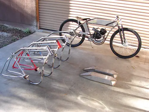

Future Sportsman Racers. Frames are just partially assembled at this point and still need all their tabs and brackets. Two unfinished tanks sitting on the ground. These are true lugged frames and fully brazed construction. All brazing takes place in the frame jig. They come out perfectly straight. A fairly complete Sportsman Racer kit sits in the backround for reference.
DSC05954 by Sportsman Flyer, on Flickr

Wonderful frame pics but I think I noticed something that I also seem to see on my own bike. Because the Worksman rear frames are designed for 26" inch wheels and not 28" the frame sits at a flatter angle from rear wheel hub
to the pedal hub. Therefore when you make a deep loop, although it looks radical, once you mount it on the 26" tires the angle changes and the loop does not appear as deep. On my next bike (yes, got to make a third now, maybe I can sell my first bike) I intend to make the loop even more deeper than on my Choctaw.
For me, once you have have ridden a drop loop lengthened bike, and have actually ridden one of the old motorcycles, those unmodified worksman frames are just way to short for "happyness". That long tank and lengthened frame on with lengthened cruiser handlebars are the cat's meow in my opinion. If you can't make your own, buy one of these and you are going to find it is worth the extra expense. Those long loop frames with those big tanks are attention getters....me, I like the attention more than just driving from point a to point b.
As for the tires I was more concerned about durability when hitting pot holes at speed and also side loads, in other words, ridden casually and a lot at speed. If I want to go 50, me, I am getting a motorcycle, then again I am old and I break easy and don't repair so good. You young guys, well, you are going to push the envelope, always have throughout history and more power to you, better to die young in battle, rather than grow old and waste away.
