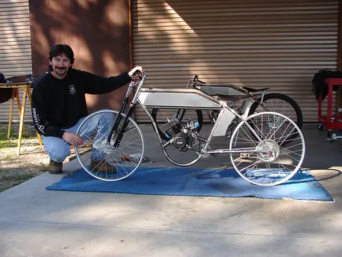

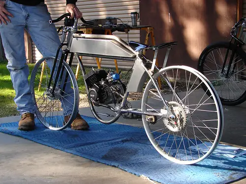

A few fresh pictures from today.
DSC06034 by Sportsman Flyer, on Flickr

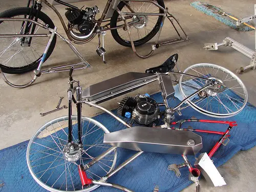

Pile of Racer parts.
DSC06029 by Sportsman Flyer, on Flickr

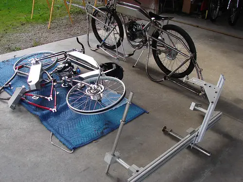

Another kit nearing completion. Production is coming up to speed, well sort of for a work force of one. I hope to see a few of these builds finished up in the near future.
DSC06021 by Sportsman Flyer, on Flickr
