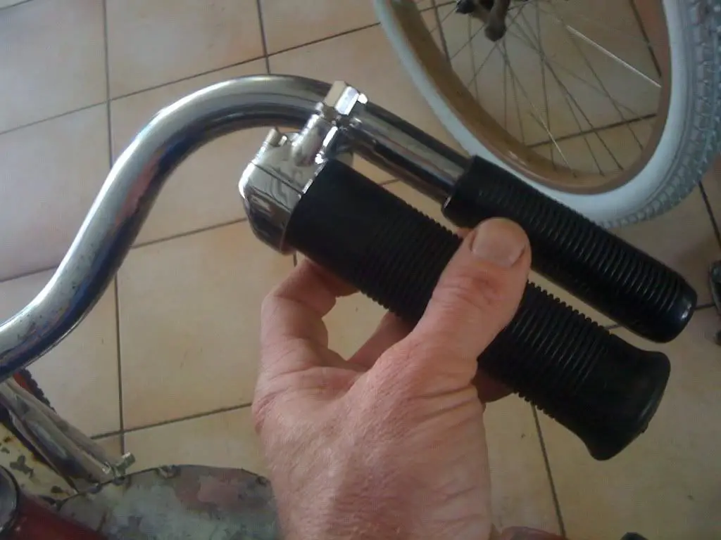

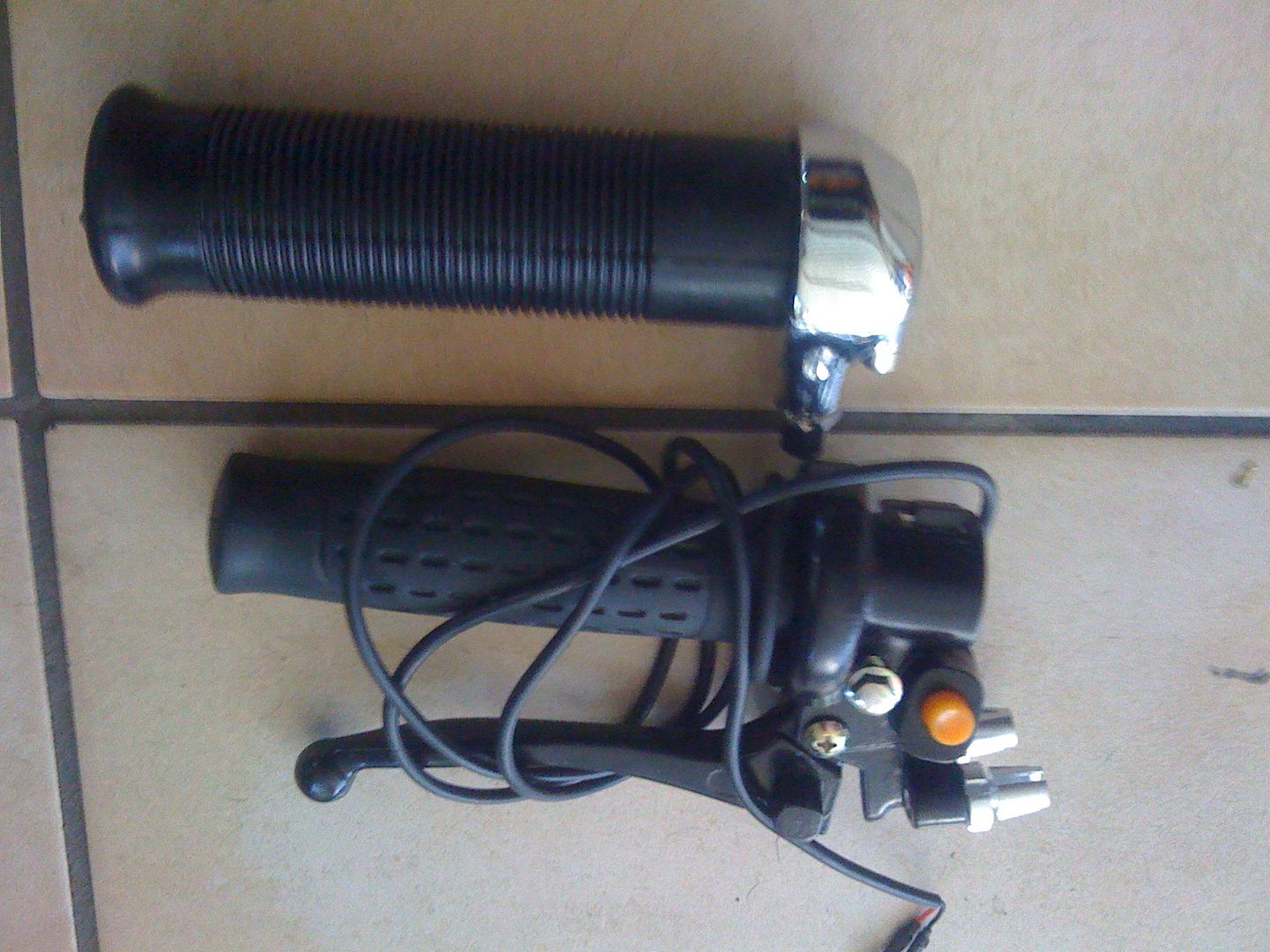

hey, can you use 7/8 motorcycle grips on the bicycle bars (& on the Chinese 2 stroke throttle grip) ?
The 7/8 motorcycle grips are 7/8 on the left & 1 inch on the throttle side, to fit over the throttle tube. Would these fit a motorized bicycle?
