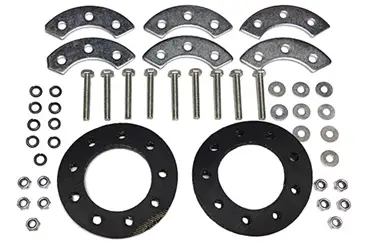

You might want to go to youtube and watch a video of someone installing one of these chinese kits. They all come with a mount for the new rear sprocket that is 2 pieces of thick, tire-like rubber rings that sandwich the spokes around the left side of your back wheel. A set of 9 bolts feed through the sprocket and then through the rubber doughnut-spoke-doughnut sandwich to attach the sprocket to the left side of the rear wheel.(there's also 3 metal plates that form a circle along the rubber on the inside where the nuts go.)
This is called a "rag joint."
A better mount, available separately for 40+ bucks, is made of metal and bolts directly to your sprocket and clamps to your hub, which is way better than the rag joint for a number of reasons.
If you're patient, mechanically inclined, and use good hardware you can successfully use the rag joint. It just absolutely must be true and secure.

I thought I'd share this giant photo of an automotive "rag joint". It's from a steering column on something. Probably an old Chevy. Anyway, the name rag joint comes from the fibers visible in layers at the edges. This is what the kits use, but they have nine holes, and often appear to have been sawed down the (almost) center to make two thinner doughnuts.
These joints are used on steering columns, pto shafts, some driveshafts (instead of a universal joint). I'm not sure exactly what original application got picked up to become the Chinese Motorized Bicycle Sprocket mount, LOL. But it is clever.
