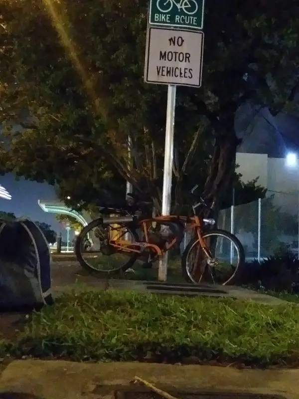

putting on the miles on mine, new parts came in today more coming, more work to do on bike, MZ pipe broke at the brazing weld again tonight, been doing 80 mile round trips daily, lately. 60 miles to half a gallon runs good.
