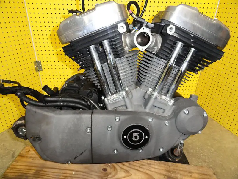

This is going to be a future board track racer of mine. I will post pictures as it happens.

Yes, I agree, a natural progression. The main reason I am doing it is that when my motorcycle friends want to go riding they don't need to keep it under 45mph for me to keep up, Lol. You know, freeways and such. The Sportster engine comes in two flavors, 883cc's and 1200'cc. The 883 has 55hp and the 1200 has 75hp. They are dimensionally the same size on the outside, just longer stroke. You can pick up these engines on Ebay all day long for $1500-$1600 plus around a $200 freight charge. The nice thing about the Sportster engines is they already contain the transmission and they are the bulletproof Harley engine. No problems at all. The Big H twin cam engine has all sorts of problems with cranks coming apart because they are pressed together, not welded, bearings that are not hard enough, cam chain tensioners that wear out quickly and put metal shavings all over the engine ruining it, etc. The little Sportster engine is smallish, very narrow, relatively light for a full size engine, easy to work on, and lasts and lasts. Oh, it has the classic V-twin sound because it is, well, a V-twin :P. I'll convert it to carburetor from EFI and convert it from belt final drive to chain. It doesn't have a kick start on it, just electric. I could put one on but it is too expensive for what I would get out of it. I'm going to combine elements from 1914-1917 Harley Davidson, Indian, and other bikes in the early days. It may have a bicycle crank pedal that would just be for show. I still need to figure out how to do it. I was going to get classic 22" rims and 28" antique tires but for safety and cost (clinchers are dangerous because if they get low on air the tire will come off the rim completely instead of just deflating), I will use 21" rims front and rear with 27" modern speed rated tires. They are a lot less expensive and still look the part. Probably disk brakes. Solo saddle, maybe twin solo saddle for two-up riding that can disconnect.
is it a china motor? or a pre 86 american made motor? because i would not buy a china made harley motor, they have a problem with the rear cylinder sleeve sliding in the jug.
"China Made"? Lol, I see you are from Wisconsin, I understand now. Pride. It's a 2005, so it may have some parts made in foreign Countries, but it's Mostly American. Actually, the Evolution engine is credited with saving HD as a company and repairing the tarnished image AMF left them. I'm completely fine with my engine choice. The engine came out of a running bike with 6k on it, so I'm not worried.
