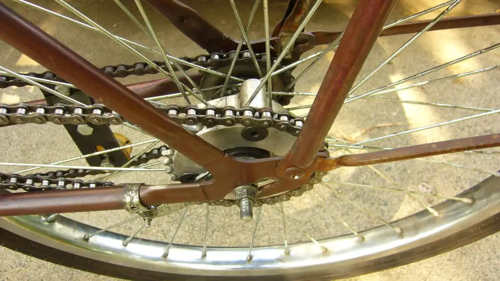

That is exactly what I did. My 20t rear became a skip 10.
I used a angle grinder. Sorry not the best angle but it's the only pic i have.
old thread, but yeah, that's what i've done so i can run modern hubs.
most of the older chains were wider, too, so you get some slop with a modified cog in the rear.
