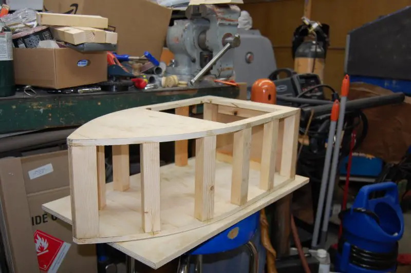

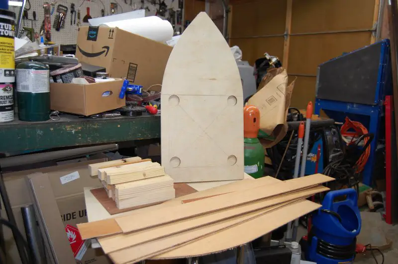

I'm adding the sidecar I'm building for my grandniece who is 7. I've mentioned it in other threads but the photos of the build will be posted here.
It will be light and simple since I don't think it will be cool to be seen riding the bike with all your favourite dolls in it for very long. Sticking with the same boat shape that I used for my side car posted here years ago.

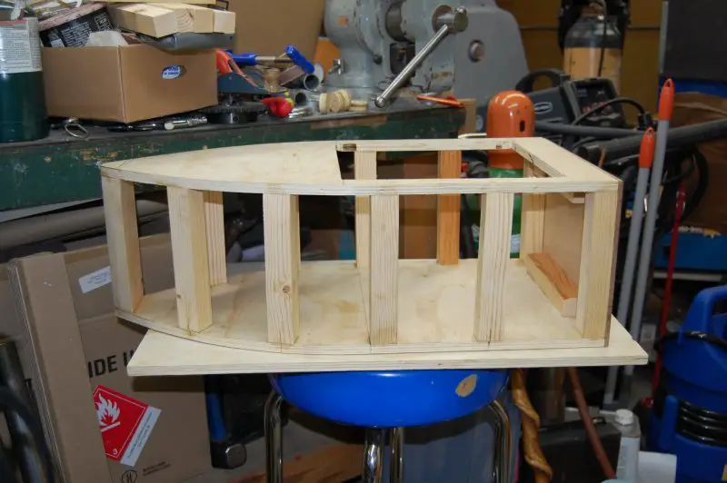

I'm going to cover the frame in 1/8" door skins and finish them with mahogany stain and varnish. The top and bottom will be 1/2" birch plywood for strength. The top will have a door skin cover to match the sides. The sidecar will be 1' wide and 2' long.
Ordered a high grade construction adhesive to bond the panels to the frame to minimize nail holes. That will be here Monday since I can't buy it locally. Took a couple of photos to show how it's starting.

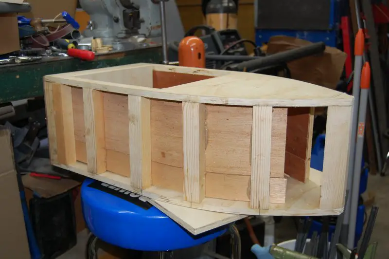

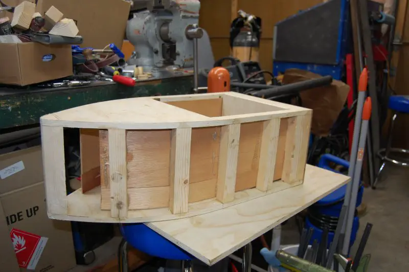

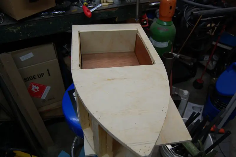

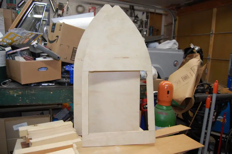

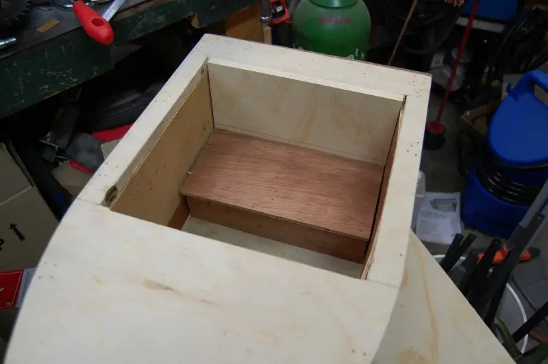

Sidecar is together and the inner liner is in. I'll try and get the skin on it tomorrow and the deck covering. The construction adhesive is working out well.
Steve.

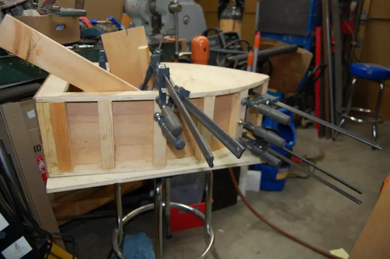

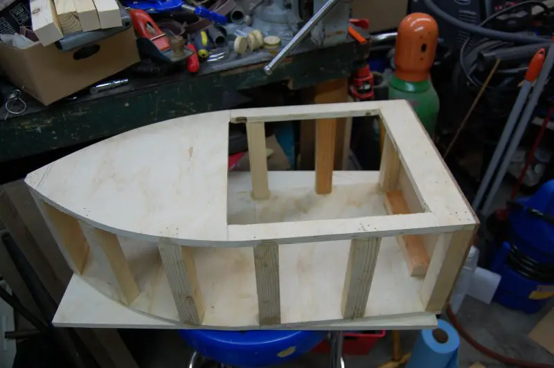

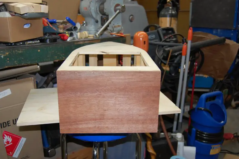

I have the sides on the sidecar. Ran glue on the frame and then nailed the side covering to the bow of the sidecar to hold it in place and then ran a small ratchet strap around the sidecar to hold the sides against the frame then nailed them down tight to the uprights and the top and bottom.
The top/deck is glued and nailed down and I have to cut out the hole for the cockpit. I'll have more photos in a couple of days when I get it finished.
