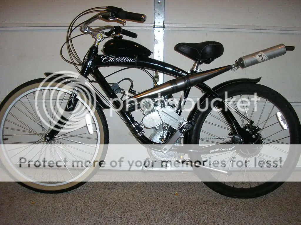

Shift Kit (check) + NuVinci Hub (check) + Expansion Chamber (check) = AWESOME (Triple Check!)
(Almost done)
Gears change everything.
Automatic Transmission (NuVinci CVT Dev Kit) gears makes the jaw drop.
Automatic Transmission (NuVinci CVT Dev Kit) gears makes the jaw drop.[/QUOTE]

I have had the boxes here for a couple of days and now that DR is over I opened the boxes and got a start today.
It sure isn't much to look at out of the box.
She is getting a black springer for a front shock, and just for reference you need a threaded 1 1/8th" dia 6" long fork to fit it.
I had the SBP Ver 2 JS and front mount a week ago and have them painted up in advance so I can mount it to the motor tomorrow but I did get the handlebars mostly done today.
I am liking the disc brake, that is an 'extra added bonus' as I like to call things like that too.
Dual pull teeter-totter brake and throttle on the right, shifter and clutch on the left, and of course BMX foam grips.
I am thinking this build is simply going to need an extra day for road testing ;-}
