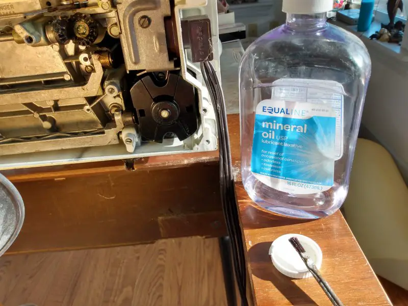

Will see about how it operates. I should probably get the right sewing machine oil, but I had mineral oil I used.
Maybe I could make a lamp out of the old sewing machine if it won't work well. It is like a boat anchor.
The sewing machine oil is actually mineral oil made from paraffin wax. $8 4oz, $20 qt, $40 gal.
The use of 3 in 1 oil was mentioned some say OK others not. Light oil also TriFlow was also mentioned. Do like food grade no stink oil. Funny one specific trade name sewing machine mineral oil is branded Lily White.
The mineral oil I got that is from supermarket in the pharmacy section. Never had a taste for using this for myself. I only got it for use on a wooden pizza peel. Now I have a second use.

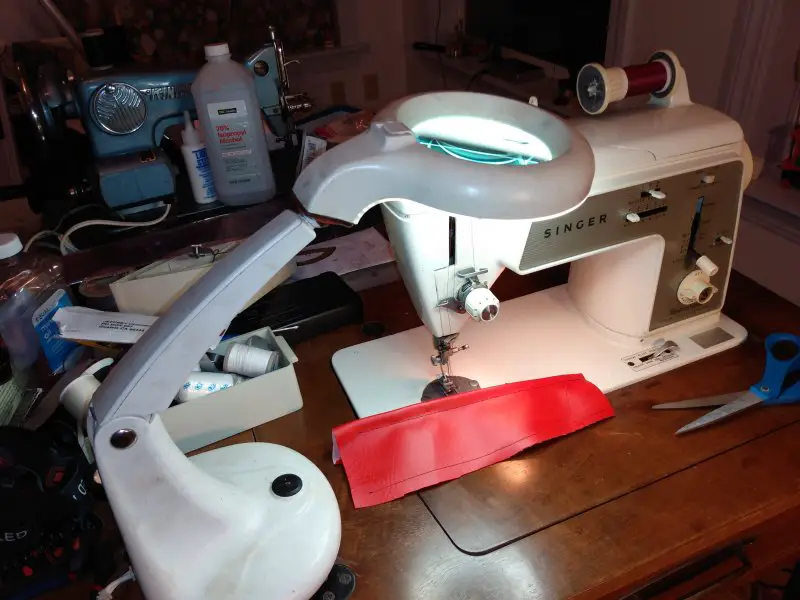

Tuned up the old machine. I found some bent spring and adjusted as best I figured for the top thread tension. A little fine emory cloth to the bottom bottom thread guides. The pressure foot release now also releases top thread tension when lifted as it should. Everything back to square. Top and bottom side test fabric after adjustment. The loose parts mid stream in test stitch on bottom picture no longer showed up when tightening up top thread tension. Fairly even regular stitch.
Stitch width adjustment loosened up and has a full range now.
I lost one part the nut that goes to top thread tension. Some strange metric size. Found one at a shop, but it had an integral scale marking on a bezel. I got out my Demel, mask, face shield, & ear plugs and cut it away. Turning the nut is supposed to turn the scale marking separate by interlocking teeth. I don't really need the scale, but if I want I can try turning the nut at the same time push the scale to move it in unison.

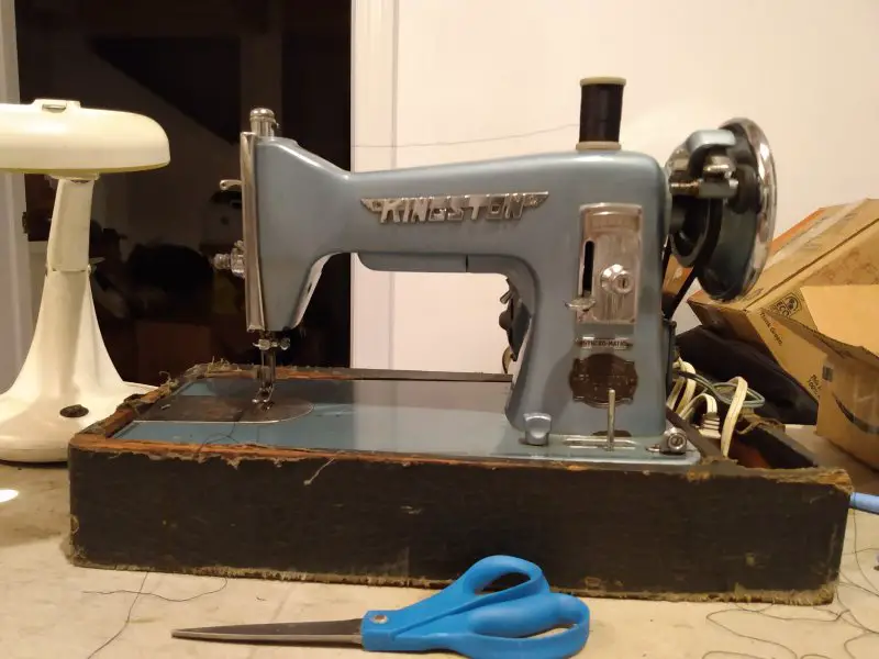

As for the Machine it was in a Storage Locker for a while. Although rain did not get in, it was not used for a long time. There was a time that snow got tracked inside the locker and melted. It did no good for the thing.
Now to get time to look at the newer old 70's era machine. Instead of an array of plastic disc to change for adding more style stitches, now stuff is digital and have LCD displays.

Got the grease for the gears and oil all around the machine and it is amazing. Learning curve ramping up. If I want other stitches special ziz -zag and hem etc., that is for later as I see it works with this water proof fabric as seen by the test patch with two thickness sewn together.
Now to figure the sequence of assembling the cushions. I know I want to have zipper sewn in one panel first as it would be not possible or come out crummy if I can't lie the material flat without it having extra material of the modified box construction in the way.

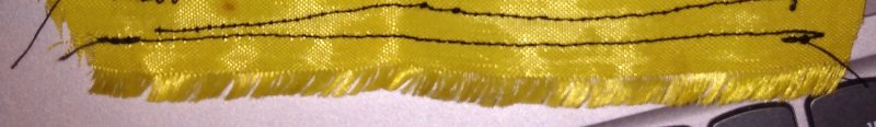

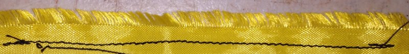

Here are some very useful things learned by watching Youtube on sewing machine use. Simple as holding the upper and lower tail threads taught slightly when starting a stitch. Otherwise loops of spaghetti are formed. Maybe jam. Maybe needle breaks.
The horizontal type top thread feeder, you should look to see which side the spool there is a thin notch cut that is there on many spools to hold the end of thread when storing away. You must face the notch away from the thread feed direction or else it can catch on it and jam up.
Thread spools have labels that are glued on and you should use an edge to clean completely the bits of paper and glue where you cut the paper label to reveal the hole for the spool feed post. Again, else it may jam
