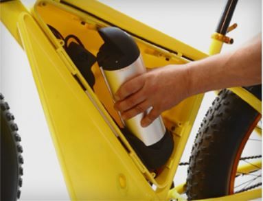

I'll show you what some of us have done with our bikes. Storm's come stock with a little 36v 8.8 amp hour bottle battery. That's a common size, and type of battery for a low end eBike. One of the biggest problems with a home built eBike is where to put the battery without ruining the bikes looks.
