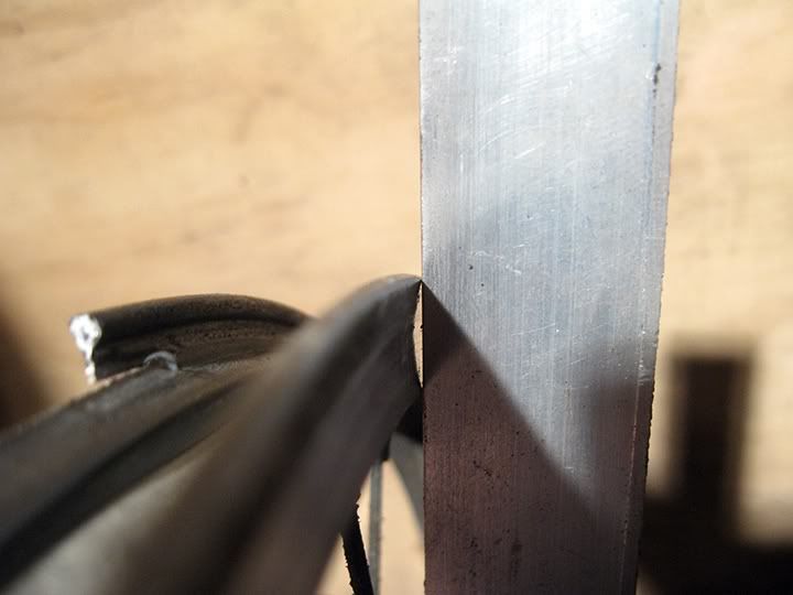

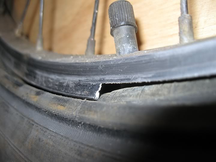

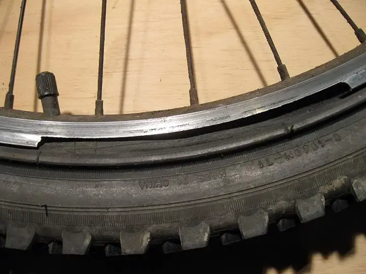

Much has been posted about brakes & some advise upgrading from coaster brakes to some type of rim brakes at least, to improve stopping power of course...
Thing is, I'm not that big a fan of rim brakes TBH - they don't work as well when wet, don't work at all in the ice & snow, they're a pain to keep adjusted properly and without a doubt have the worst wear rate of any type of braking system ('cept maybe sneakers lol) and by "wear rate" I'm not talkin' bout just the pads, while that can be made manageable with a decent set, it's the wear on the rims that's problematic - which is a far more costly & dangerous issue;
Yeppers, that's a six inch chunk missing outa the side of my rim. No, I didn't crash, but it was quite exciting there fer a few. I didn't crush it w/my brakes, all it took was a slight bump & the excess pressure blew the side wall across the road with a very impressive bang. I was lucky in a coupla ways, it just happened to be my rear rim & as I wasn't braking at the time and didn't try to brake the wheel that just had a blow-out - it didn't lock up on me & I just coasted to a stop, if a squirrely one.
Granted that's a crappy single wall alloy rim & I knew it was gettin' sketchy, even though that particular rim only has roughly 5000 miles on it - but even if it was a double wall I suspect it'd be well past it's safety margin & would need replacing, given how thin the side walls have become.
So... be warned. If you've rim brakes, or you're thinking about upgrading from a coaster brake and/or replacing the rims on your motorized bicycle, you may wish to consider spending just a little bit more and get a decent set of double wall rims with drum or disk brakes. If you can't or don't want to for w/e reason, remember to check your rims for wear periodically at least.
There's a reason why mopeds & whatnot don't use rim brakes & I think the above illustrates that quite well ;)

Good thread, excellent illustration and reminder! I like the flat edge refference point... Newer Chinese rims might be thinner!

I always wondered about that problemo, I havn't worn one down like that yet but i'll be keeping my eye on the rim wear.......great post and thanks.

A very good argument for disc brakes. For anyone who accrues high milage on a pedal or motorized bike, this is a warning of what is possible.
Good presentation, Geoff. I hope everyone reads it.

That is why we inspect our bikes frequently.
Good point. Anything that sees a lot of use will require maintenance. Keeping wheels true, rims surfaced and pads deglazed is just another part of routine maintenance for me. Rims wear as well, so replacement becomes part of that program.
Disc brake set-ups can be great but not all disc brakes are the same. I'd rather have well tuned linear pull or canti brakes with quality components on a decent bike than low quality disc on a cheap bike. You get what you pay for. Asymmetrical stress on rotor side fork blades creates torque steer and fatigue, as well as extra stress on rotor side spokes. Wheels should be dished and tensioned accordingly for it.

I never had that happen to any of my wheels. I had an MTB with alum wheels and centerpulls in the late 80's-90's that I put over 50k miles on and a cruiser with alum wheels and V-brakes I put over 30k on. Always used salmon Kool-Stop pads and kept things adjusted.
Lots of road salt in Maine, isn't there? :D

Ouch ! Actually looked at my rims today and they were good. Never seen anything like that before.

Well, a coupla folks have mentioned that with anything that sees a lot of use requires a greater amount of inspection & maintenance... obviously this is true and I agree, yet I'd like to suggest that anything that could reduce that amount of maintenance, thereby increasing reliability - is defo more than welcome in my book lol
I'll freely admit the usage this particular bike undergoes is brutal, it's my beater commuter after all - at least six days out of the week it's on the roads in any and all weather conditions at sustained "high" speeds (for a bicycle), riding on anything from clean dry asphalt, mucky trails or the wonderful ice and snow, a delightful mix of salty slush if I'm lucky.
...but that's my point - I've found the "normal" maintenance rim brakes require with the miles, speeds & conditions I ride excessive, surpassing any other component by a ridiculous margin. The only other component that comes close to needing nearly as much attention is the drive chain, and that's just a matter of the occasional adjustment & lube - not even tire wear comes close to the love the brakes constantly demand, only to reward that attention with questionable preformance when wet & failing me utterly when they're iced up.
It's so bad I often resign myself to simply not having brakes in the winter & riding accordingly... which honestly isn't something I would recommend to others or particularly appreciate - if I seem overtly negative, that could well be a factor lol
Is it a critical enough problem for the average rider that it's something they must do, converting their bike to another type of braking system? Not at all - with quality pads they're completely acceptable with good stopping distances & negligible wear, with recreational use in "ideal" conditions with the usual maintenance, even the rims should last just about forever. I posted this thread simply as a cautionary measure, that rim brakes do cause rim wear & it's something to keep an eye on. Pad drag from maladjusted tension springs, dirty and/or worn pads, any neglect will only compound this issue, as would the greater speeds, weight, heat, use and strain of a motorized bicycle application.
Yet by comparison, the Sturmey Archer drum brake hubs on my Rollfast have required no maintenance whatsoever, not even a glance or thought in the over four thousand miles I've had them - I squeeze the lever & they stop me w/o complaint or question, every time, even in a downpour. Granted, I don't ride that bike in the winter (it's shiny & I'd like to keep it that way lol) - but snow and ice don't effect drum brakes in any case. Sixty bucks to never hafta worry about braking or rim wear again may be something to consider.
Disc brakes, torque steer & asymmetrical stress on the forks? Conceivable yes, in practice I've found it's negligible to the point of being an academic curiosity at most - I've never felt anything even slightly noticeable on the disc setups I've ridden. It's true I've not tried the generic disc brakes on a wallyworld bike & with such low quality forks as they tend to come with that could be an issue - but in my opinion replacement forks should be considered if they're that flexy anyway... Forgive me, but I'm having trouble understanding how disc brakes could possibly put any "extra stress on rotor side spokes" as the rotor is connected directly to the hub & the hub is ofc connected to itself on both sides, being one piece & all... I could be wrong, but even so maladjusted rim brakes can flex the heck out of a rim & spokes, as does high speed cornering *shrug*
In any case "low quality disc" setups are simplicity itself to upgrade, provided you've the mounts ofc. An Avid BB5 caliper w/rotor & pads is a mere $36 - replacement pads 8-12 bucks, rotors 12-14... defo cheaper than replacing a worn out rim and they actually work in the rain heh
Run what ya like, but for myself & my riding habits I'll never buy another new bike equipped with rim brakes *shrug*
